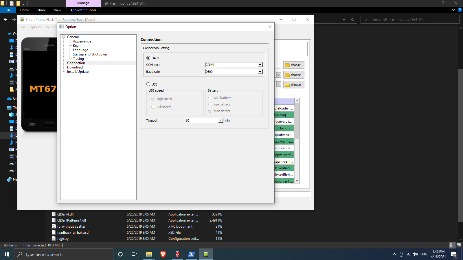

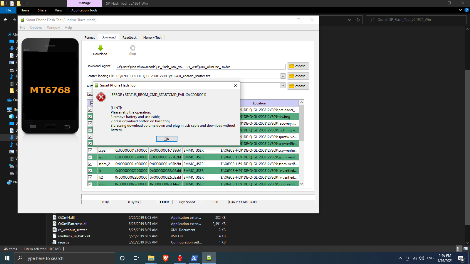

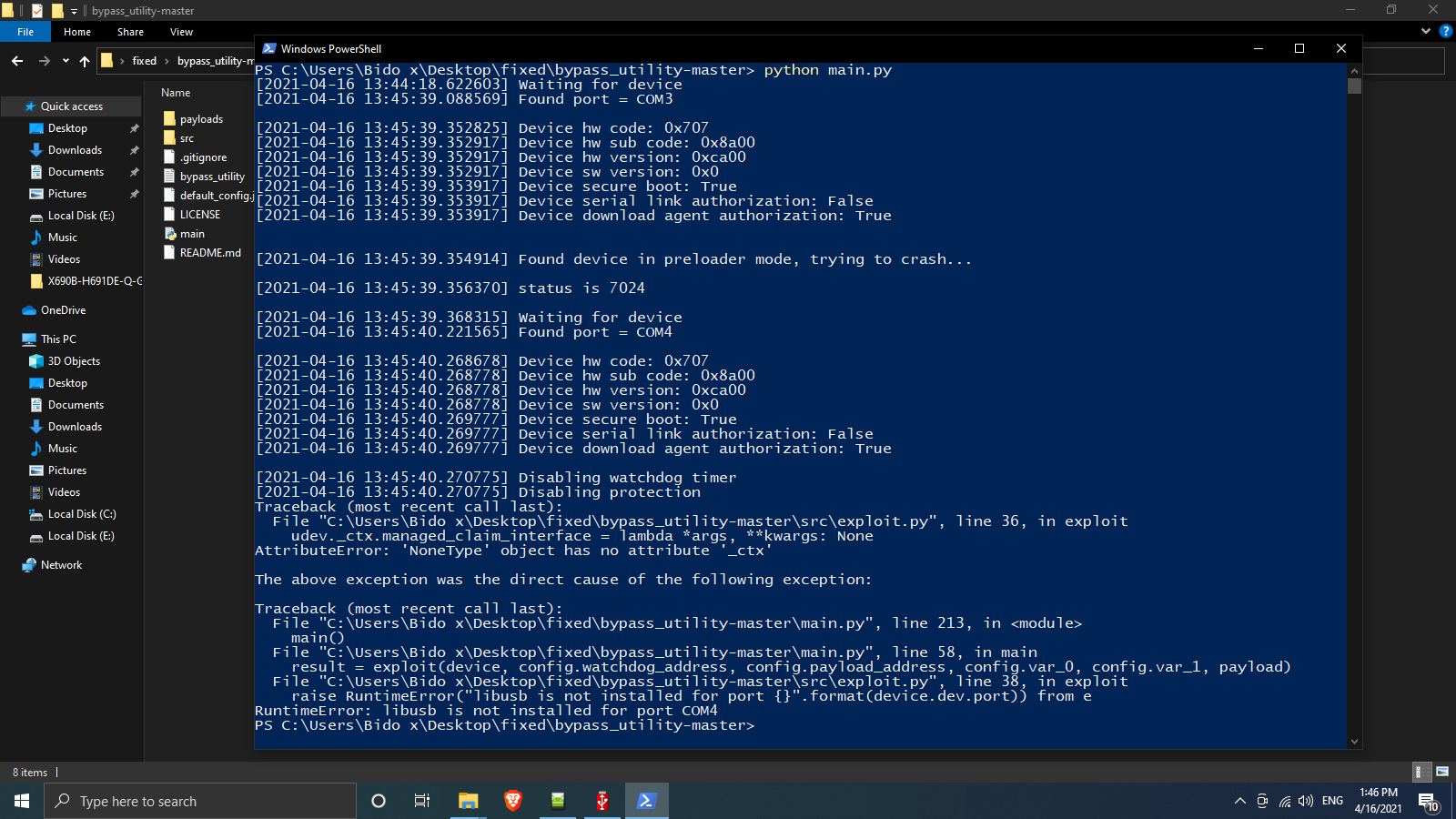

16-04-2021, 12:51 PM
(16-04-2021, 10:28 AM)X3non
(16-04-2021, 03:43 AM)Iılıl Bęđò Iılılı not working when im flashing boot and recovery tell me remove battry and restart
any other way to install stock?
when flashing your device needs to be power off (either wait till battery drains or disconnect / reconnect the battery or attempt to force the device into mtk usb port mode by holding the boot key + power key, when it goes off then release power key), follow the guide properly
whats wrong ?!
50,878
17-04-2021, 10:48 AM
(16-04-2021, 12:51 PM)Iılıl Bęđò Iılılı whats wrong ?!
you didn't install filter for mtk usb port. it's in the guide
