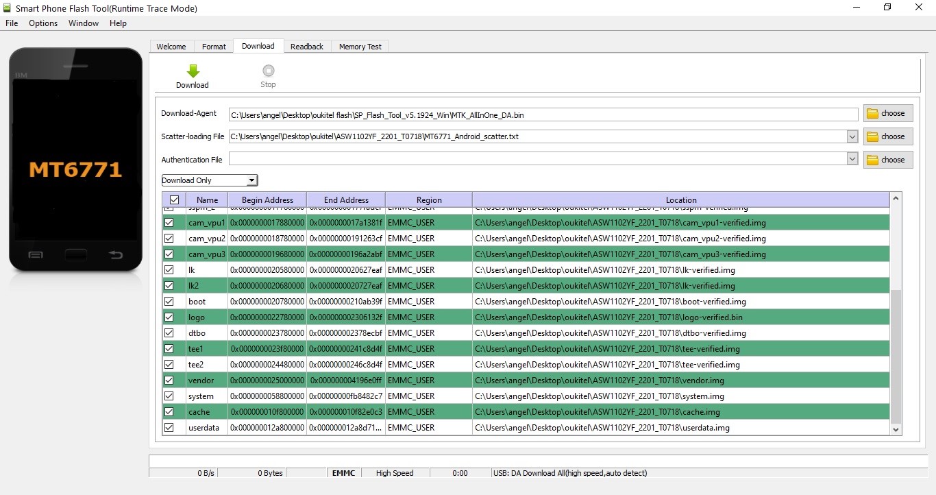

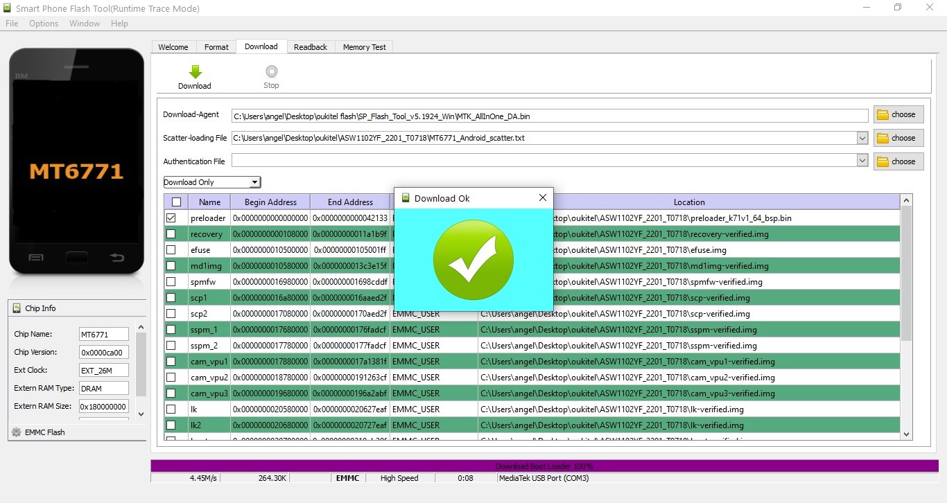

first thank you very much for you time.
i have 2 difrent firmwares with the same number ASW1102YF_2201_T0718 one with all the files( i think) and one with some files missing so i am uploading the screenshot of the one with all the files i wasn't sure if you ment a screenshot of the folder or on sp flash tool so i did both.
what i have done now is flashed the preloader perfect no problem then i started to flash one by one all the files first i will list the files that i flashed succesfully ( recovery, efuse, boot, vendor, system, cache, and userdata)
these are the rest of the files and they all gave the verified enable boot error ( md1.img, spmfw, scp1, scp2, sspm1, sspm2, cam_vpu1, cam_vpu2, cam_vpu3, ik, ik2, logo, dtbo, tee1 and tee2)
so at this point because i have been able to flash some files i don't want to touch anything and mess things up, i will look into the firmware dump i haven't had a chance to see the link you gave me but i will.

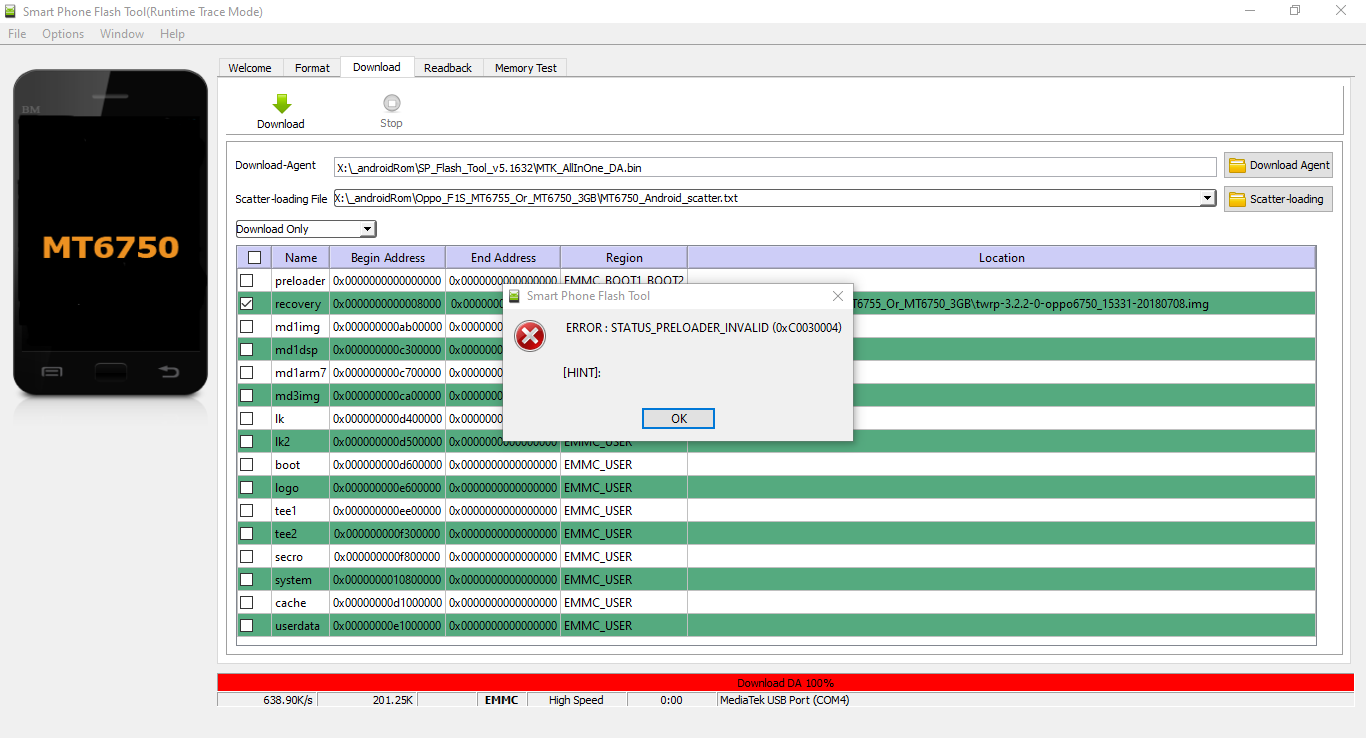

i did as you said and used the preloader file that i flashed previosly then went on with the backup so EMMC_BOOT1 backedup no problem PGPT backed up no problem but when i tried to back up EMMC_USER it starts ok but when on 4% it starts conecting on and off bleep ....bleep
it also gave me ( ERROR: STATUS_PRELOADER_INVALID (0xC0030004) the preloader file is invalid! please try another official load.)
so flashed preloader from firmware ASW1102YF_2201 T0735 instead of (ASW1102YF_2201_T0718)
flashed succesfully and started the whole procces again with Wwr tool and sp flash tool and the same story made empty scatter file backed up EMMC_BOOT1 and PGPT no problem but when i tried to back up EMMC_USER this time not even 4% it starts diconecting and conecting to the point that when i unplug usb from device the sp flash tool freezes not responding and have to close it.
i also tried to flash the firmware after backing up i tried with upgrade opcion and format all+ download but still gives me the ( ERROR: STATUS_SEC_PUBK_AUTH_MISMATCH_N (0xC002001B) verified boot is enabled. please download signed image (md1.img-verified.img) or disable verified boot.
is there any way to disable verified boot on a hard bricked device? or get around it?
