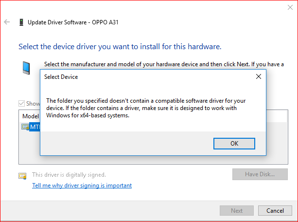

Ok so i was trying to root my phone (Oppo A31) and i have a fastboot problem and then i found this video
https://www.youtube.com/watch?v=1dYn31wdw-s
so i tried the steps in the video and then this message shows up
"The folder you specified doesn't contain a compatible software driver for your device. If the folder contains a driver, make sure it is designed to work with Windows for x64-based systems."
(Screenshot below)

04-03-2021, 05:21 AM
Oh right i forgot to mention
the usb drivers are from here:
https://developer.android.com/studio/run/win-usb
and i also followed this forum steps but it still didn't work
https://www.hovatek.com/forum/thread-17105.html

04-03-2021, 09:43 AM
(04-03-2021, 05:18 AM)Player Ok so i was trying to root my phone (Oppo A31) and i have a fastboot problem and then i found this video
(Screenshot below)
connect the phone while in fastboot mode, launch device manager and check, what does the device get detected as? attach a screenshot of device manager if possible
one more thing, what's the output of the command "adb --version" or "fastboot --version" ?

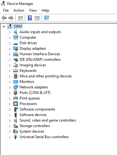

First of all sorry for my late answer i was having trouble finding this web and finding it on my email (because i cleared my email to increase my cloud storage)
second when i attach my phone to my pc while my phone is in Fastboot mode the device manager doesn't detects it

attach a screenshot of your device manager when you connect the phone to the pc while it's in fastboot mode

oh right forgot sorry
This post was last modified: 27-03-2021, 10:54 AM by Player.

29-03-2021, 09:58 AM
(27-03-2021, 10:54 AM)Player oh right forgot sorry
are you sure the device is in fastboot mode? there should be a fastboot inscription displayed on the screen
if yes, then try a different USB cable or PC
