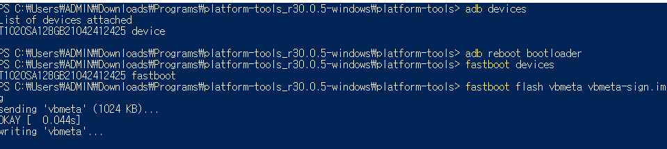

I looked up a lot of guides for rooting the iplay 40.
Finally, we succeeded in creating vbmeta-sign-custom.img.
But it doesn't work in fastboot
No response from writing
My device works normally when I boot after removing the cable
Sorry for asking so many questions. Thanks for your guide.

post the info_image output of your stock vbmeta and also post the command you used to create the new vbmeta
