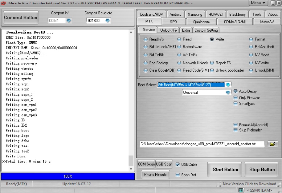

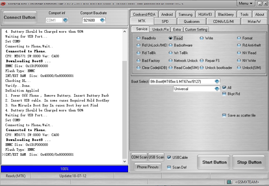

Doogee S88 Pro. Error 0xC002002A after try to flash stock rom. Please help.

Nothing happen with Miracle thunder.

Now i can flash rom with miracle box but it still continous bootloop. And got error "bad state Your device has failed verification and may not work properly"
How can i fix this problem? and i can not get into fastboot, recovery mode and can not power off the device.
Thankyou in advance.
