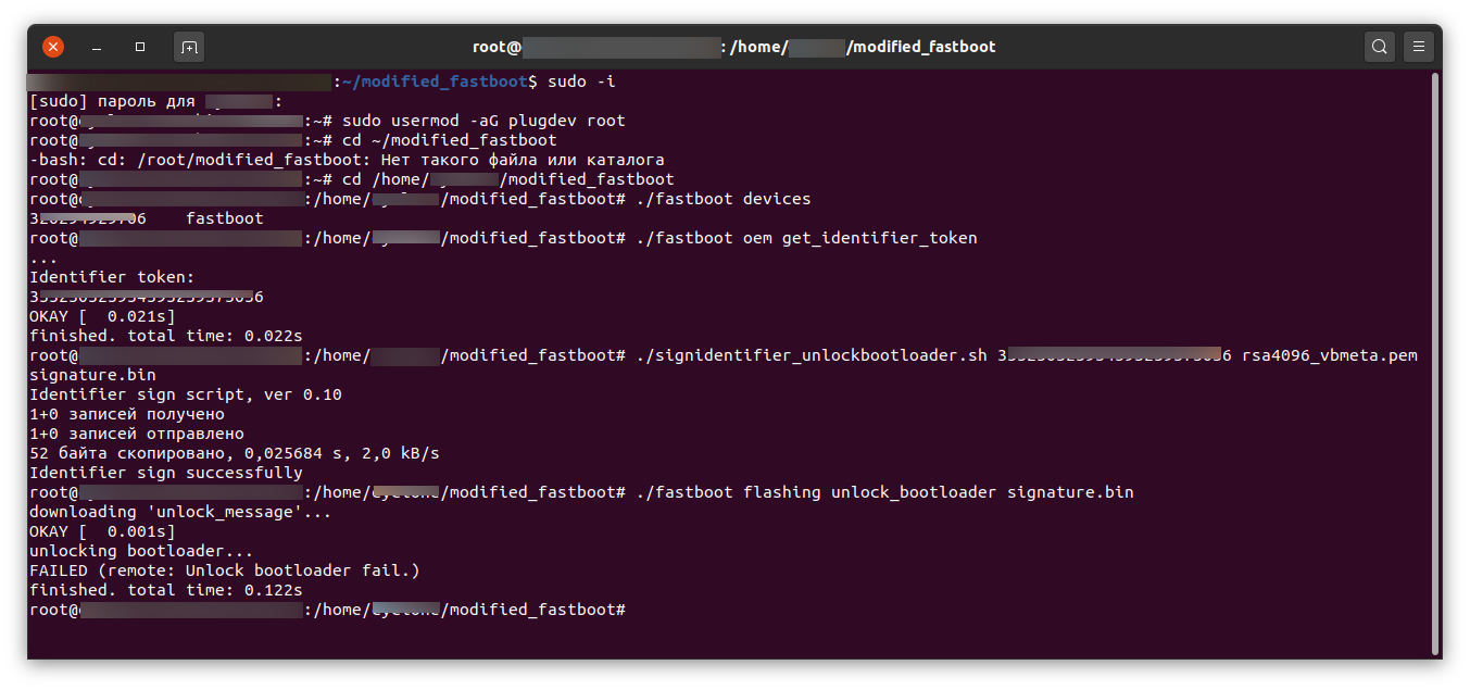

hi, i need help plz
tried to unlock my bootloader with this -> https://www.hovatek.com/forum/thread-32287.html
and get this ->
Identifier token:
33323033393634383731XXXXX
OKAY [ 0.020s]
finished. total time: 0.020s
Identifier sign script, ver 0.10
1+0 Datensätze ein
1+0 Datensätze aus
52 Bytes kopiert, 0,000447325 s, 116 kB/s
Identifier sign successfully
downloading 'unlock_message'...
OKAY [ 0.000s]
unlocking bootloader...
FAILED (remote: Unlock bootloader fail.)
finished. total time: 0.126s
whats the problem?

you're not alone dude im facing that issue too, did ya have a try to reboot bootloader again before flashing signature.bin?
only last thing before unlocking make me crazy.

your device most likely uses a different private rsa key that the one used in our guide
you can try to reach out to your device oem (see if they're that generous to provide the key)

the file rsa4096_vbmeta.pem is a private rsa 4096 key
without the right private key used by your device oem, you will not be able to unlock bootloader and for most new spd / unisoc devices the key now varies. it's no longer the same key for all devices
can you check your vbmeta? using the guide @ https://www.hovatek.com/forum/thread-32666.html then post the result here

I have the same problem. can i read the private key from the firmware or can I only get it from the manufacturer? I have a Wiko Y80

you can't read the private key from the firmware
either you get from the manufacturer or you happen to luckily find it lying around somewhere on the internet

Minimum libavb version: 1.0 Header Block: 256 bytes Authentication Block: 576 bytes Auxiliary Block: 13504 bytes Algorithm: SHA256_RSA4096 Rollback Index: 1 Flags: 0 Release String: 'avbtool 1.1.0' Descriptors: Chain Partition descriptor: Partition Name: boot Rollback Index Location: 1 Public key (sha1): 3d2079902c9bf9825c66a513a7eb06f8d1a0df1d Chain Partition descriptor: Partition Name: system Rollback Index Location: 3 Public key (sha1): 94d19fe32bc84187a9bcc76f94160c68521f15d8 Chain Partition descriptor: Partition Name: vendor Rollback Index Location: 4 Public key (sha1): 765d1f6b50a79692fcbdab164aa5dfd2ae637bab Chain Partition descriptor: Partition Name: product Rollback Index Location: 10 Public key (sha1): 1c39b0d67cc2fc3993f06728e8a10b2083c50220 Chain Partition descriptor: Partition Name: dtbo Rollback Index Location: 9 Public key (sha1): 3d2079902c9bf9825c66a513a7eb06f8d1a0df1d Chain Partition descriptor: Partition Name: recovery Rollback Index Location: 2 Public key (sha1): 5ff5f20a5ba24c9c7a3b9862e5bdcc40d8505157 Chain Partition descriptor: Partition Name: l_modem Rollback Index Location: 5 Public key (sha1): e2b445caaea247aafc6c415c5ad0509916472a47 Chain Partition descriptor: Partition Name: l_ldsp Rollback Index Location: 6 Public key (sha1): e2b445caaea247aafc6c415c5ad0509916472a47 Chain Partition descriptor: Partition Name: l_gdsp Rollback Index Location: 7 Public key (sha1): e2b445caaea247aafc6c415c5ad0509916472a47 Chain Partition descriptor: Partition Name: pm_sys Rollback Index Location: 8 Public key (sha1): e2b445caaea247aafc6c415c5ad0509916472a47 Chain Partition descriptor: Partition Name: dtb Rollback Index Location: 11 Public key (sha1): 3d2079902c9bf9825c66a513a7eb06f8d1a0df1d
please, HELP!
