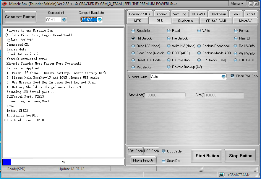

thanks for the reply i have tried doing it with spd before. but i got an error code: bootload error id: 8
i dont know if it because i used auto in the type section

(02-07-2020, 08:34 PM)osas2luv i dont know if it because i used auto in the type section[/size]
go through @freshtyt's reply @ https://www.hovatek.com/forum/thread-355...#pid196899 for the proper boot to attempt using
