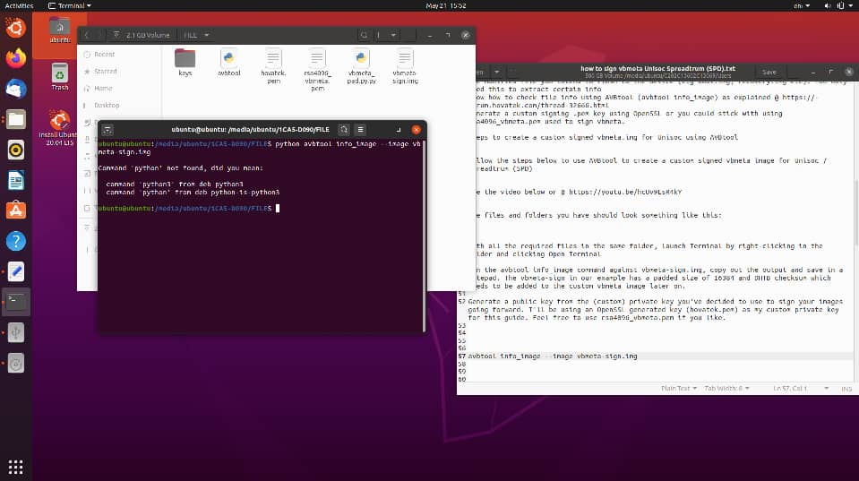

Sir please I need you to help me. I am trying to sign a custom Vbmeta . This is the screenshot of the response I got from Terminal. thanks

(25-05-2020, 07:25 PM)Organicsprotection Sir please I need you to help me. I am trying to sign a custom Vbmeta . This is the screenshot of the response I got from Terminal. thanks
are you running ubuntu 20.x?
install python2 using the command below
sudo apt install python2
if it requires updating the repo then run the command below before the python installation command
sudo apt update
