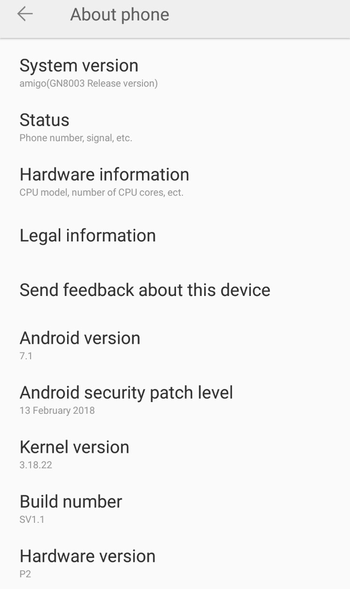

Hi hovatek, please I need help rooting my Gionee M6(Android 7.1). I have unlocked the bootloader but I don't know what to do next.

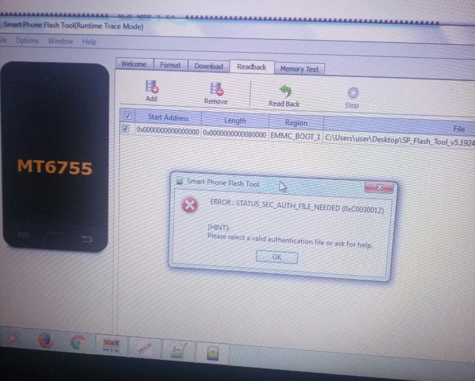

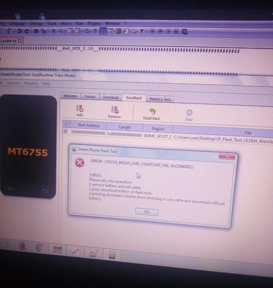

These were the response I got when I wanted to do a readback of the preloaded on SP Flashtool

The above were the responses I got. Please what should I do?

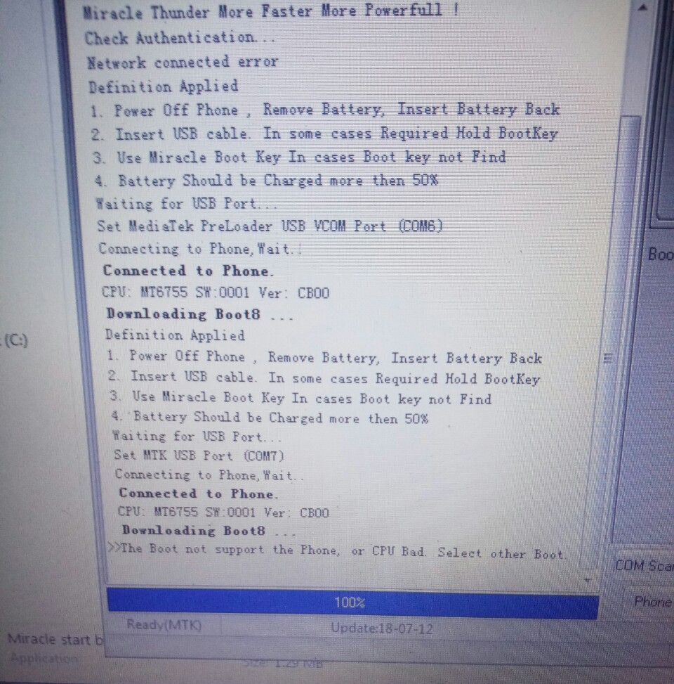

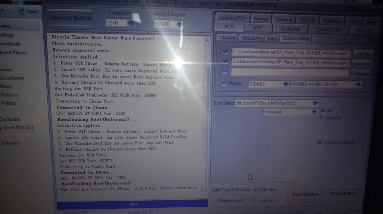

use miracle box method is simple

Please do I need any hardware to use Miracle box? Because I don't have any

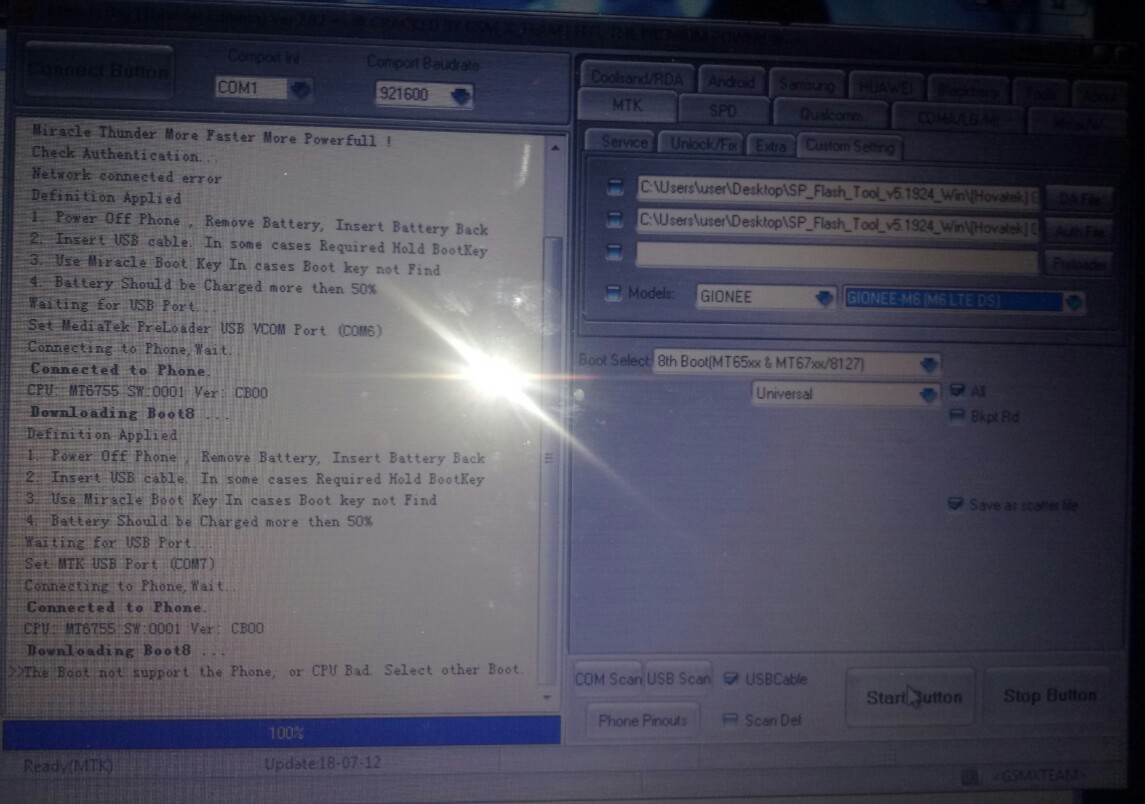

Download miracle thunder 2.82 @ https://www.hovatek.com/forum/thread-15700.html (works without a dongle)
Follow the guide @ https://www.hovatek.com/forum/thread-13347.html to backup firmware

you'll still need a DA file regardless of whichever method you're using
download DA file for your model @ https://www.hovatek.com/forum/thread-27159.html
