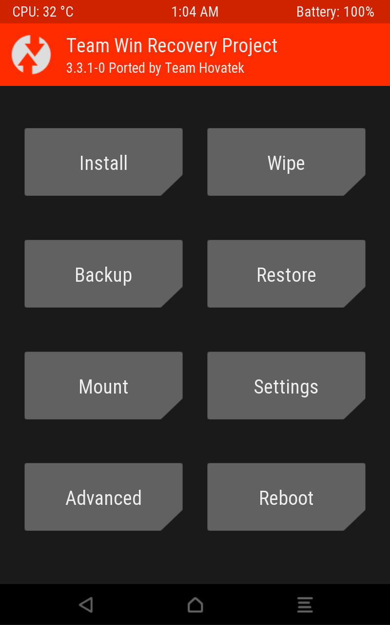

The Teclast P80X is a Unisoc / Spreadtrum (SPD) Android device running on Android 9 (Pie) and powered by Unisoc SC9863A chipset .
Here's v3.3.1 TWRP for Teclast P80X @ https://mega.nz/#!leIXUCwI!tgUdqdCISFDox...O4_6xG6J4k

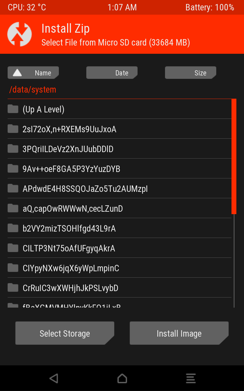

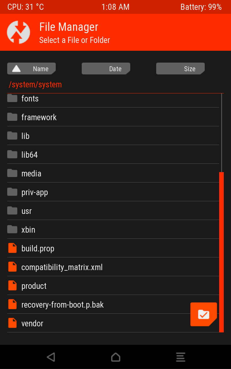

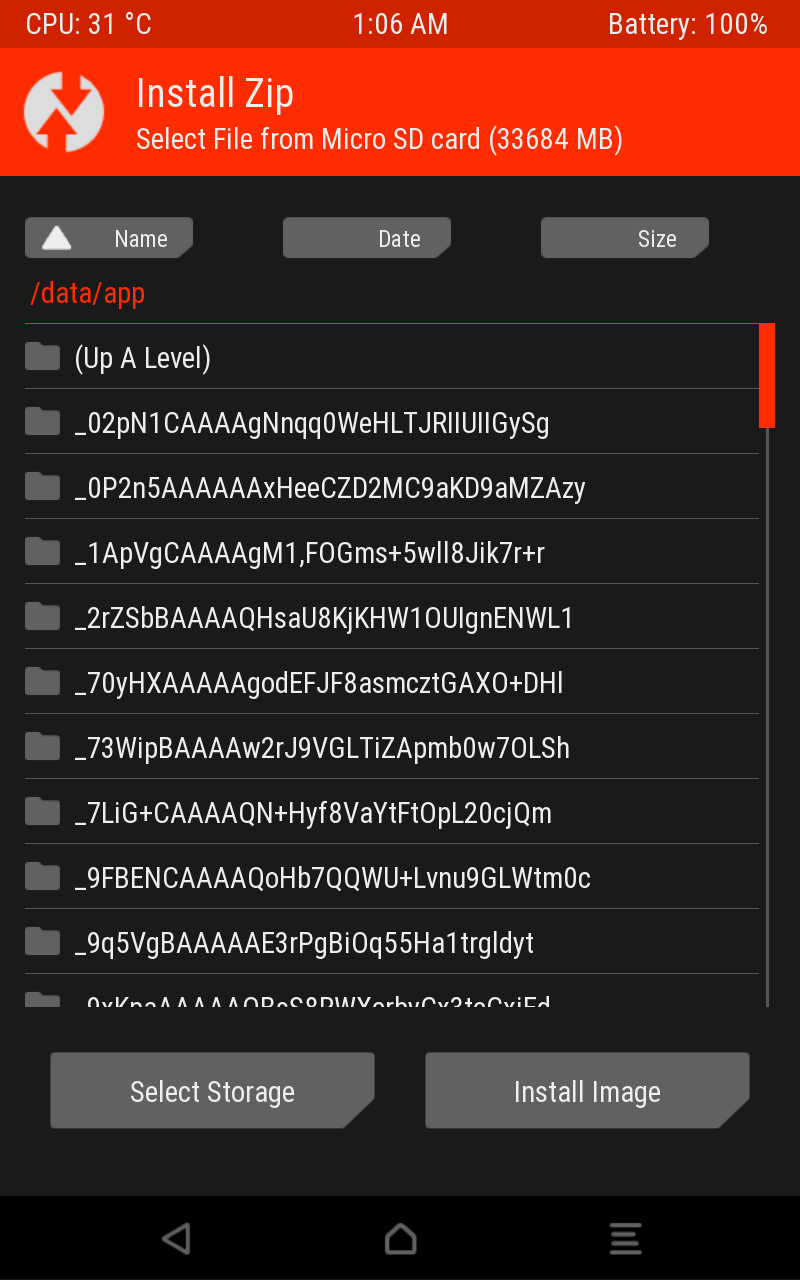

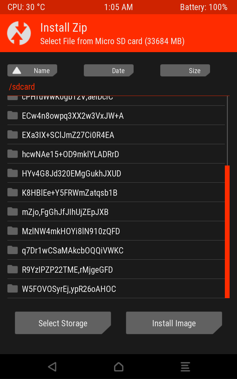

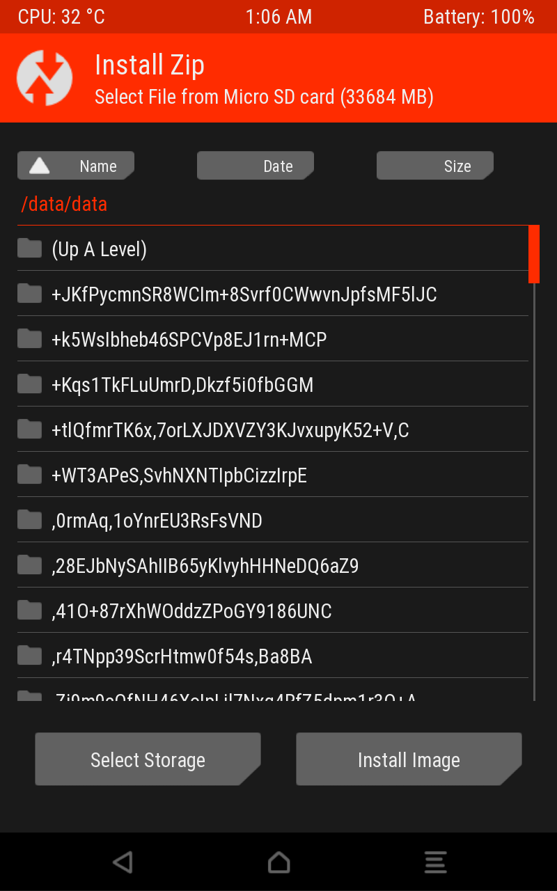

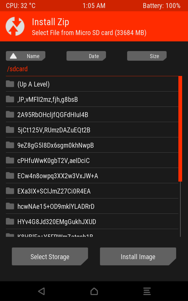

23-03-2020, 11:24 AM
Tried both your new TWRP v3.3.1 release and TWRP v1.4 porter generated recovery.
They needed to be signed for vbmeta signature checking but both variant where able to launch on the device.
This time, the SD Card can be mounted and every files and folders are accessible.

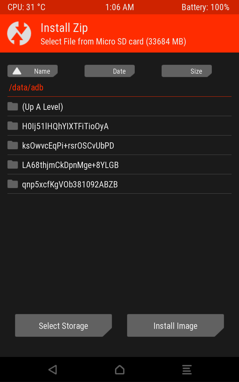

The internal storage access (/sdcard) gives same scrambled result as before.
I also tried to check the content of data partition (/data) and I can see the name of the file and folders that are just under it, but when I browse each of these folders, the same scrambled folder and filename appear, as in previous Internal Storage browsing.

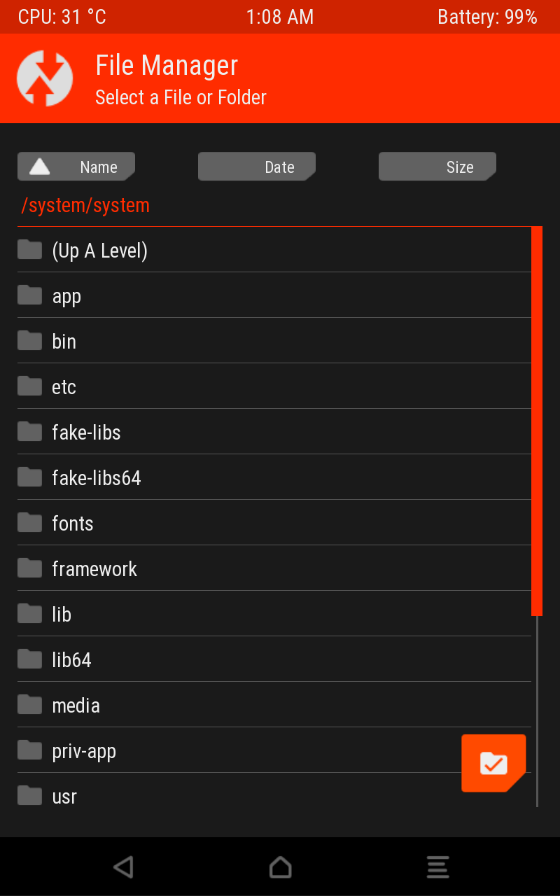

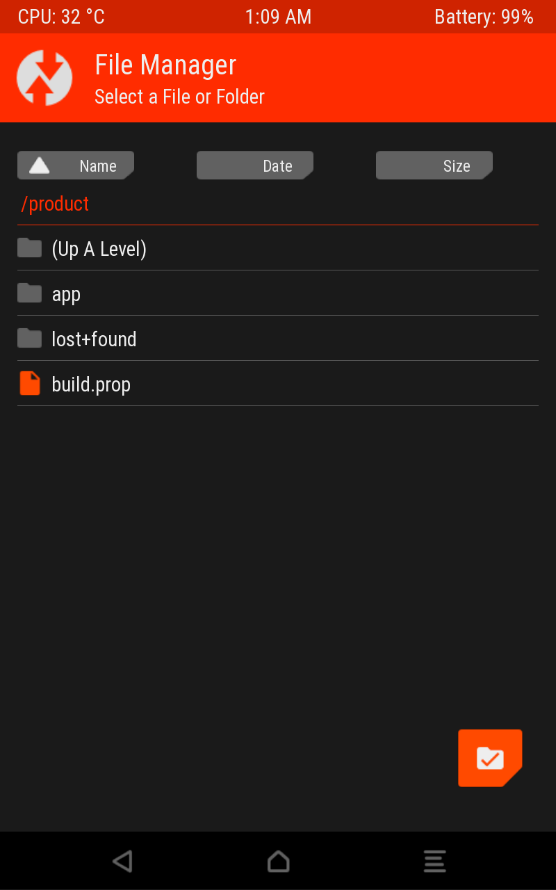

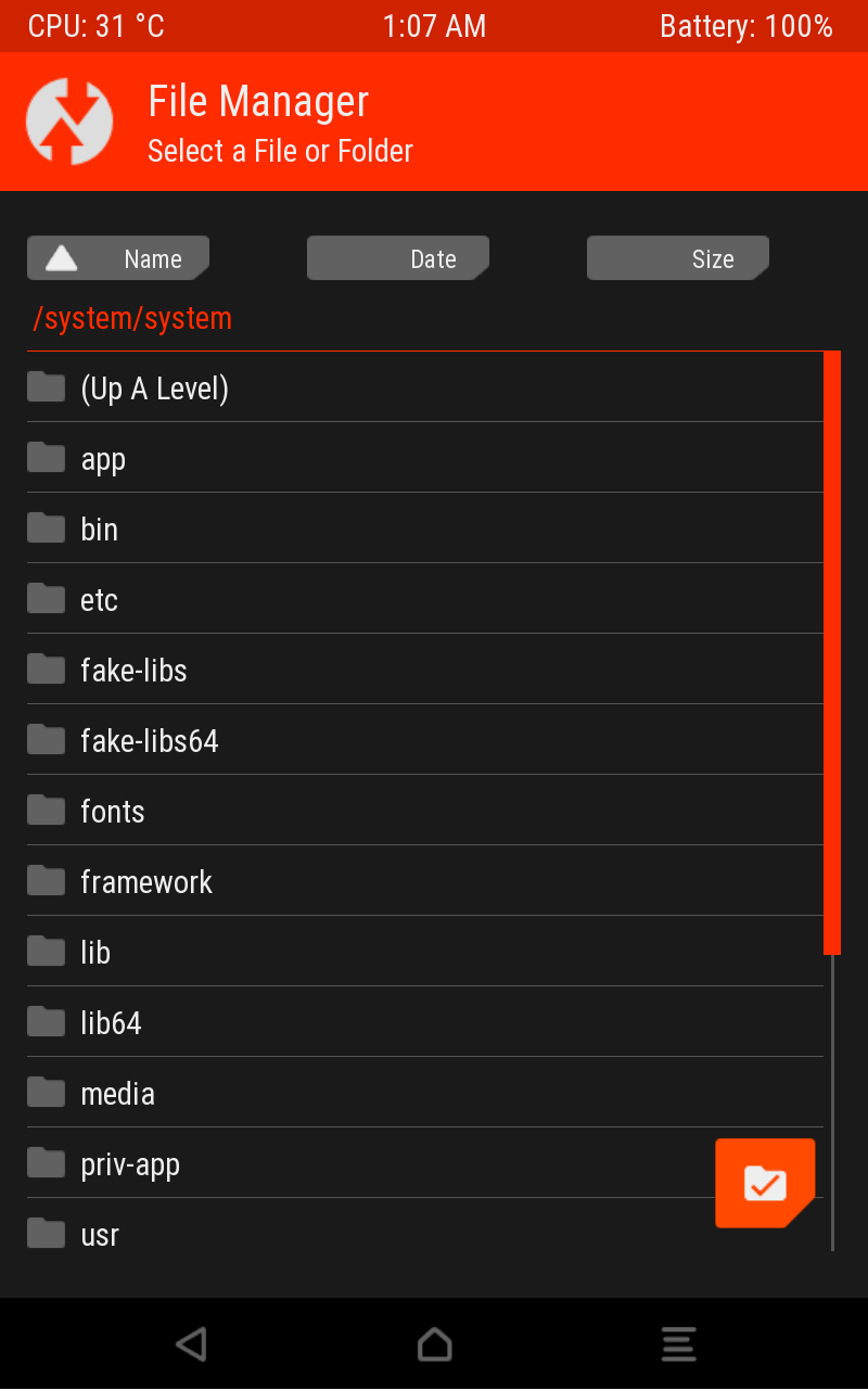

Other partitions seems OK, because I'm able to mount the system (/system), product (/product) and vendor (/vendor) partition and explore them without problem.
I'm sure of that because I've made manual modification in the /system/app and system/priv-app folders that I'm able to see from TWRP file manager.
However when mounted, the access path is /system/system and not /system as I'm used to see in other devices, but it's maybe due to the system_as_root partition layout you described in the P80X Root procedure topic.
What do you think?
Do you have an idea why the internal storage and data partition doesn't looks as it should under TWRP interface?
For information my device is not encrypted.
Thank you very much for your kind help.

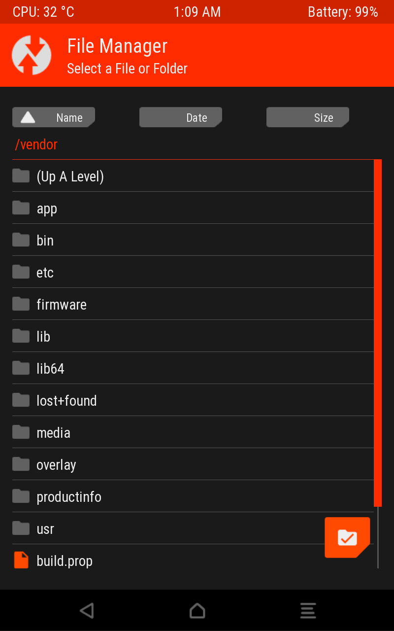

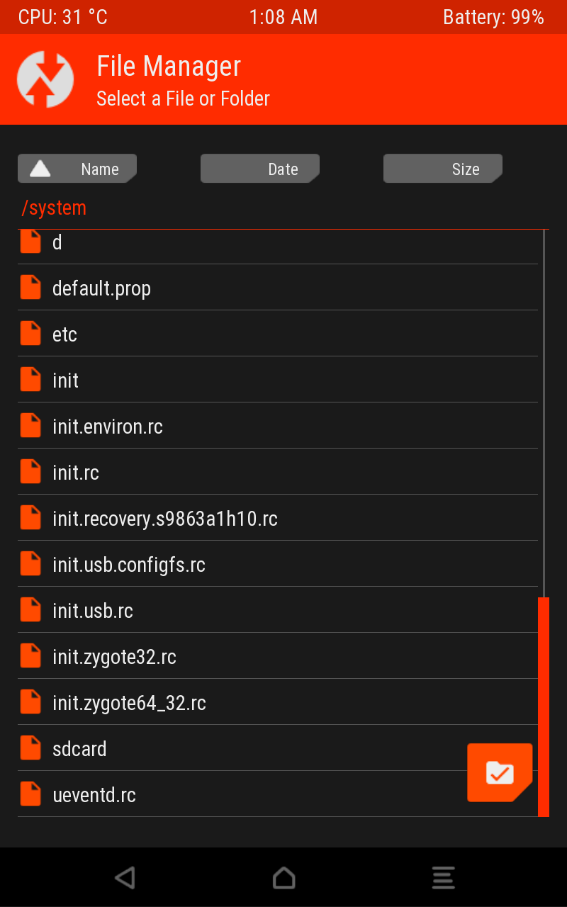

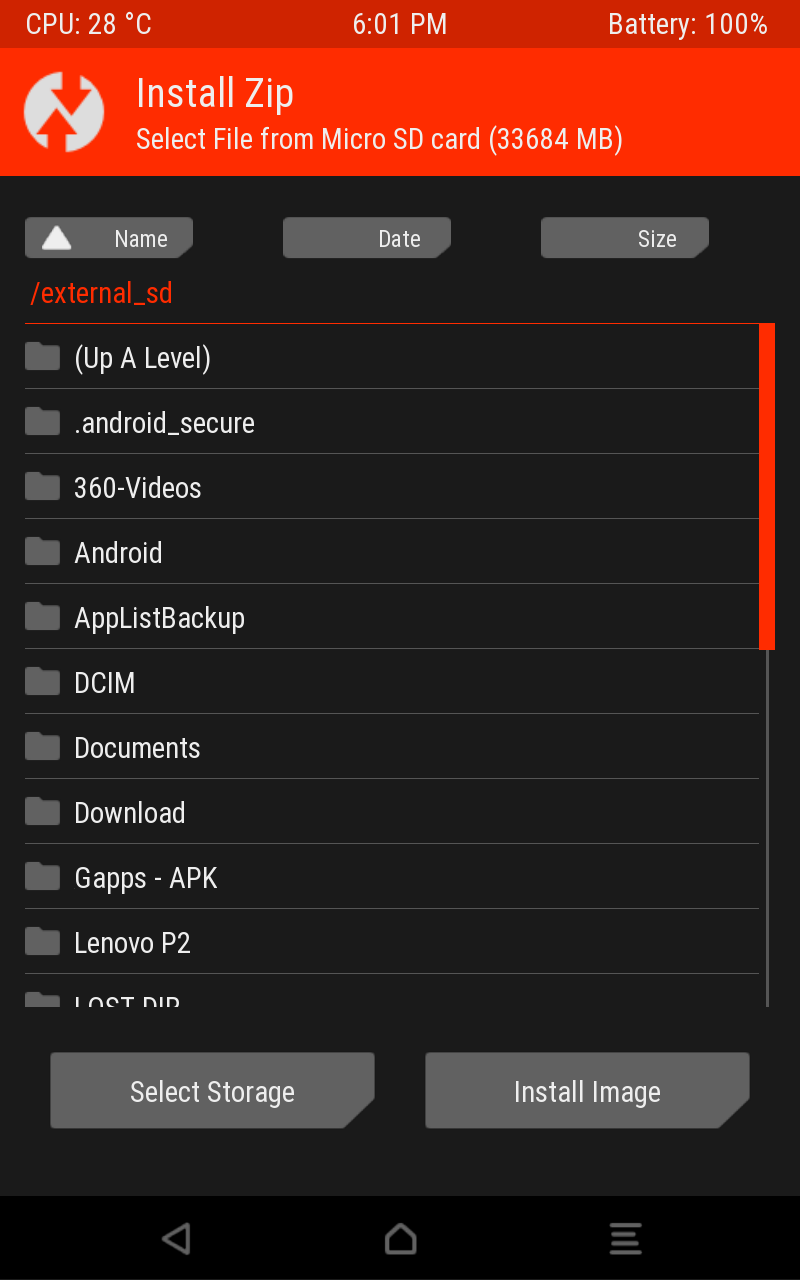

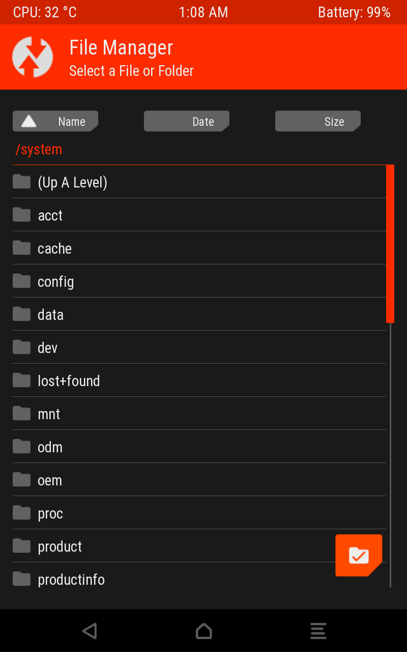

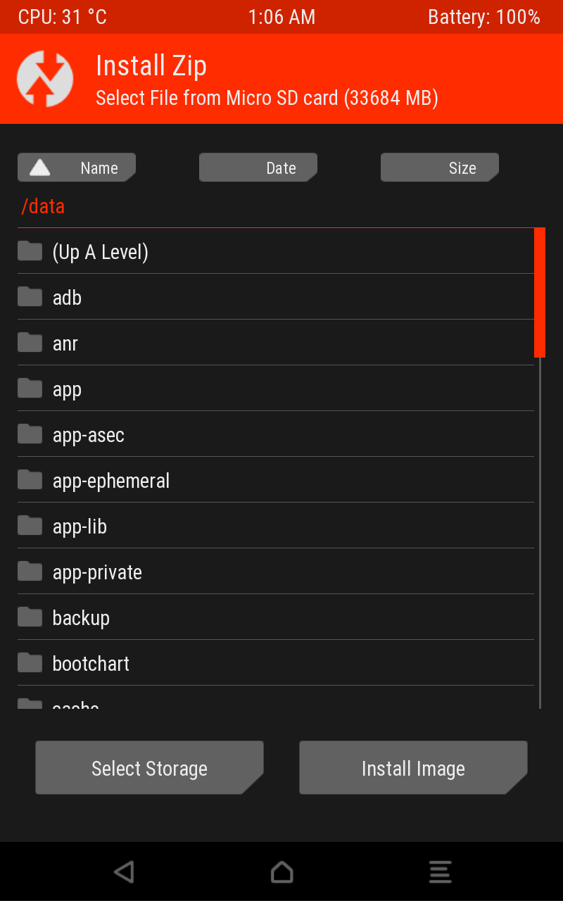

Can you send a screenshot of what you see so I compare to mine

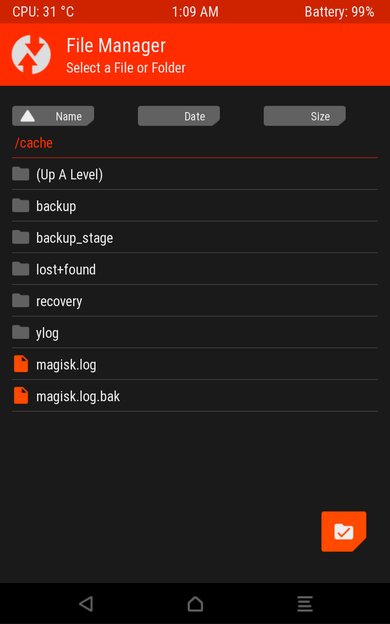

24-03-2020, 09:39 AM
Sure,
Please see the screenshot attached in this post.
This post was last modified: 24-03-2020, 09:40 AM by djelloul.

20-04-2020, 05:04 PM
(24-03-2020, 09:39 AM)djelloul Sure,
have you tried decrypting data? see https://www.hovatek.com/forum/thread-30160.html
