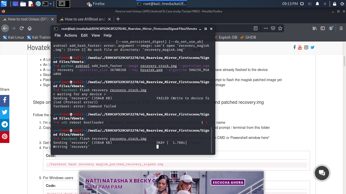

I think I'm going to give up. I spent about a week to achieve the previous steps that the tutorial says to follow, I get everything without errors. Then I flash the signed vbmeta file and the process ends successfully. I sign the recovery and boot file (both patched with magisk from the stock version? I sign the same but they are not flashed to the equipment, the process remains as the attached photo. The command is sent but it is never flashed. The device is a rear view mirror android which came with a SOC SC9832E

(25-06-2021, 01:23 AM)pindonga123 I think I'm going to give up. I spent about a week to achieve the previous steps that the tutorial says to follow, I get everything without errors. Then I flash the signed vbmeta file and the process ends successfully. I sign the recovery and boot file (both patched with magisk from the stock version? I sign the same but they are not flashed to the equipment, the process remains as the attached photo. The command is sent but it is never flashed. The device is a rear view mirror android which came with a SOC SC9832E
create a new thread for this by clicking "ask question" at the top
in this thread, post details about what you've done, e.g info_image from your stock vbmeta, command you used to create custom vbmeta, e.t.c also include the android version
