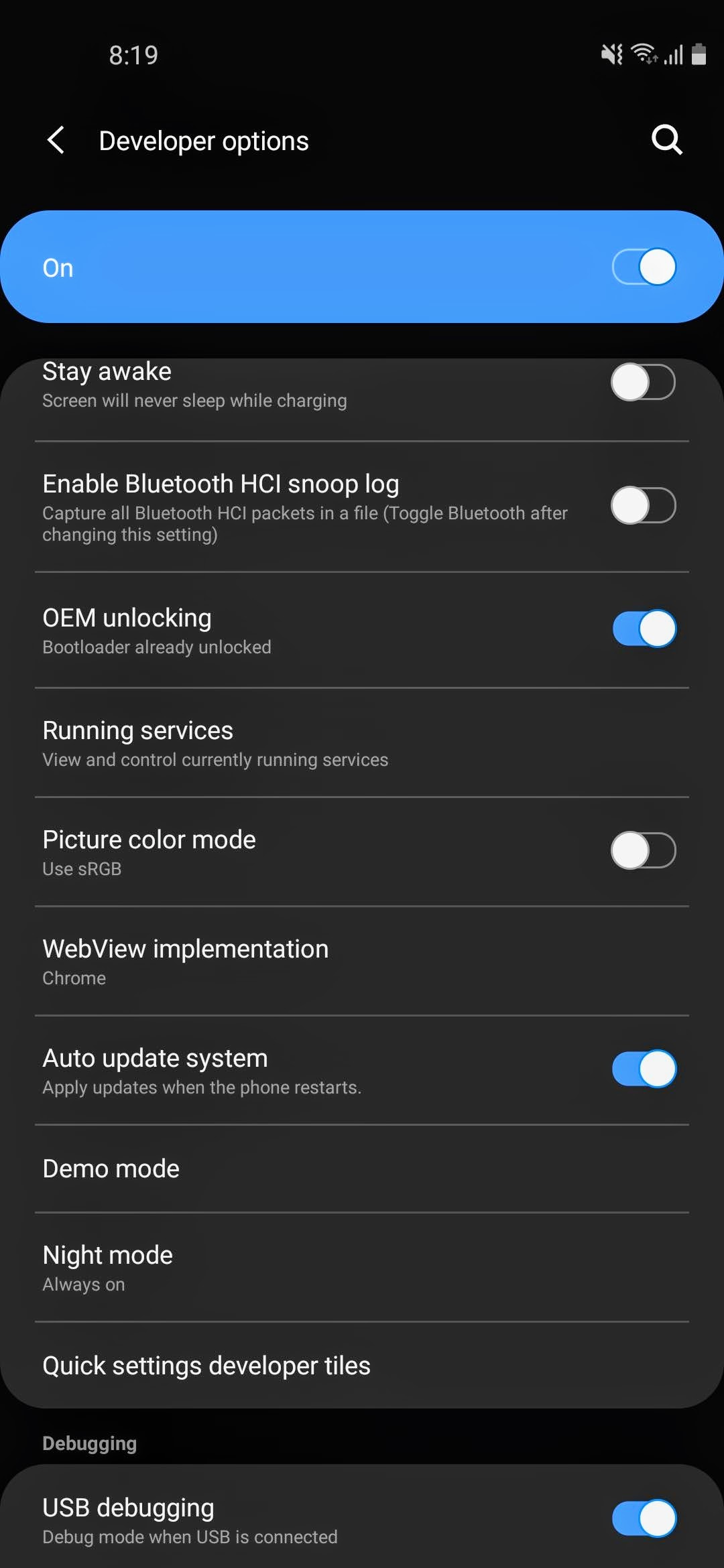

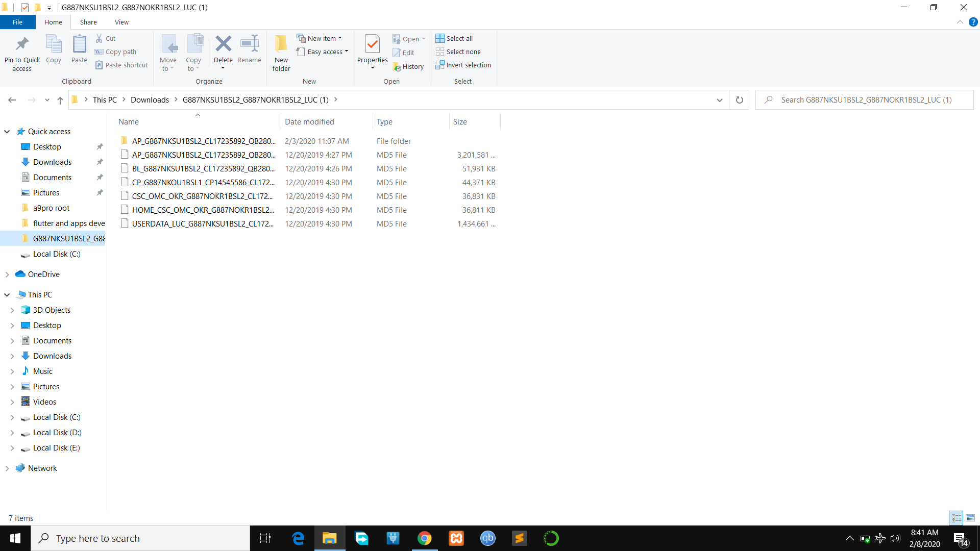

07-02-2020, 09:39 AM
(07-02-2020, 03:33 AM)Amrit Prasad Phuyal My boot loader is already unlocked

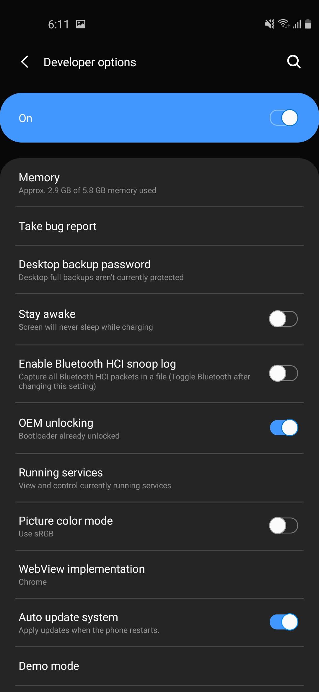

in your firmware, is there a vbmeta file? attach a full screenshot of the contents of your firmware
what's the android version of the phone, android 9?
is oem unlocking in developer settings enabled and the checkbox uncheckable?
This post was last modified: 07-02-2020, 09:48 AM by X3non.

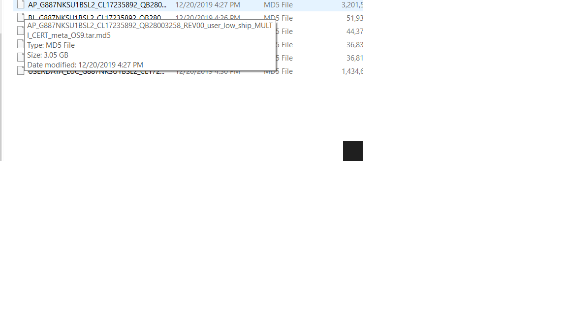

07-02-2020, 01:38 PM
 no vbmeta is not present in any files.
yes its android 9
yes oem unlocking in developer is enabled and its checkable.. i can enable and disable it.
This post was last modified: 07-02-2020, 01:40 PM by Amrit Prasad Phuyal.

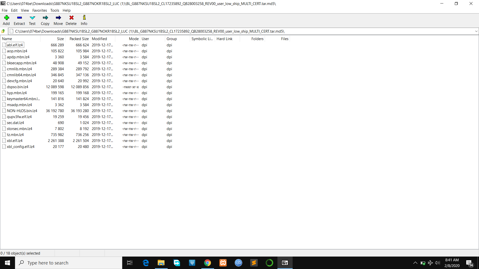

07-02-2020, 06:07 PM
(07-02-2020, 01:38 PM)Amrit Prasad Phuyal  no vbmeta is not present in any files.
yes its android 9
open each one of the tar archives using 7zip software esp the AP file and check if vbmeta exists (next time, wait until the mouse tooltip isn't blocking the view before taking the screenshot)

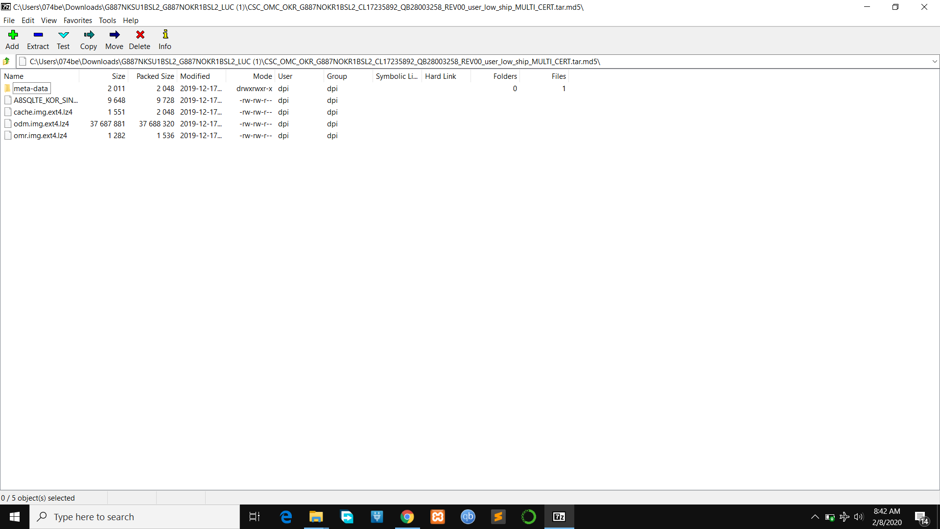

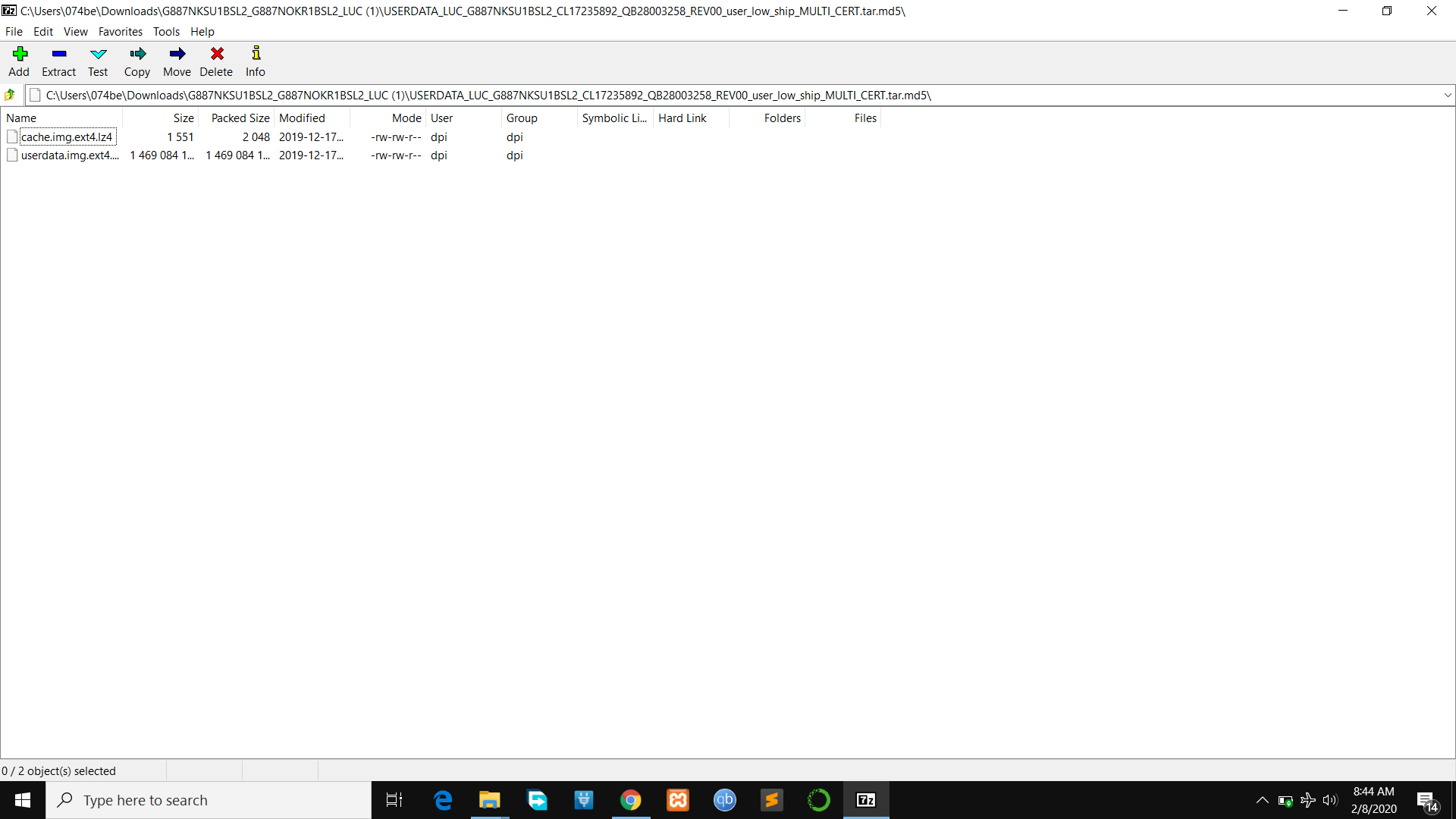

08-02-2020, 04:00 AM
[attachment=7493
X3non pid='186698' dateline='1581095220']
yes its android 9
50,891

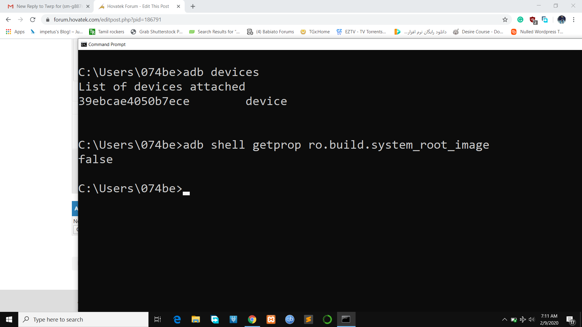

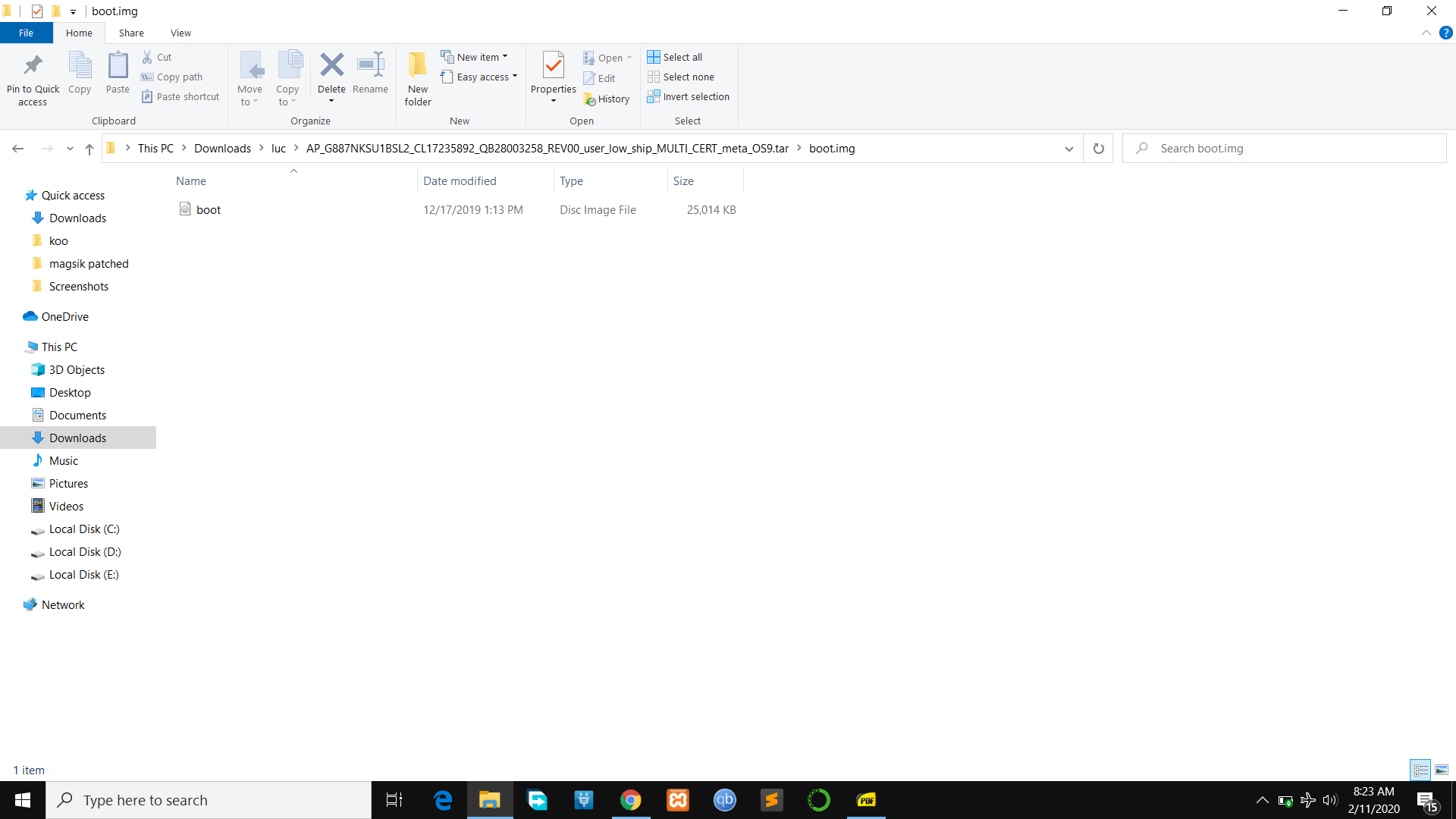

08-02-2020, 05:51 PM
(08-02-2020, 04:00 AM)Amrit Prasad Phuyal ...
No vbmeta
reconfirm that your bootloader is still unlocked if not the repeat the bootloader unlock
run the command below in adb window
adb shell getprop ro.build.system_root_image
if the output of the above command is true, then use magisk manager to patch the AP file in your firmware (don't extract the boot.img, just select the entire AP file)
>flash the output patched file (if you're using odin, untick the auto reboot option)
>press power button + vol down to exit odin mode on the phone
>immediately the screen goes off, quickly press the keys to boot your device into recovery mode (you should know the right key combination for your device)
>in recovery mode, select factory reset data then select reboot system
>immediately press the key combination to boot to recovery mode again but this time, once you see the bootlogo, release all keys
>allow the device to boot (it'll take some time so wait patiently)
>if all goes well then you should see initial setup, setup the device and install magisk manager apk then launch it and confirm that magisk is installed
