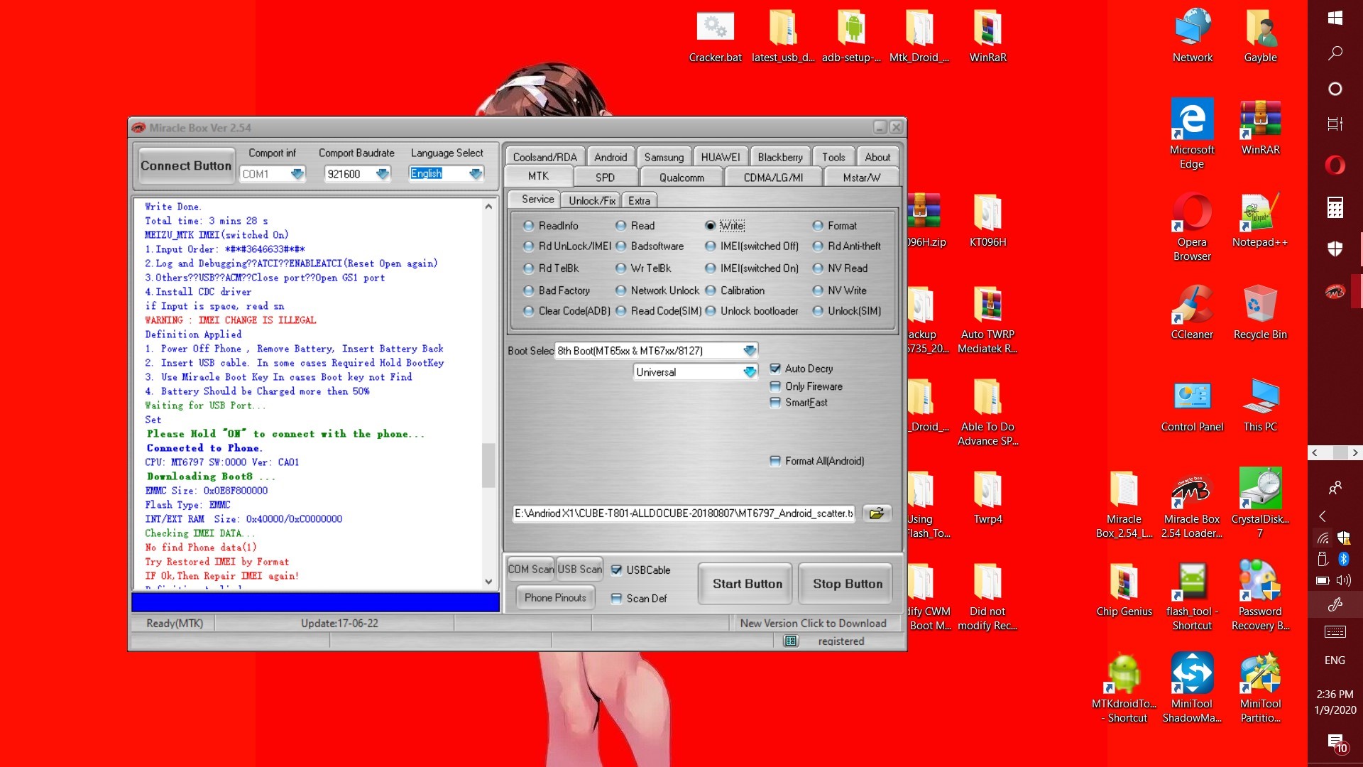

My device model : alldocube X1 T801 android 7.1
1) I have try miracle version v2.52 and v2.82 still unable to restore IMEI tbe some messages appear
2) can you please help me on this issue i use miracle to restore my IMEI but i get this message please see the
3) Can i know what to do next to resolve this problem
Or do you have other methods to restore IMEI on mtk6797

10-01-2020, 11:14 AM
(10-01-2020, 06:17 AM)gayble My device model : alldocube X1 T801 android 7.1
both your screenshots show you trying to flash firmware rather than write imei ; follow the procedure @ https://www.hovatek.com/forum/thread-26815.html
OR try other methods listed @ https://www.hovatek.com/forum/thread-116.html
BTW does this phone have a valid baseband?

10-01-2020, 12:48 PM
1) just two days ago i have successfully flash the IMEI on this model before, but now i try to flash it away give me this message ((This is what is keep showing
" Flash Type: EMMC
INT/EXT RAM Size: 0x40000/0x80000000
Checking IMEI DATA...
No find Phone data(1)
Try Restored IMEI by Format
IF Ok,Then Repair IMEI again!
Definition Applied"))
2) can i know what is mean how to ((Ensure your phone has a valid Baseband (Settings > About > Baseband). Reflash the firmware if it's unknown))
3) how to do this setting (Settings > About > Baseband)
4) how to restore IMEI by ( Restored IMEI by Format)
This post was last modified: 10-01-2020, 12:54 PM by gayble.

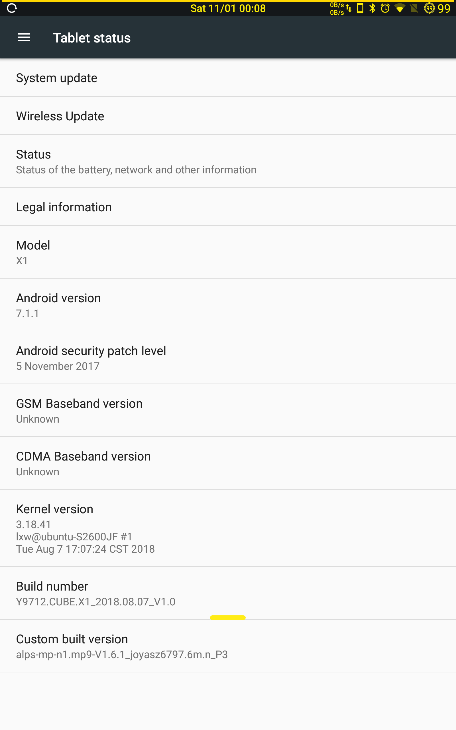

10-01-2020, 05:12 PM
I go to the system or about it show GSM and CDMA unknown
Please see the attached pictures
This post was last modified: 10-01-2020, 05:13 PM by gayble.
10,418
10-01-2020, 06:32 PM
(10-01-2020, 05:12 PM)gayble I go to the system or about it show GSM and CDMA unknown
you need to fix it first then write IMEI afterwards.
Seems like you’re using a custom ROM. Do you have the phone’s stock ROM? If yes, flash secro to fix unknown baseband.

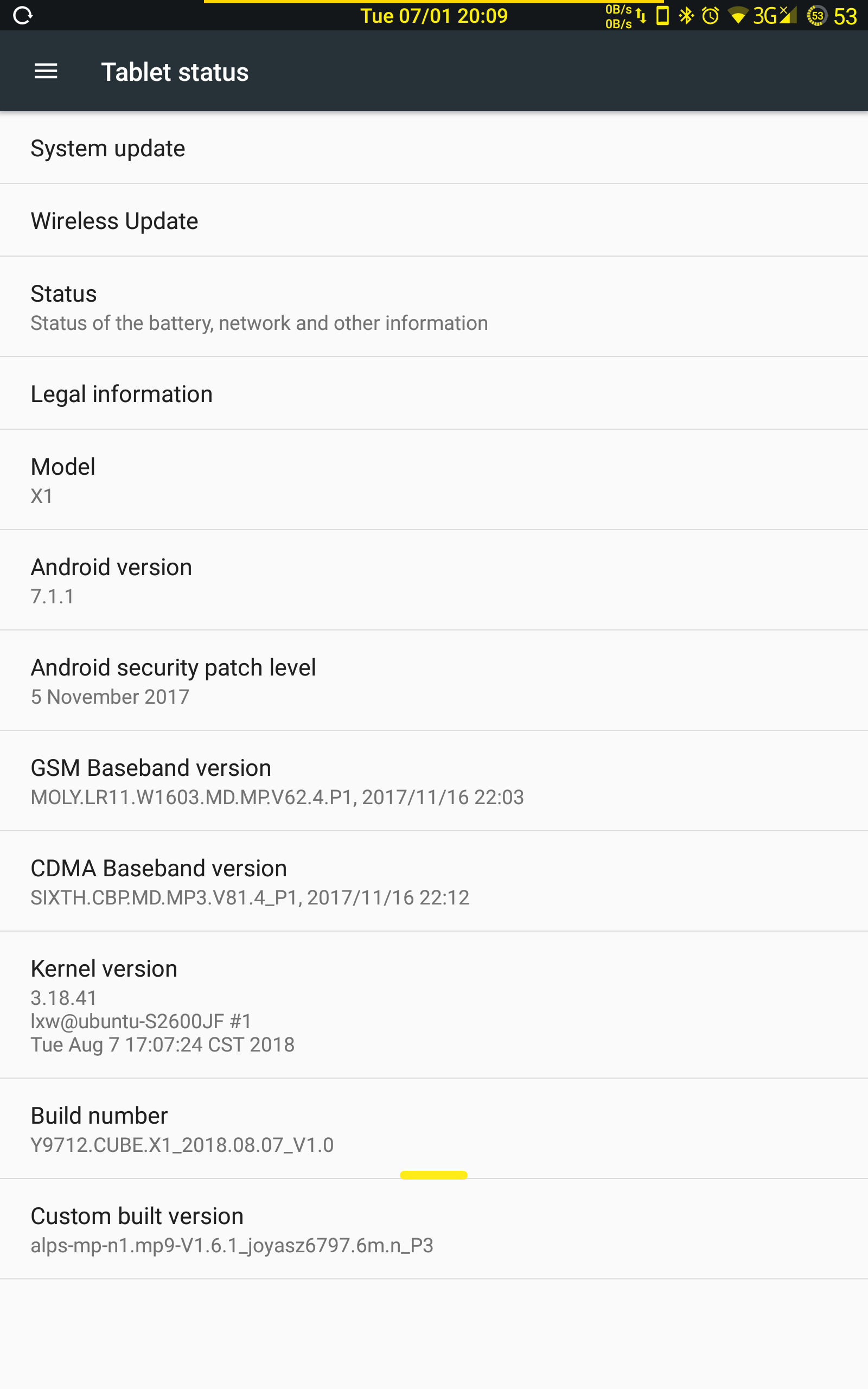

11-01-2020, 09:56 AM
1)After i reinstall my rom and i try to write imie using miracle but still unable to write
2)Please see this is after reinstall GSM and CDMA
3)can i know what to do next please help
This post was last modified: 11-01-2020, 10:01 AM by gayble.
50,949
11-01-2020, 12:27 PM
(11-01-2020, 09:56 AM)gayble 1)After i reinstall my rom and i try to write imie using miracle but still unable to write
from your screenshot, baseband is now fixed
