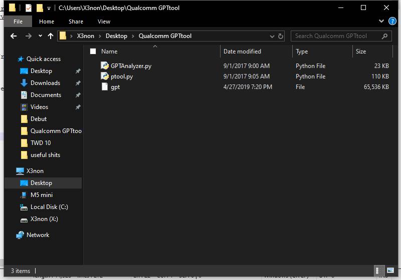

  1. Extract the contents of qualcomm gpttool then copy GPT file from your firmware into the same folder as the two python scripts
    [Image: How-to-create-rawprogram0-and-patch0-for...ware-1.jpg]

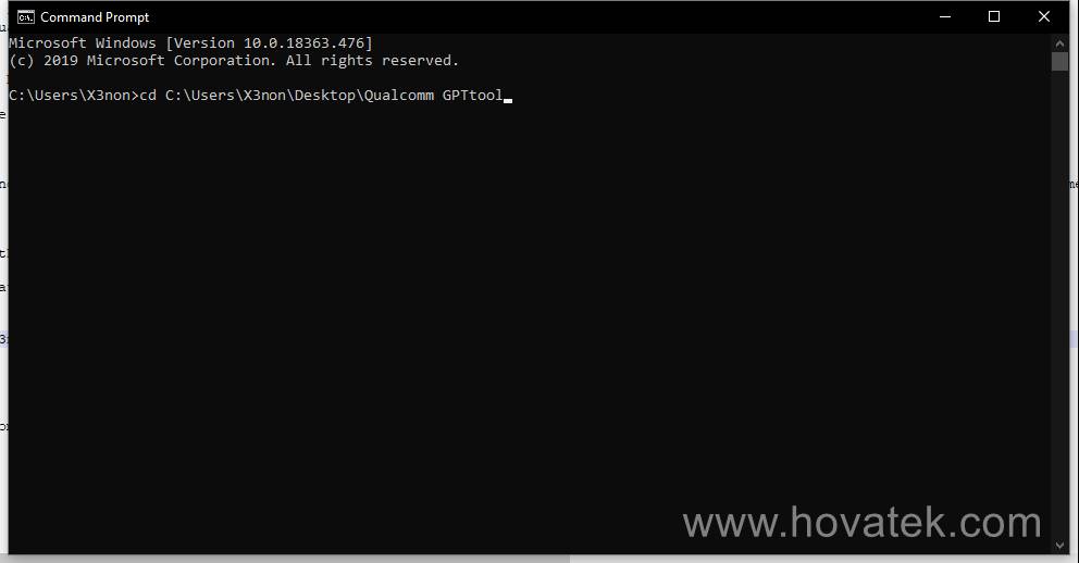

  2. Open a command prompt window (if you're using windows 10, ensure to open command prompt not powershell window). Simply click the start menu and type "CMD" then press Enter key
  3. In the CMD prompt window, change the path to the folder where the extracted files and GPT file are located by typing the command below then press Enter key
    cd folder_location e.g cd C:\Users\X3non\Desktop\Qualcomm GPTtool

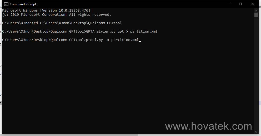

  4. Type the command below and press Enter key (this command will process the GPT file and output the result into a new file named partition.xml)
    GPTAnalyzer.py gpt > partition.xml
    [Image: How-to-create-rawprogram0-and-patch0-for...ware-3.jpg]
  5. Type the command below and press Enter key (this command will process the partition.xml file created earlier on)
    ptool.py -x partition.xml
    [Image: How-to-create-rawprogram0-and-patch0-for...ware-4.jpg]

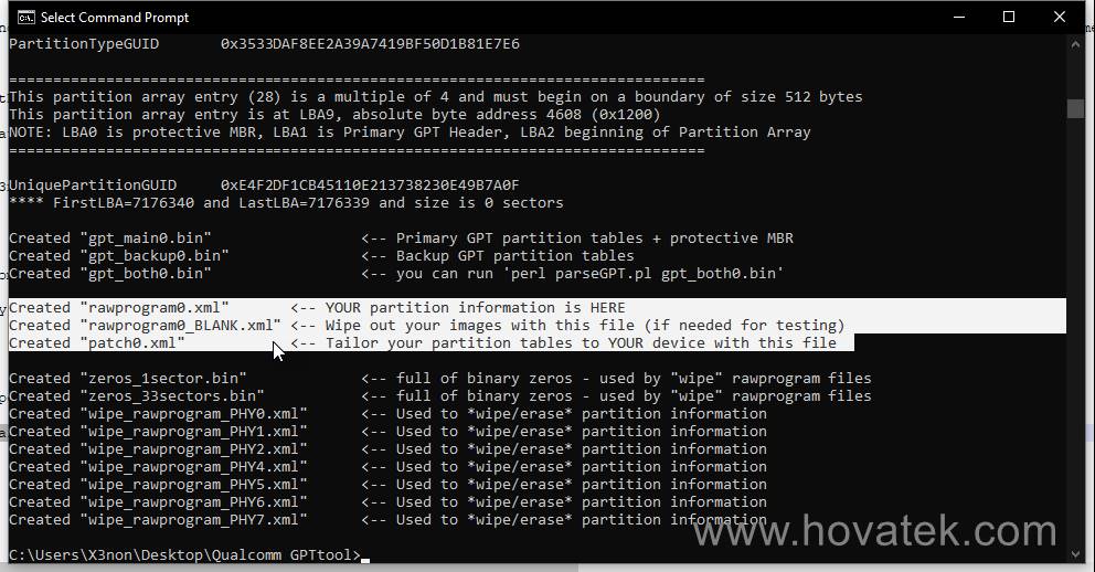

  6. Once successful, you'll get a created rawprogram0 screen like the one below
    [Image: How-to-create-rawprogram0-and-patch0-for...ware-5.jpg]

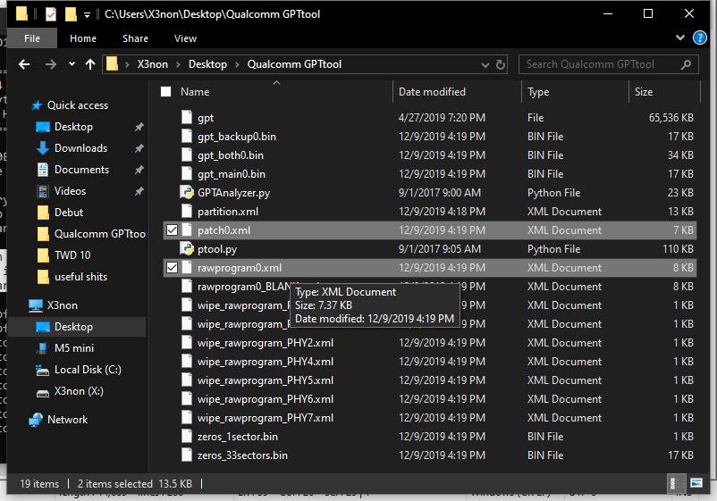

  7. Check the folder for the newly created rawprogram0 and patch0 files
    [Image: How-to-create-rawprogram0-and-patch0-for...ware-6.jpg]

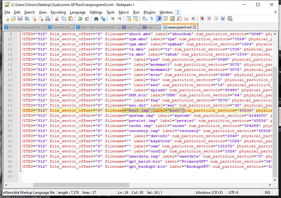

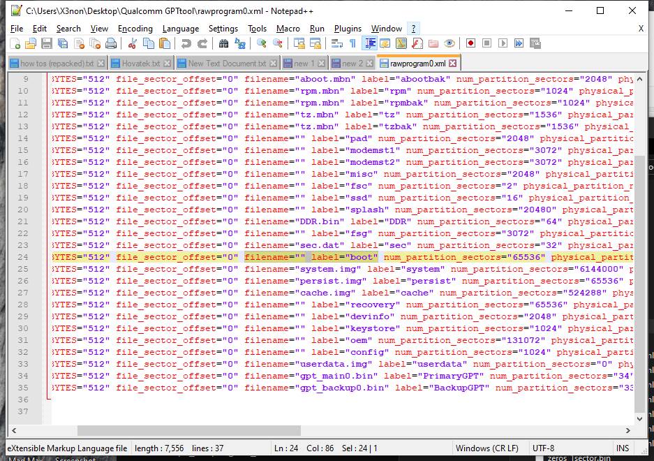

  8. You will need to edit rawprogram0 file to add filenames of any missing partition using any text editor tool
    [Image: How-to-create-rawprogram0-and-patch0-for...ware-7.jpg]
  9. You're to use the exact filename as you have in your firmware / backup. e.g if you have boot.img in your firmware then filename must be boot.img
    [Image: How-to-create-rawprogram0-and-patch0-for...ware-8.jpg]
