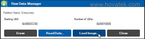

  12. A new window will pop up, click LoadImage...
    [Image: How-to-use-QFIL-to-flash-to-a-single-par...comm-1.jpg]

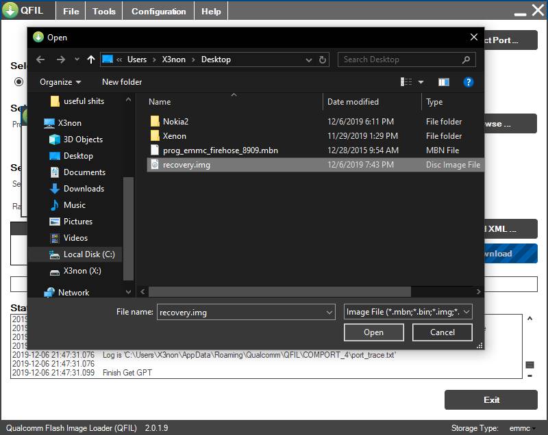

  13. In the new window that pops up, select the file you wish to flash then click Open
    [Image: How-to-use-QFIL-to-flash-to-a-single-par...comm-2.jpg]

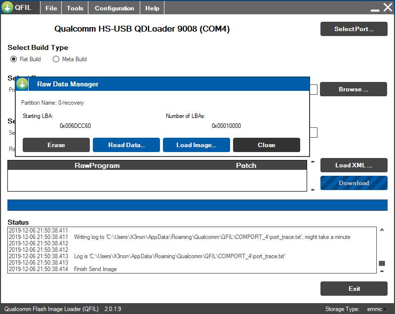

  14. You should get "Finish Send Image" once QFIL has successfully flashed the image onto the said partition. Ensure to scroll up the logs and check for error messages, just to be sure flashing is successful
    [Image: How-to-use-QFIL-to-flash-to-a-single-par...comm-3.jpg]

so to write for recovery partition, i'll simply right click on it, manage partition data, load image then i'll select the file and open
Now in order not to get errors while writing a particular file ensure that the file name you're writing has no space in it
