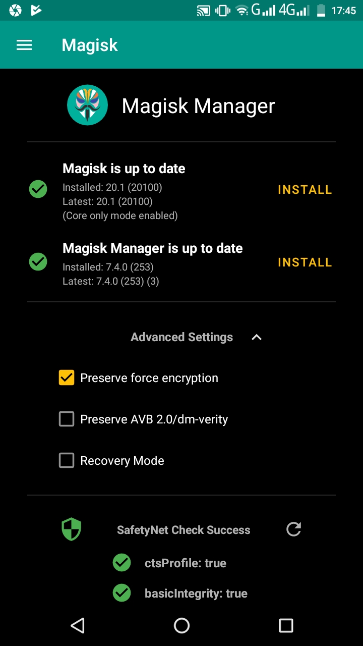

Just in case others are following this thread....
To create a rooted Android OS
1. I had original os on my SD card, used Zarchiver to unzip boot.img onto my phone SD card.
2. Installed magisk and navigated to above mentioned boot img file and patched it.
3. Newly patched boot image file by magisk will be called "magisk_patched.img"
4.Transferred this magisk patched file to PC, after making new folder (name it whatever you like), after dropping files to this folder.
5. Renamed "magisk_patched.img" to "boot.img"
6. Copy this renamed file (boot.img) to the folder where you have extracted your OS you wish patch. Merely copy and replace files.
Now you have a rooted OS ready to install.
Possible issues after loading in SP Flash Tool:
1. Checksum ini file error, since you altered the boot.img you must either alter the checksum file to match new boot.img file which I know not how to do, I deleted the checksum file forcing SP Flash Tool to ignore this final check.

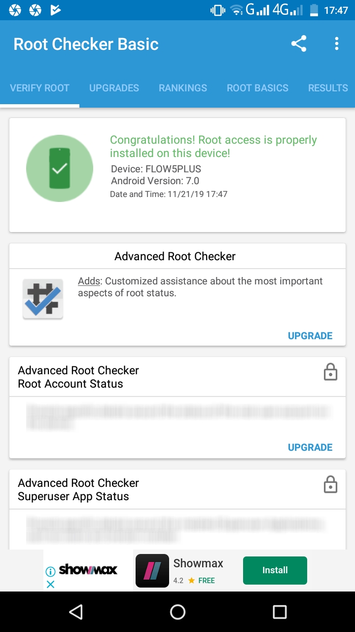

Result : After install phone is rooted.
