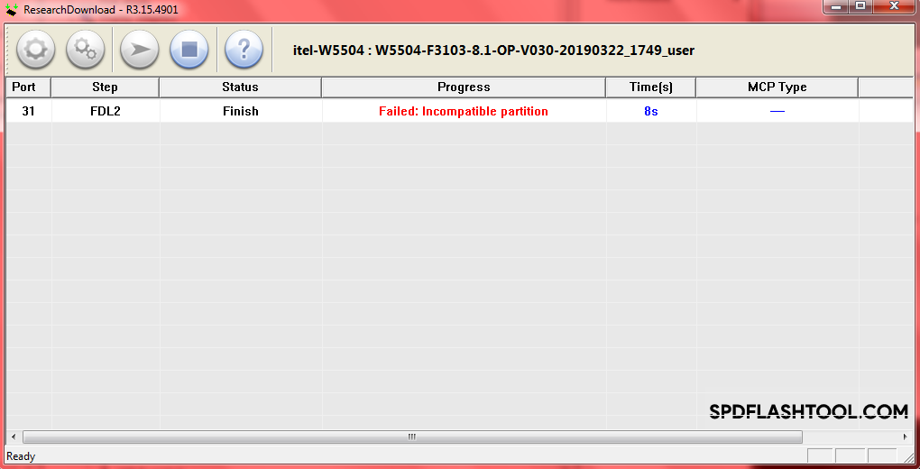

I have followed the instructions and dowldowded the files from that link however when I try to to flash I get partitionmismatch. Thanks i mean alot of thanks but anyway forward senior.

(18-11-2019, 06:59 PM)Abdul-hanan I have followed the instructions and dowldowded the files from that link however when I try to to flash I get partitionmismatch. Thanks i mean alot of thanks but anyway forward senior.
attach a full screenshot of the error message you encountered
also attach a screenshot of research download tool settings after you've loaded the files
upload your screenshots to imgur.com

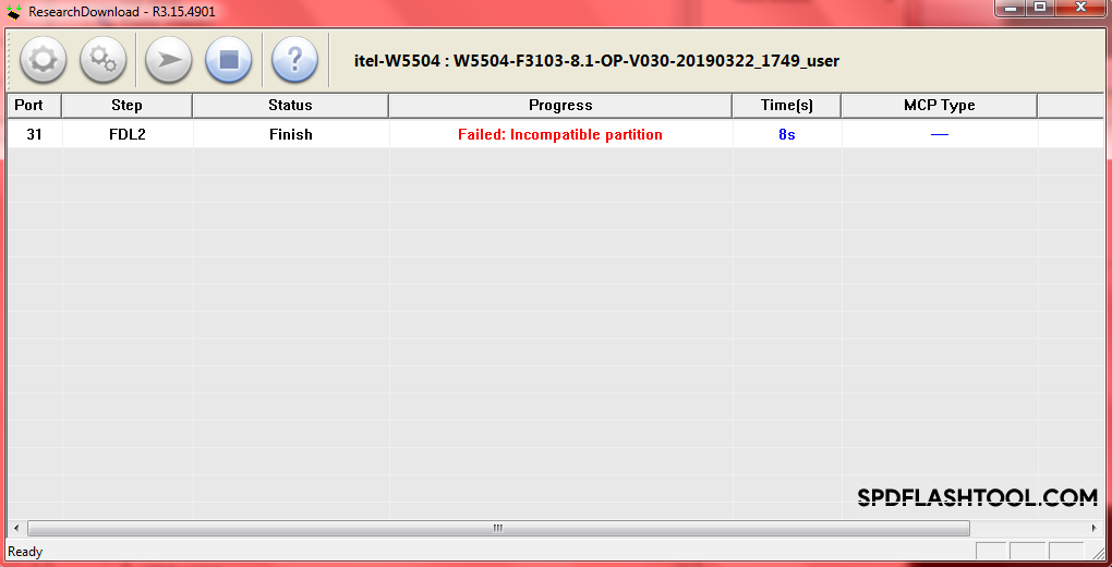

Here is the screenshot
50,906
25-11-2019, 05:59 PM
(25-11-2019, 03:53 PM)Abdul-hanan Here is the screenshot
try using latest research dl tool version @ https://www.hovatek.com/forum/thread-15611.html
