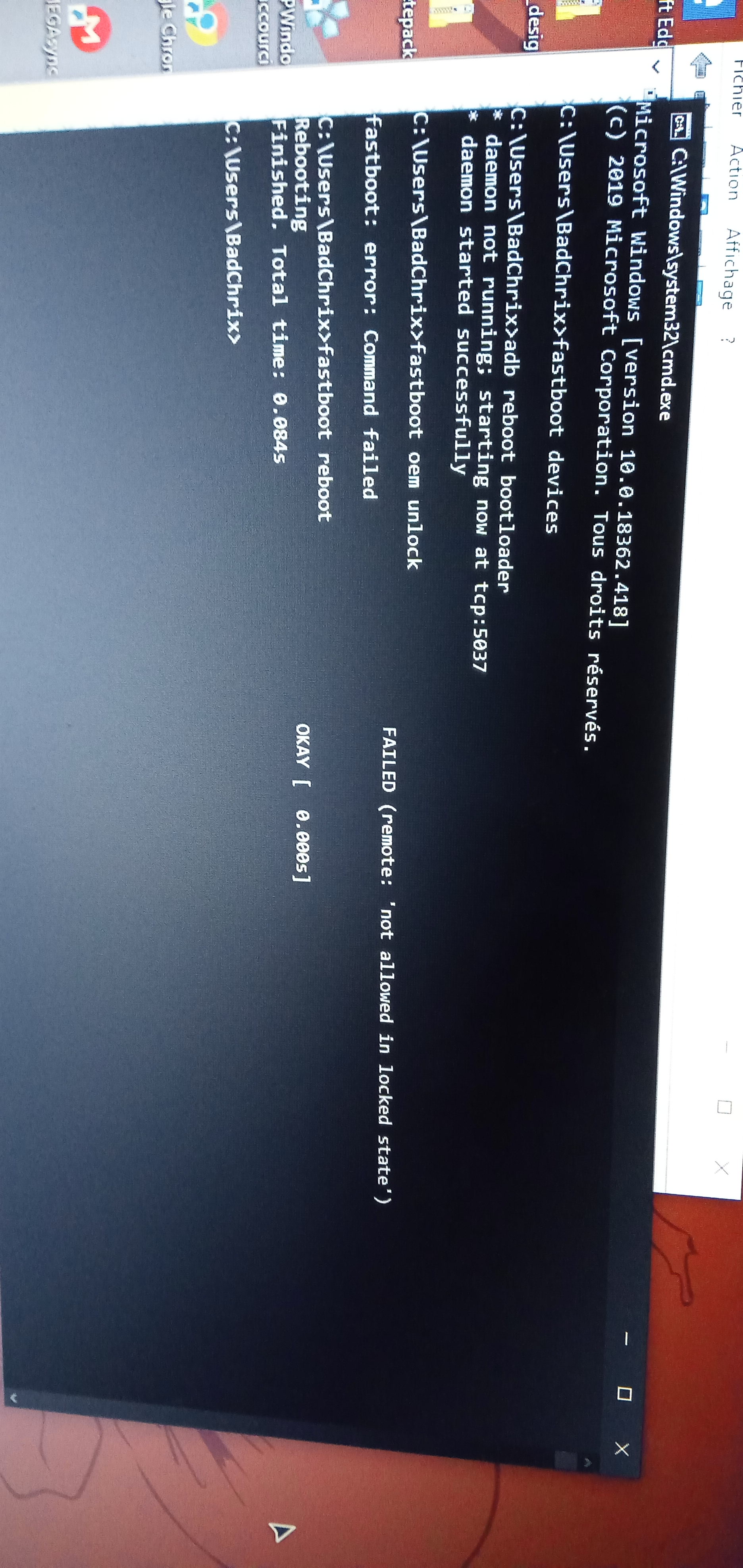

Hello I have an Inifinx S4 x626 which I can not unlock the bootloader I followed your tutorial on Youtube but my computer shows me error

(22-10-2019, 09:27 PM)Les Reufs Hello I have an Inifinx S4 x626 which I can not unlock the bootloader I followed your tutorial on Youtube but my computer shows me error
what error? attach a full screenshot
also ensure you're using latest version of adb and fastboot @ https://www.hovatek.com/forum/thread-26886.html

yes I use the latest version and here is the problem on the photo

(23-10-2019, 05:12 PM)Les Reufs yes I use the latest version and here is the problem on the photo
Did you enable oem unlock in developer option?

yes I activated in the developers
try both commands listed at step 14 @ https://www.hovatek.com/forum/thread-19578.html
