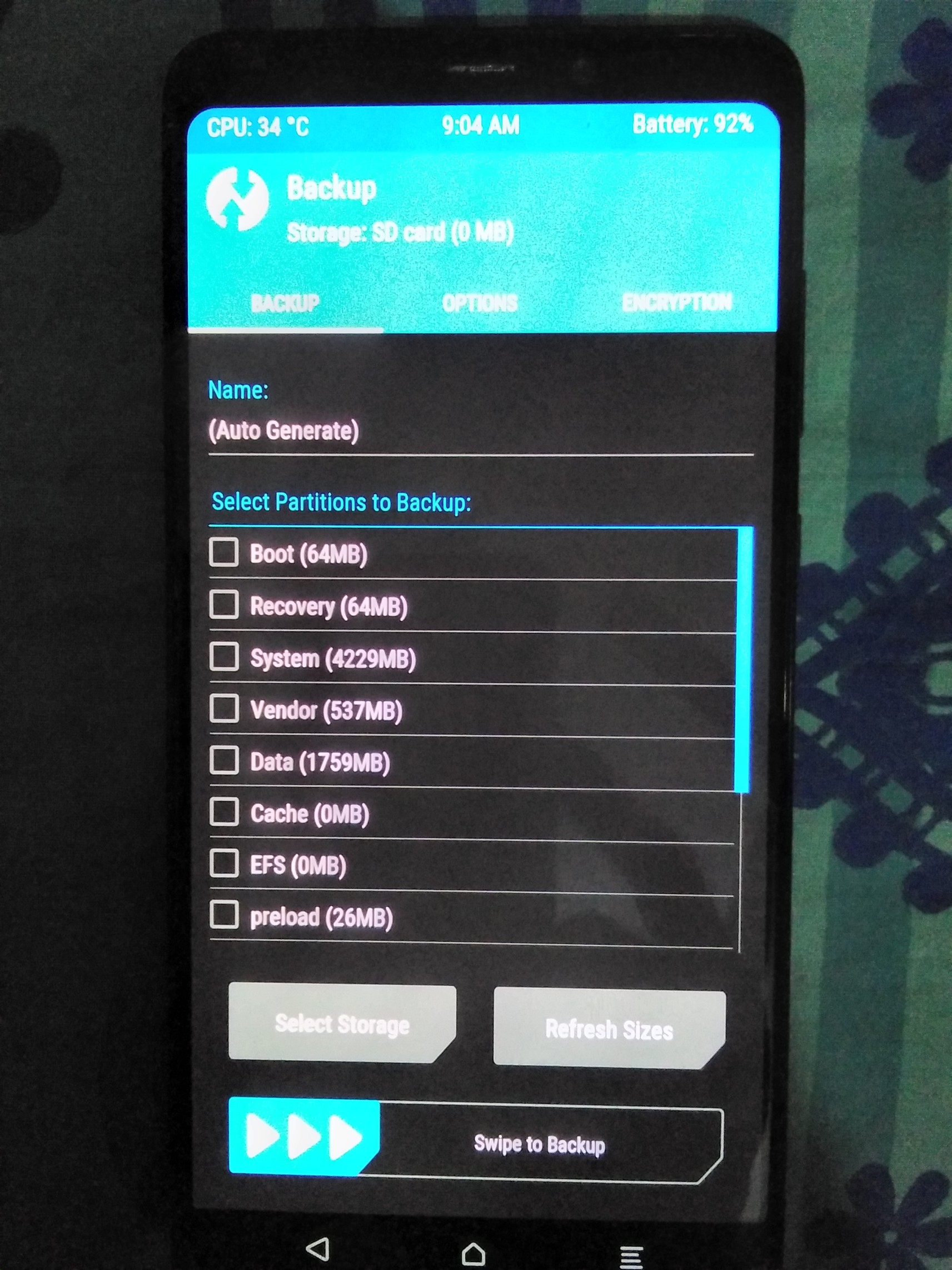

Hello am new here,
am running rooted Android 11 CAOS which I flashed system.img and boot.img bot via fastboot.
I flashed twrp 3.3.1, via rashr.apk but I encountered 0mb, after editing forceecrypt to encryptable now both internal and external storage is visible but am facing "Twrp fail to mount 'system_root' (system needs cleaning)"

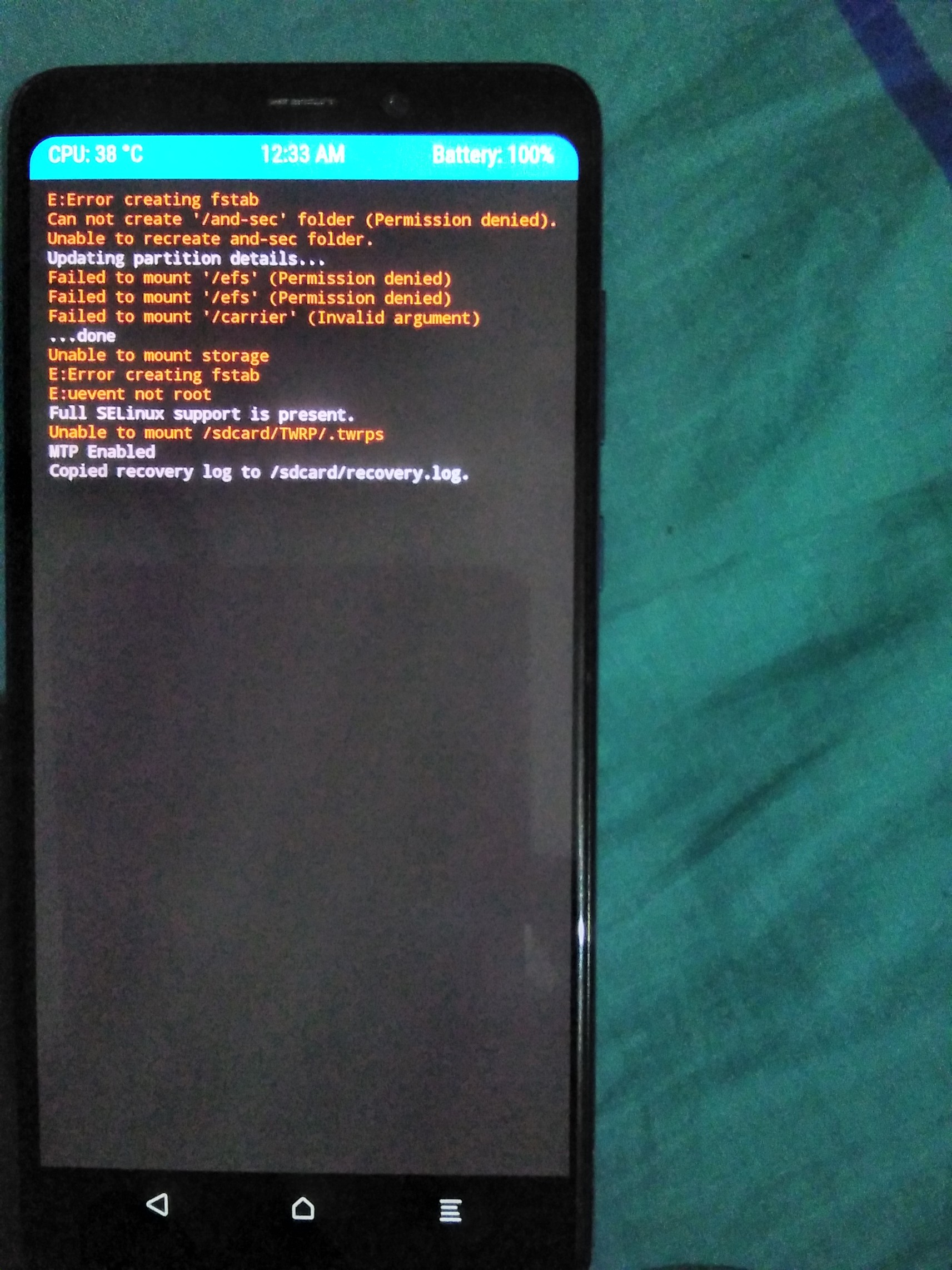

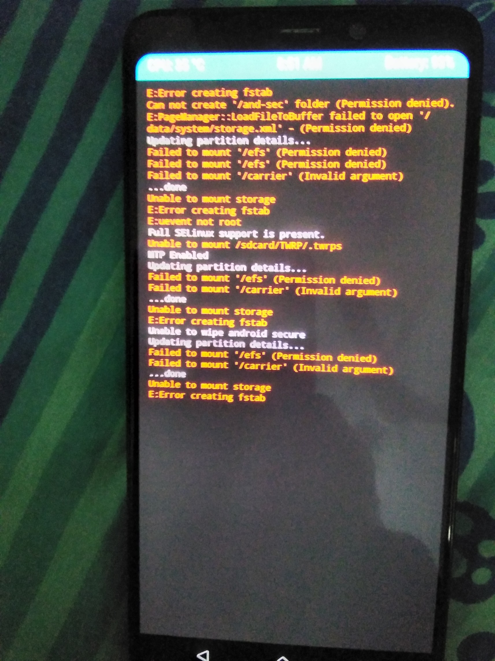

I can't access internal storage,SD card, or data partition in TWRP after I ported it from other phone. It started to show the available size instead of the 0 mb error when I flashed force disabler DM verity zip to data partion using ex kernel manager APK, after that system seems a little scrambled. But still I can't access the folders in TWRP. TWRP is saying permission denied.

(30-05-2021, 07:32 AM)LUCID_DREE I can't access internal storage,SD card, or data partition in TWRP after I ported it from other phone. It started to show the available size instead of the 0 mb error when I flashed force disabler DM verity zip to data partion using ex kernel manager APK, after that system seems a little scrambled. But still I can't access the folders in TWRP. TWRP is saying permission denied.
post this on your thread @ https://www.hovatek.com/forum/thread-39115.html
include your fstabs as well and as for decrypting /data try other methods on the list at page 1

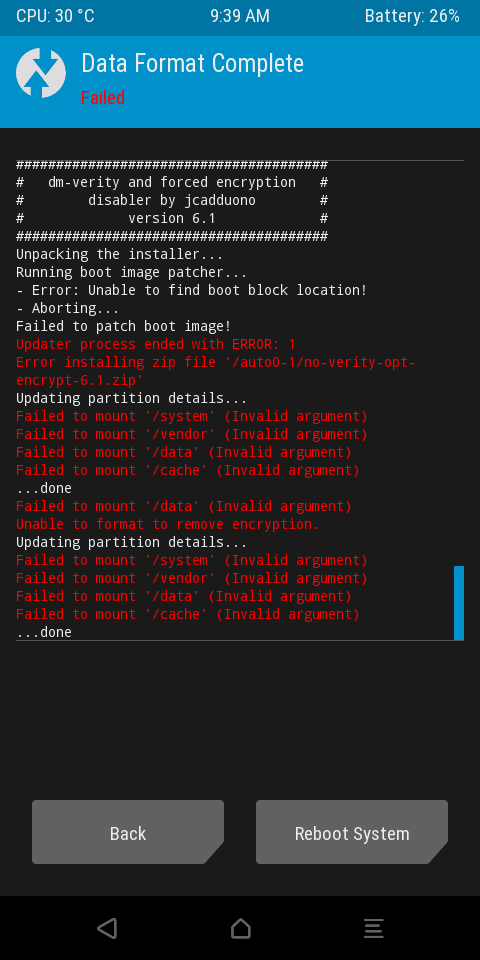

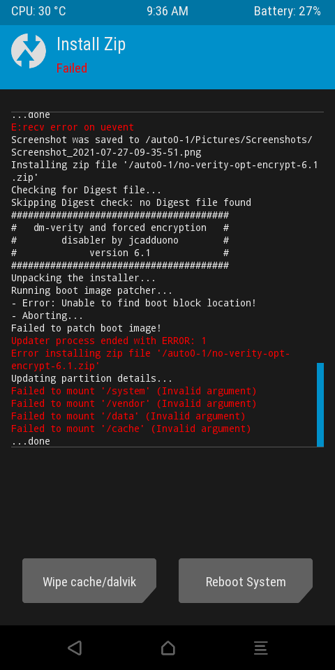

Error message
E:primary block dev/block/platform/mtk-msdc.0/11120000.msdc0/by-name/userdata for mount point / data / not present
and because of this unable to mount storage and other , I try the whole the abe step but not work for me. if you have any suggestion i can do in recovery.img pls?

(27-07-2021, 03:53 PM)robel pop Error message
see this post @ https://www.hovatek.com/forum/thread-391...#pid214347
if you still have problems with twrp's mount point then create a new thread for it by clicking "ask question" at the top
