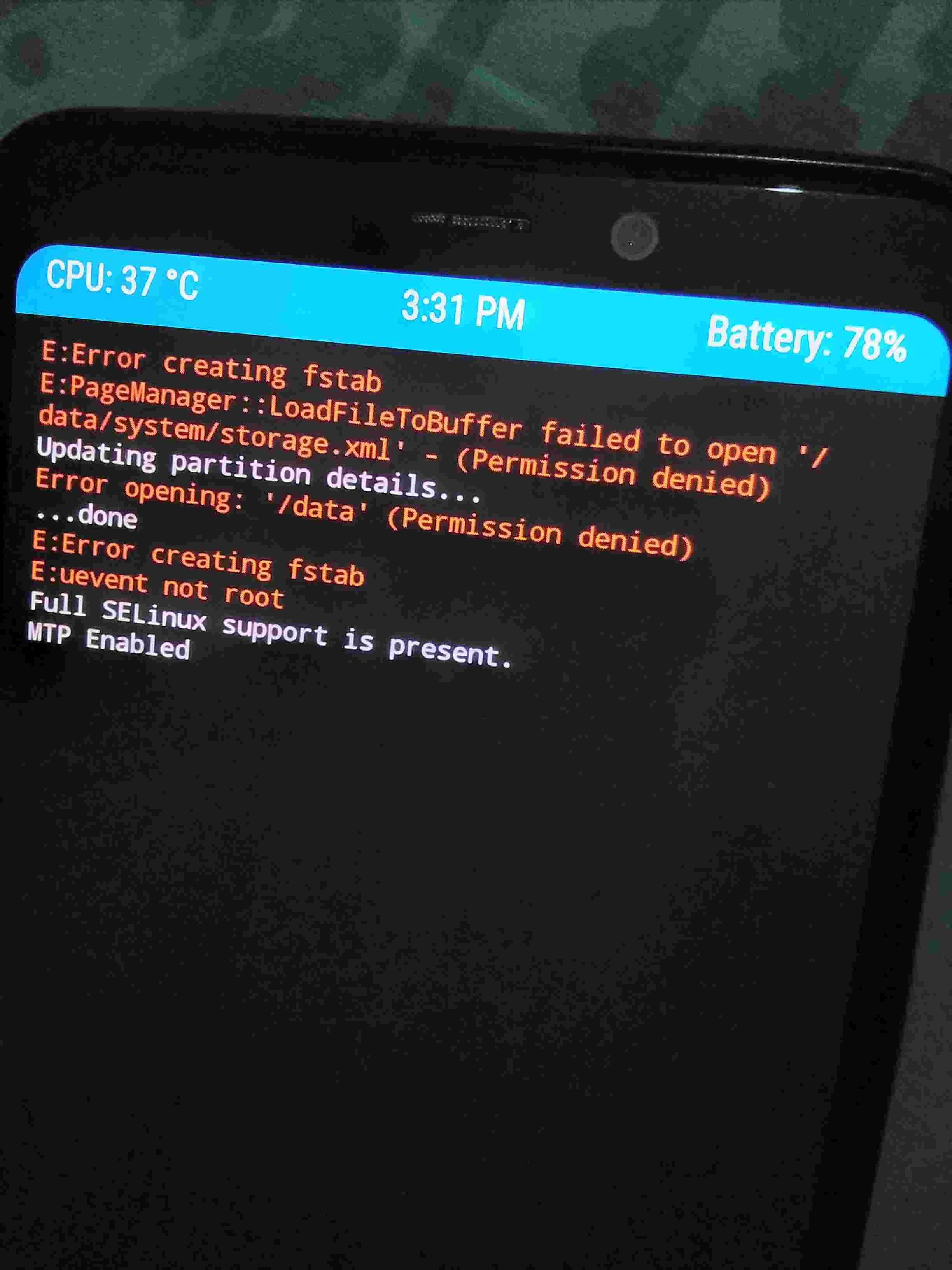

2) after porting the a8 star's original twrp, touch started working and the issues persisting are the following:

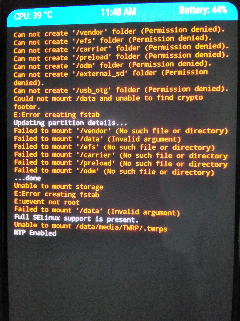

i)most mount points are wrong ( a picture of log is available at the link I have left at the end
ii)opening terminal only displays a blank black screen

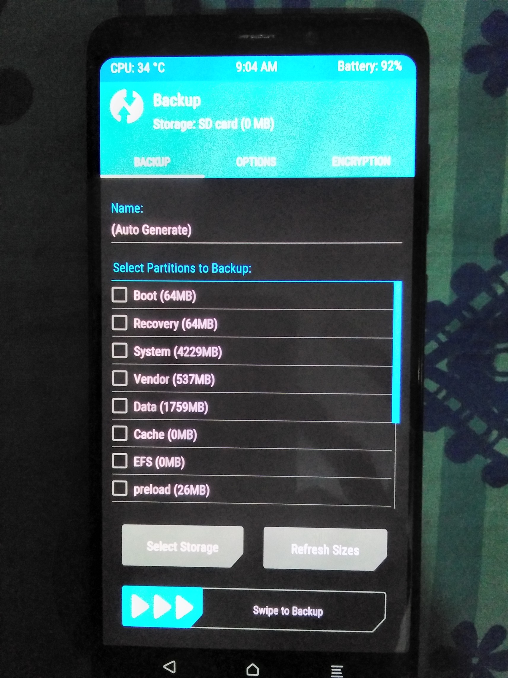

iii)I can't select many partitions when I tap on backup (possibly caused by wrong or incomplete mount points)
iv) I can't change brightness in twrp even though I swipe the slider to extreme left for lowest brightness
v)size of internal storage and sd card is showing as zero( possible due to incorrect and incomplete mount points)
vi)I can't access internal storage and sd card through file manager of twrp(also caused possibly by erroneous mount points)

Sir I have added all mount points from stock recovery to twrp one but still the 3 partions have 0 mb size in twrp , these are internal storage, microsd and data PARTITION. Sir also there is no twrp.fstab but only recovery.fstab. Pls help sir

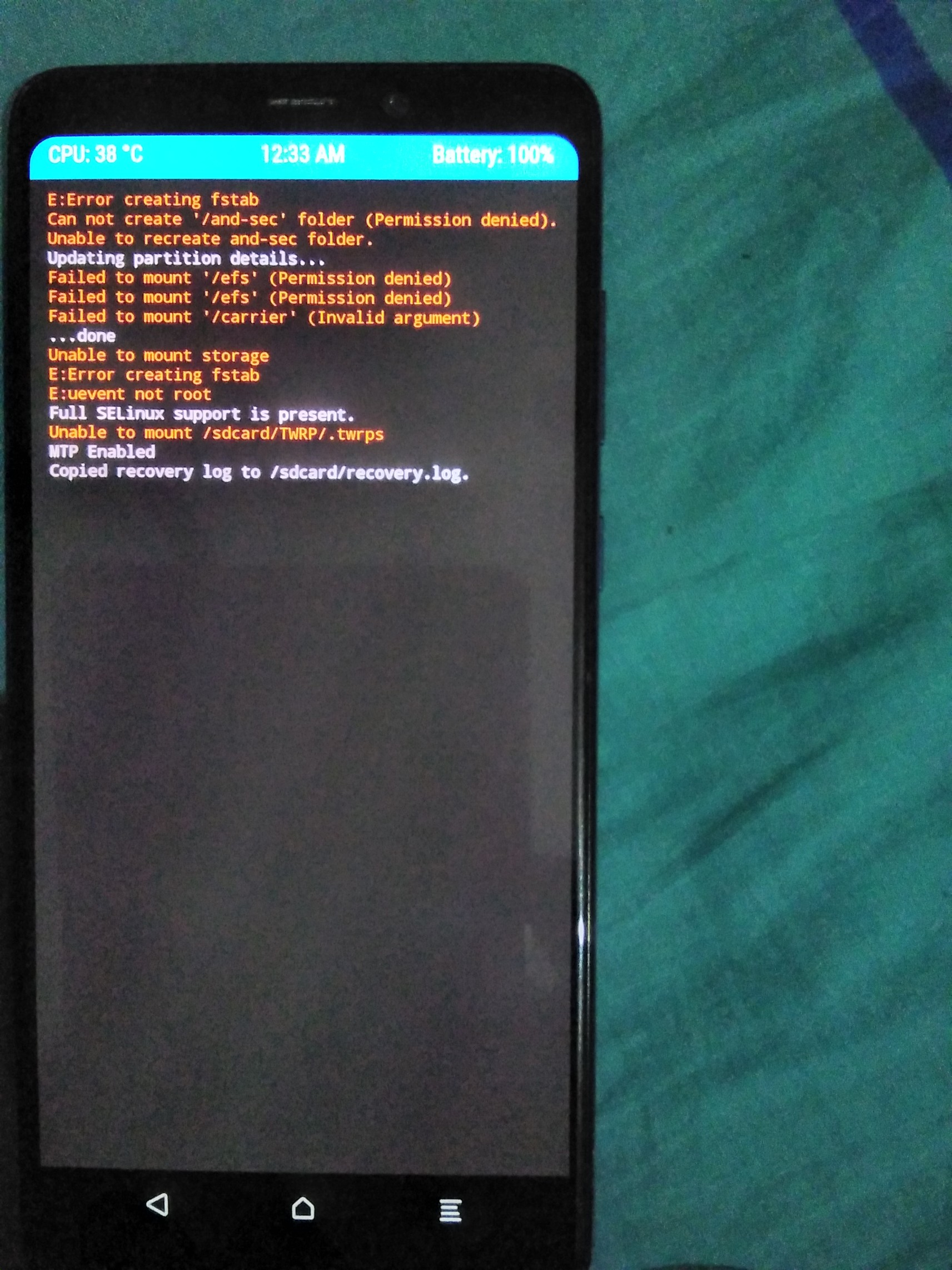

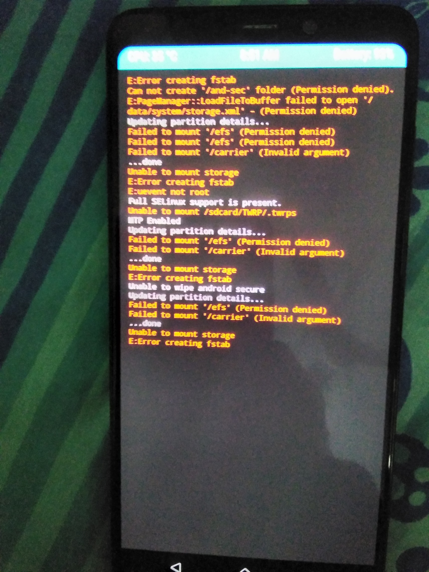

I can't access internal storage,SD card, or data partition in TWRP after I ported it from other phone. It started to show the available size instead of the 0 mb error when I flashed force disabler DM verity zip to data partion using ex kernel manager APK, after that system seems a little scrambled. But still I can't access the folders in TWRP. TWRP is saying permission denied.
