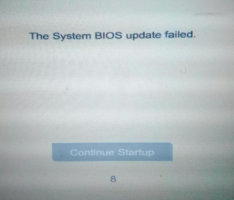

My bios keep saying " the system bios update failed" after I had installed the driver. The bios driver is the latest version for my machine, released may 24, 2019 but won't update

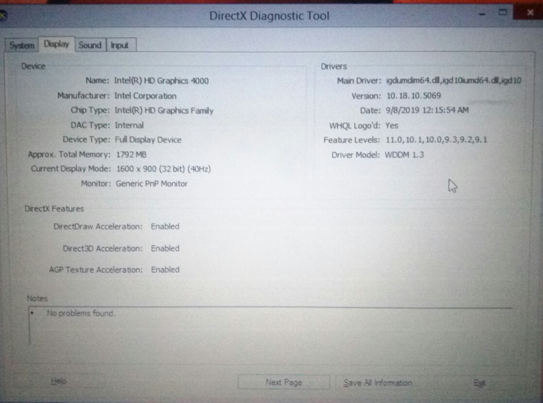

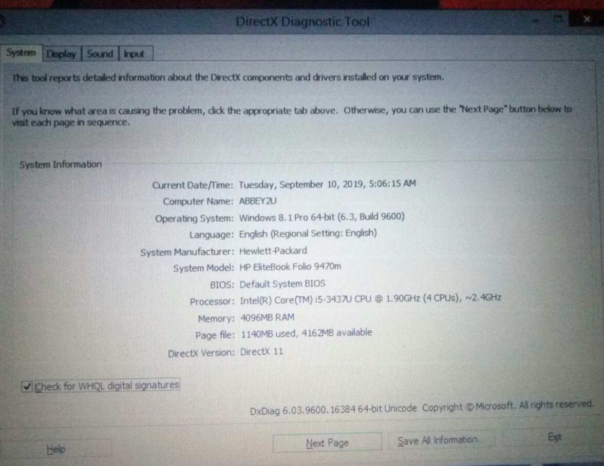

click the start menu then type dxdiag and launch it
attach a full screenshot of what it displays

Thank you. Here is the screenshot

(11-09-2019, 12:21 AM)abbey2u Thank you. Here is the screenshot
bios version is not indicated properly here, boot the pc into bios then check for the current bios version if its higher or lower than the version listed @ https://support.hp.com/us-en/drivers/sel...ok/5271146

That was the driver I downloaded and install but won't update. After

I sense that, maybe because bios is not updated that was why my laptop goes off and on, that is why I want to get it updated

have you confirmed the current bios version from the bios itself? if yes, whats the version?
(11-09-2019, 01:41 PM)abbey2u ...
very unlikely

Run diskmgmt.msc delete the hptools partition, then download the latest bios update from HP.com(you have to search for your exact laptop model and select your current operating system) and use that to update it
