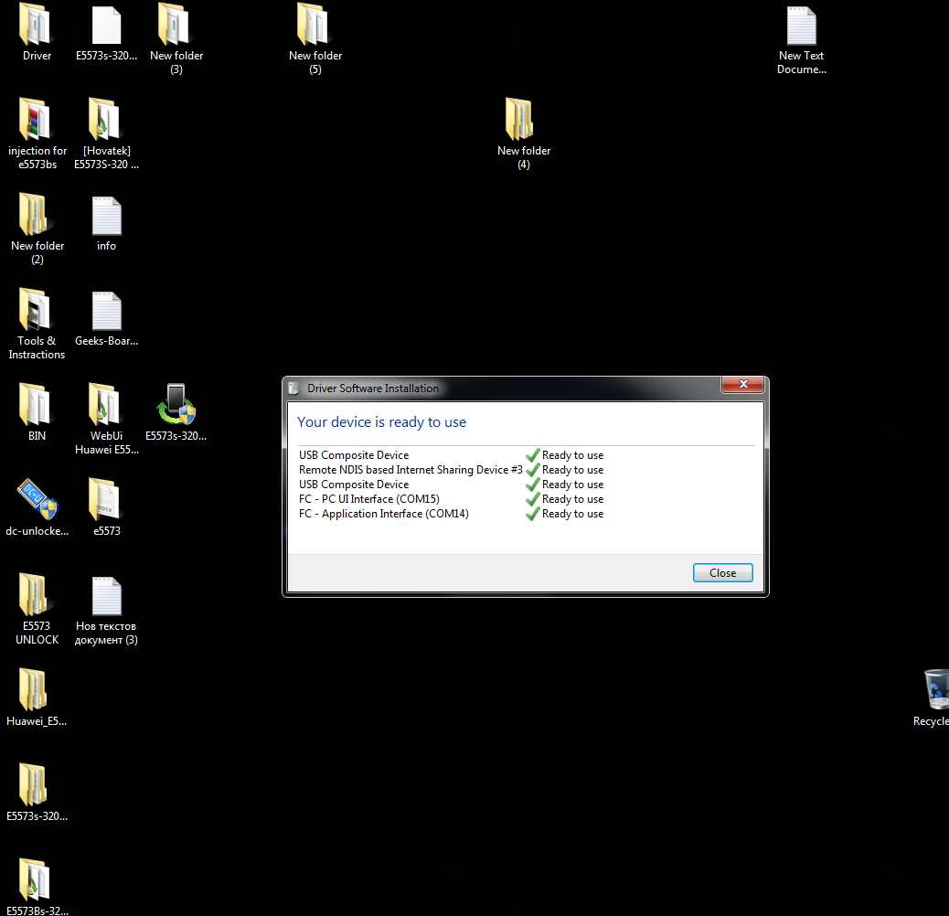

No only connected with USB to the pc can see the modem and FC and Remote NDIS internet sharing then he automatically open a black page (empty browser page she needs to be for the DASHBOARD) but since I can't instal anything it stays like this. I try to install a couple of times but without success, it hangs in the centre of the installation because the MiFi reboots and error 19 show up.
Sorry for my bad English its all about one thing the router is with v4 auth ok.
It was with the latest version 328, not original system rebranded (with Viacom logo).
I just want to say I did the method with the pin short and he did his job unlocked the device but then he left me with much bigger problems.
Now it's hard to believe that the device is bricked since it turns on and I can do things like put my IMEI but in hex format but that's all any other AT command ends with 0 or error or error 50.
