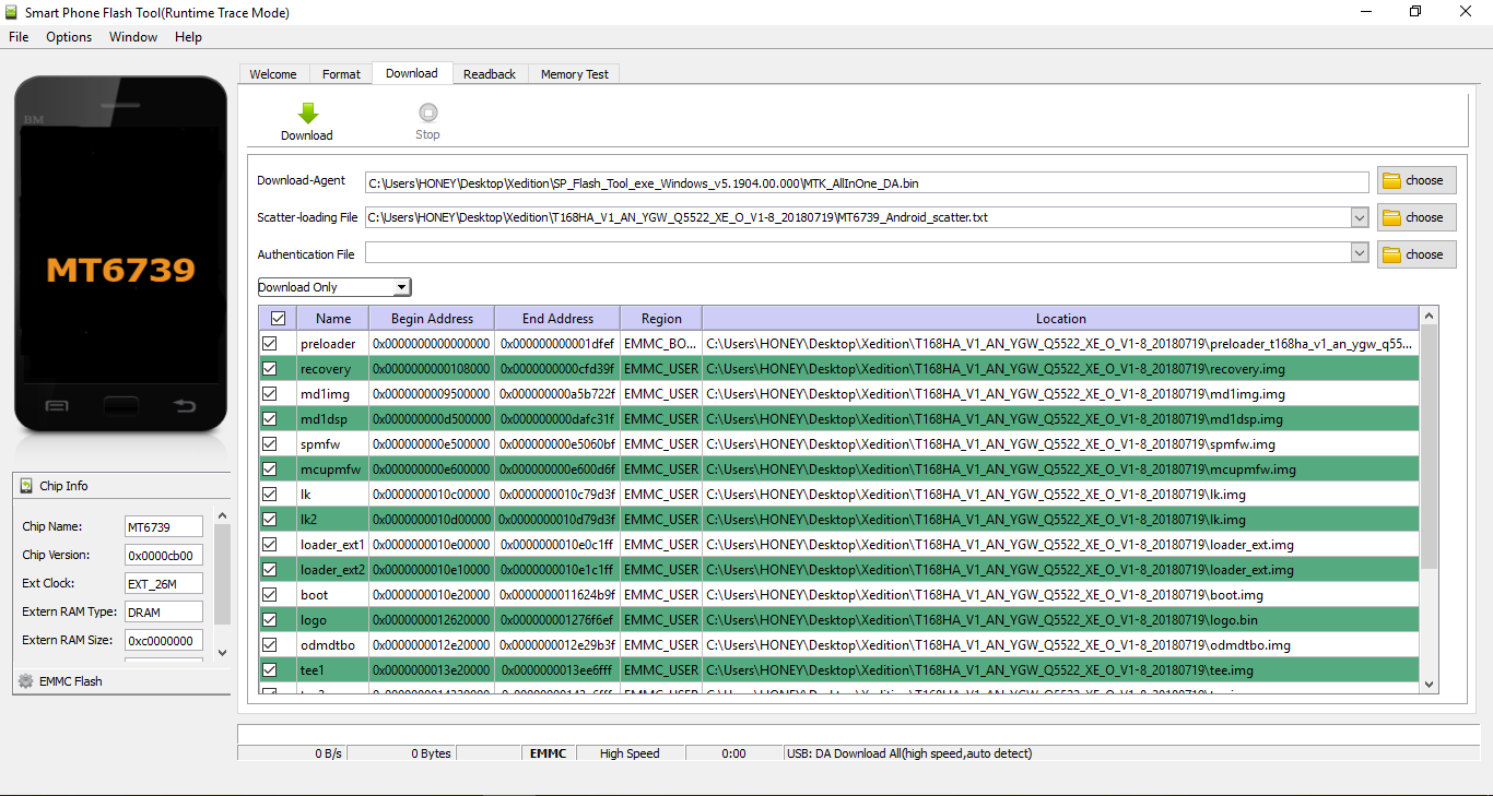

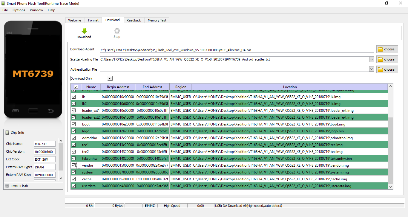

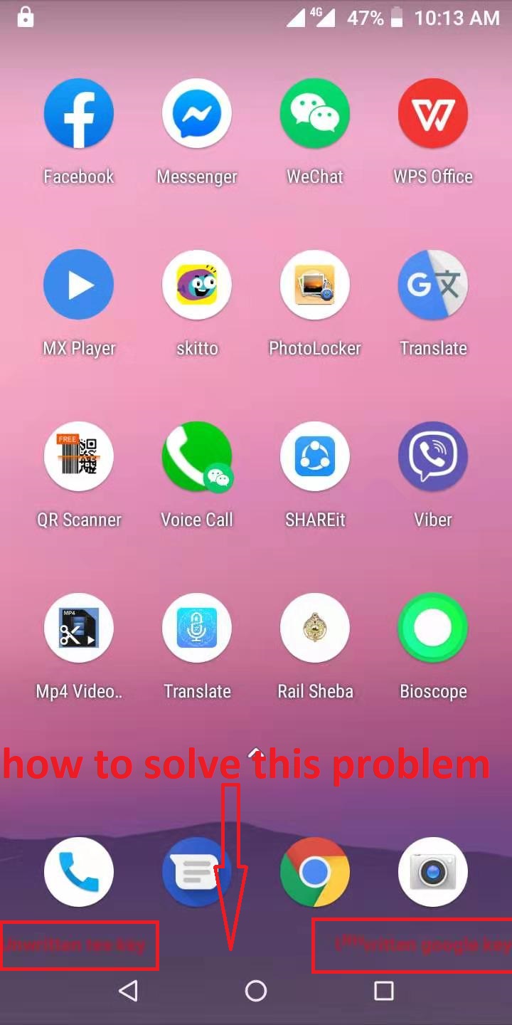

The phone did not have this problem in the new condition.  This problem was created after flashing the flash file.  It is the company's original flash file.  If anyone knows, please help and solve this problem.
Brand: CCIT; Model: Xedition;
Hardware: MT6739
Platform: mt6739
File system: EXT4
Android version: 8.1.0
Firmware version: 1531990417
Baseband version: MOLY.LR12A.R2.MP.V32.5
Build number: t168ha_v1_an_ygw_q5522_xe_o_v1.8
Description:  full_t168ha_v1_an_ygw_q5522_xe_o-user 8.1.0 O11019 1531990417 release-keys
Serial number: 0123456789ABCDEF
Root: No
Full memory RAM: 0x40000000 (1024 MB)
Full memory of ROM (EMMC_USER): 0x73A000000 (29600 MB)
Full memory of ROM (EMMC_BOOT_1): 0x400000 (4 MB)
Full memory of ROM (EMMC_BOOT_2): 0x400000 (4 MB)
Full memory of ROM (EMMC_RPMB): 0x400000 (4 MB)
By-name: /dev/block/platform/bootdevice/by-name

you must have formatted in SP flash tool before flashing the firmware, there are other hidden partitions that shouldn't be tampered with unless you made a backup
did you by any chance make a full emmc_user dump from your phone before flashing?
can you get access to another CCIT Xedition phone that doesn't have this unwritten tee problem? -- this might not work but its worth the try

Option is to deinstall the Factory Mode App using ADB/SDK Tools with PC but Without ROOT
All you need to do is Download this: www.mediafire.com/file/cc443705xa3e6mg/minimal_adb_fastboot_v1.3.1_setup_2.rar
U must enable USB-Debugging on your Ulefone Power 3/3s. (no matter which Android version)
Connect your Smartphone with your PC using USB Cable.
Then start the Program you downloaded before.
Maybe you Have to Confirm the Debugging on your Smartphone.
1. Type into the Console:
adb shell "pm list packages | grep com.mediatek"
If the app is preinstalled on your device then it'll show up in the output, if not then output will be blank
2. Type into Console to temp uninstall the app:
adb shell pm uninstall --user 0 com.mediatek.factorymode
You should get a "Success" message
Restart your phone and confirm that the Red 未写入key or 未写入tee key is gone. Note that if you factory reset the phone then you'll have to repeat the procedures all over again
I hope it Works and sorry 4 my bad English.
Greetings from Germany
This post was last modified: 16-05-2020, 05:43 PM by X3non.

I have the same problem but no Factorymode installed on my phone

(01-09-2020, 01:08 PM)lew247 I have the same problem but no Factorymode installed on my phone
you could try the fix @ https://www.hovatek.com/forum/thread-324...#pid187751 ; lets know if that works for you
if you still have problems then create a new thread for your device issue by clicking "Ask Question" at the top
