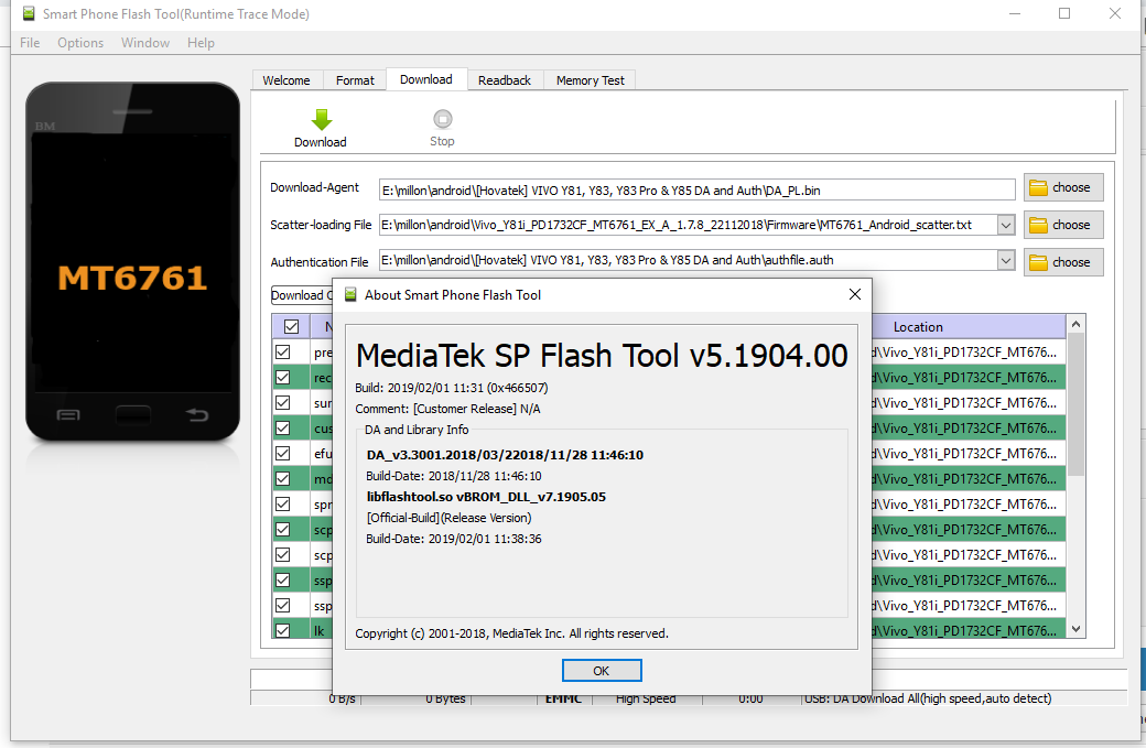

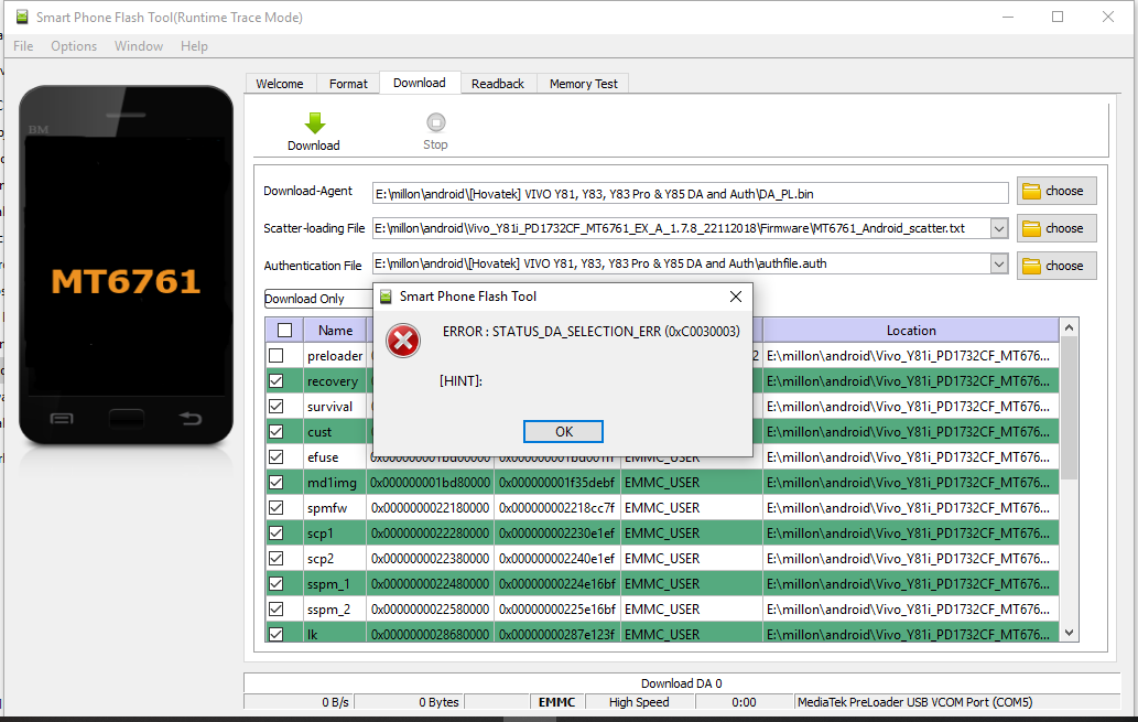

06-06-2019, 01:01 PM
(06-06-2019, 11:29 AM)X3non
(06-06-2019, 07:23 AM)Mukhlesur Rahman Millon oh, I have got a reply for lib DA file mismatch. didn't notice it before posting this question.
Edit: that method does not work. I still get DA selection error.
the said DA file loads fine without errors on v5.1904
attach full screenshot of SP flash tool and the error message
I have unticked on "check LIB DA match", now I can load DA file of Y81 in v5.1904.
I have attached the log and screenshots.

06-06-2019, 10:17 PM
(06-06-2019, 01:01 PM)Mukhlesur Rahman Millon I have unticked on "check LIB DA match", now I can load DA file of Y81 in v5.1904.
seems you get this da selection error after clicking the download button not before
try a different SP flash tool version, you can try latest 5.1916 @ https://www.hovatek.com/forum/thread-13970.html
you can also try flashing using a different PC, lets know the outcome of both
