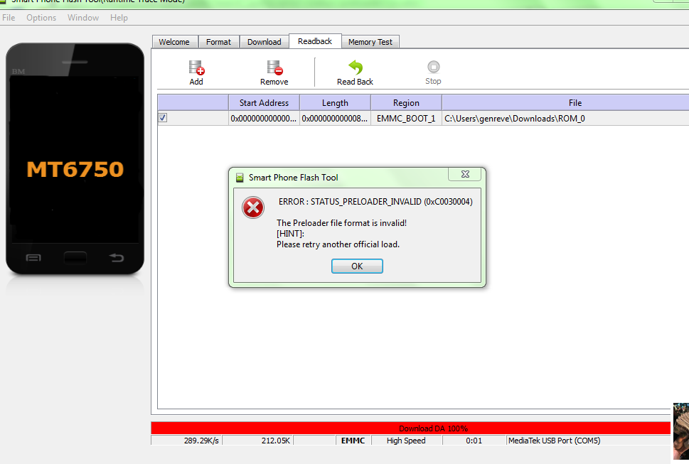

I get the error status preloader invalid in sp flash tool.

Im gettng error status preloader invalid format in sp flash tool. What to do?

(01-04-2019, 05:07 PM)Davidburbos666 Im gettng error status preloader invalid format in sp flash tool. What to do?
Attach screenshot of the error, let's take a look.
Also, state the phone model and in details what's wrong with the phone.

asus zenfone 3s max. android 7.0 MT6750
BTW i attached some screenshot on this error.

im trying to follow this tutorial about how to backup your rom using wwr mtk tool with flash tool.
https://www.youtube.com/watch?v=GMAytZ56hac
but the error Status_Preloader_Invalid is giving me a headache

(02-04-2019, 04:15 AM)Davidburbos666 asus zenfone 3s max. android 7.0 MT6750
attach here the scatter file you're trying to use for this readback
then also try reading from emmc_user region on the phone
lets know if you get any error message

here i attach the scatter file.
.txt
MT6750_Android_scatter.txt

(02-04-2019, 10:11 AM)Davidburbos666
(02-04-2019, 09:55 AM)X3non
set partition_size: 0x40000 then retry
and also give feedback on the emmc_user

Thanks alot i can now readback using emmc user and 0x40000 partition size. Actually i downloaded some firmware and loaded the scatter file. I press the vol up + vol down + power button connect to pc Then it works!. Now i have preloader.bin i can test this to dram test. So i can backup my full rom.
