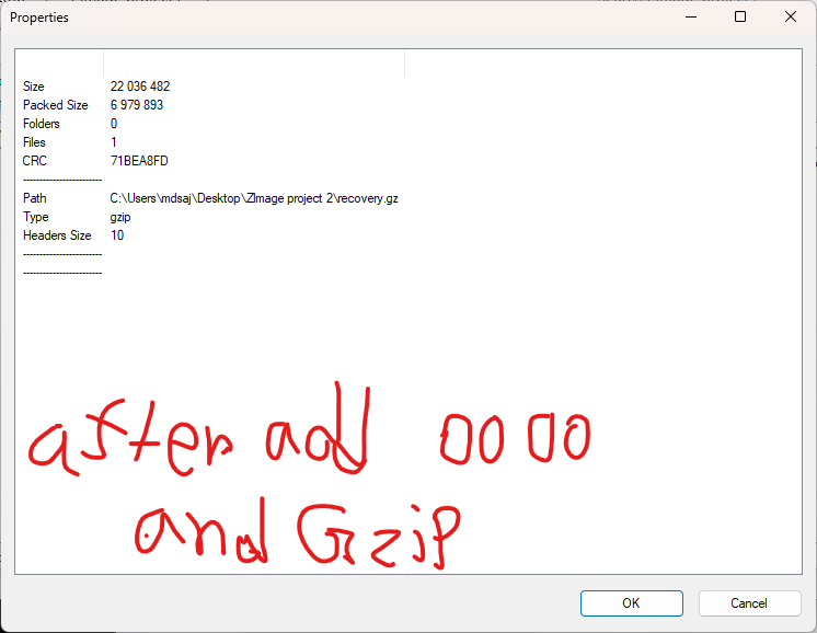

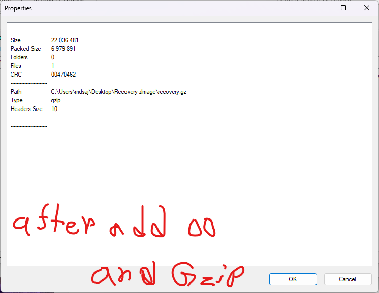

[*]Open the newly compressed file using 7zip then click INFO, check and ensure the "Packed Size" matches the original file (the one you took note of earlier on)
[*]If it doesn't match the original file e.g the packed size is reduced by 1 byte, open the uncompressed kernel in hxd > scroll down to the end and add "00" in the hex section > re-compress back to GZ and check if the new Packed size matches. (The packed size must match that of the original or the recovery wont boot)
In my case I can not match the packed size, its jump don't encrease by adding 00 in hex editor. I amtrying to fix so add 00 00 in hex editor then packed sized zump +2 bite. how can I fix this Problem, please reply. some photos are attached please see this.

I cant not match the packed size. I am try and add 00 and compress with gzip then increase only size not packed size. Next I am add 00 and compress with gzip then it increase packed size +2 bite. I can not make packed size same. please help me.
