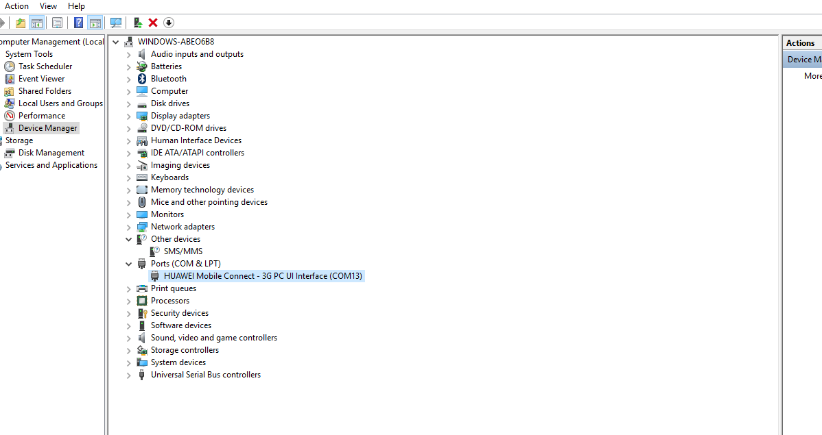

2. Solder USB pinout and connect in TP mode as seen as done in B310/B315; Huawei PC UI COM port detected[/size]

[size=14pt]3. +++++
A. Device is switched dload and ready for firmware flash; Some secureboot devices of this variance may not allow this loader and[/size]
therefore signed loader for such secureboot
[size=14pt]B. Huawei Ports showned
4. +++[/size]
[size=14pt]B. Run Huawei V2 flasher; Netframe work is needed for these flashers to work
C. Indicate port of PC UI e.g. COM14 [/size]
[size=14pt]+++++++ we have done this in B310 many times or use different flash for this firmware flash
