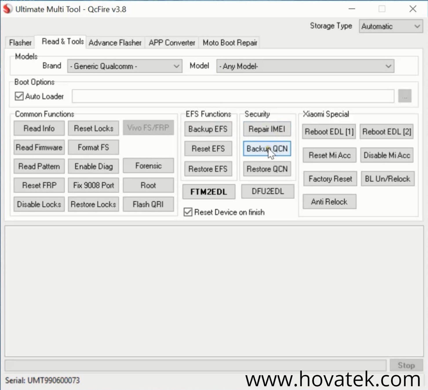

  4. Under Security, click Backup QCN
    [Image: How-to-use-UMT-QcFire-to-backup-and-rest...-QCN-4.jpg]

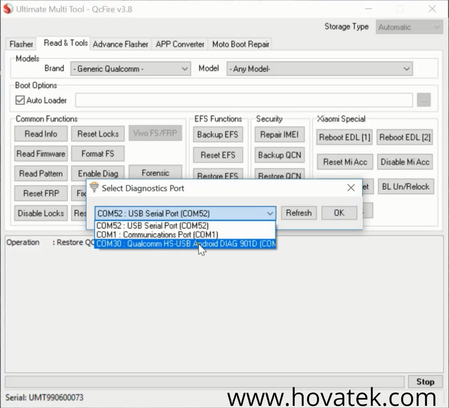

  5. In the Select Diagnostic Port box, select the DIAG port
    [Image: How-to-use-UMT-QcFire-to-backup-and-rest...-QCN-5.jpg]
  6. Click OK
    [Image: How-to-use-UMT-QcFire-to-backup-and-rest...-QCN-6.jpg]

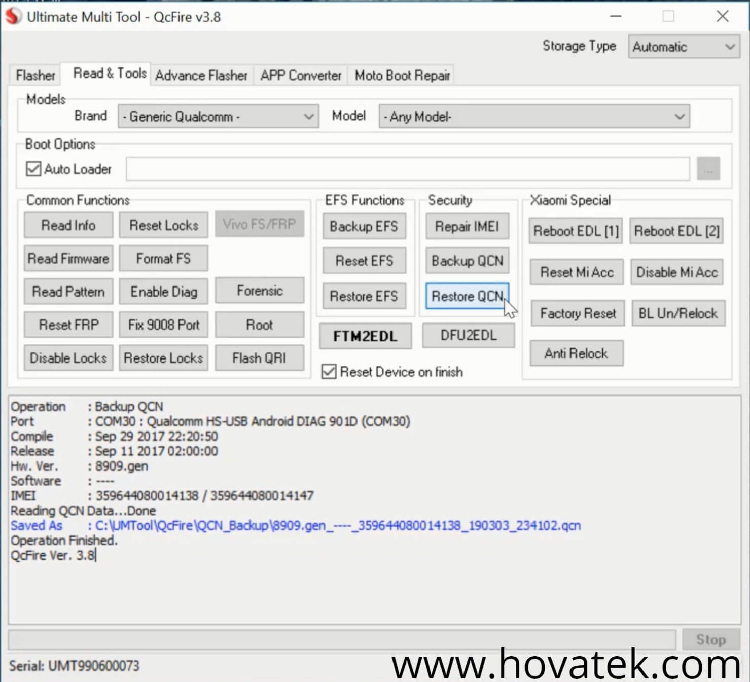

  7. UMT should begin backing up QCN
    [Image: How-to-use-UMT-QcFire-to-backup-and-rest...-QCN-7.jpg]
  8. You should get a Finished message once QCN backup is complete
    [Image: How-to-use-UMT-QcFire-to-backup-and-rest...-QCN-8.jpg]
  9. You should find the QCN backup in the C:\UMTool\QcFire\QCN_Backup directory
    [Image: How-to-use-UMT-QcFire-to-backup-and-rest...-QCN-9.jpg]

  3. In the Diagnostic Port box, select the DIAG port
    [Image: How-to-use-UMT-QcFire-to-backup-and-rest...QCN-12.jpg]
