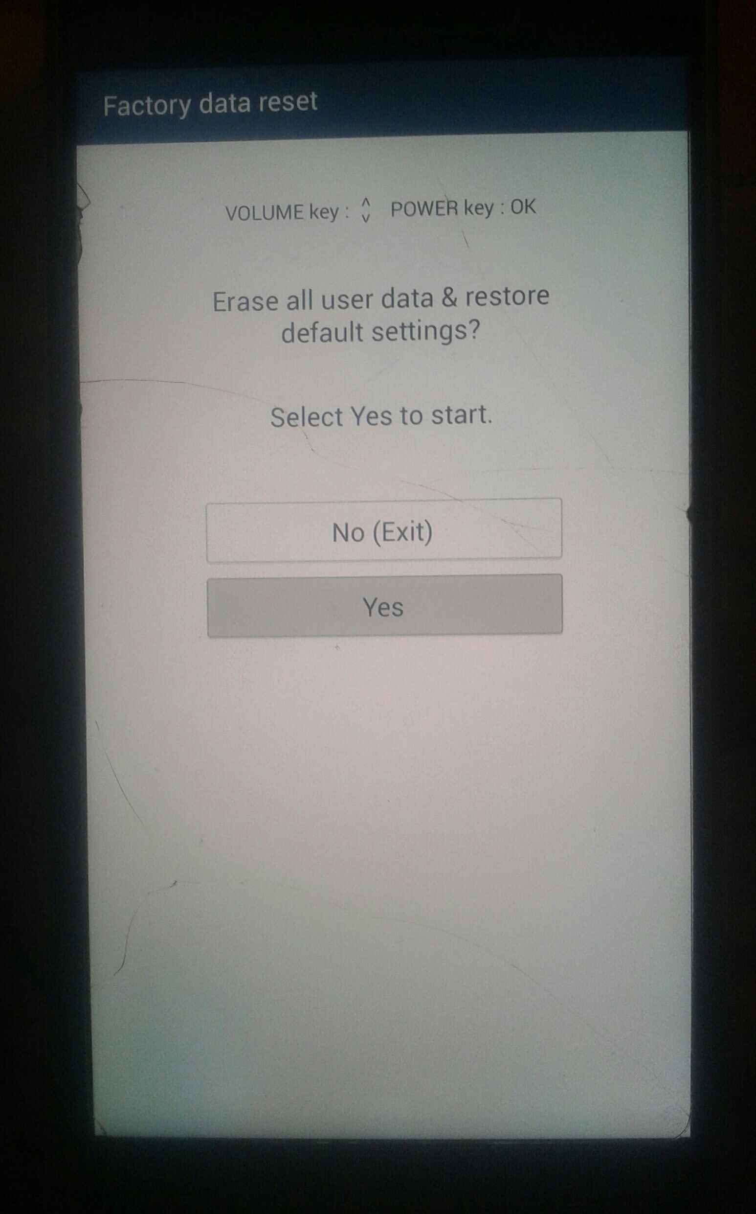

I had once reset to normal mode (reset parameter).
I have access to the recovery mode (vol down + power) but when I click on reset all datas the phone remains blocked for a while and it restarts while restarting the same problem.
I have the impression that it does not reinitialize

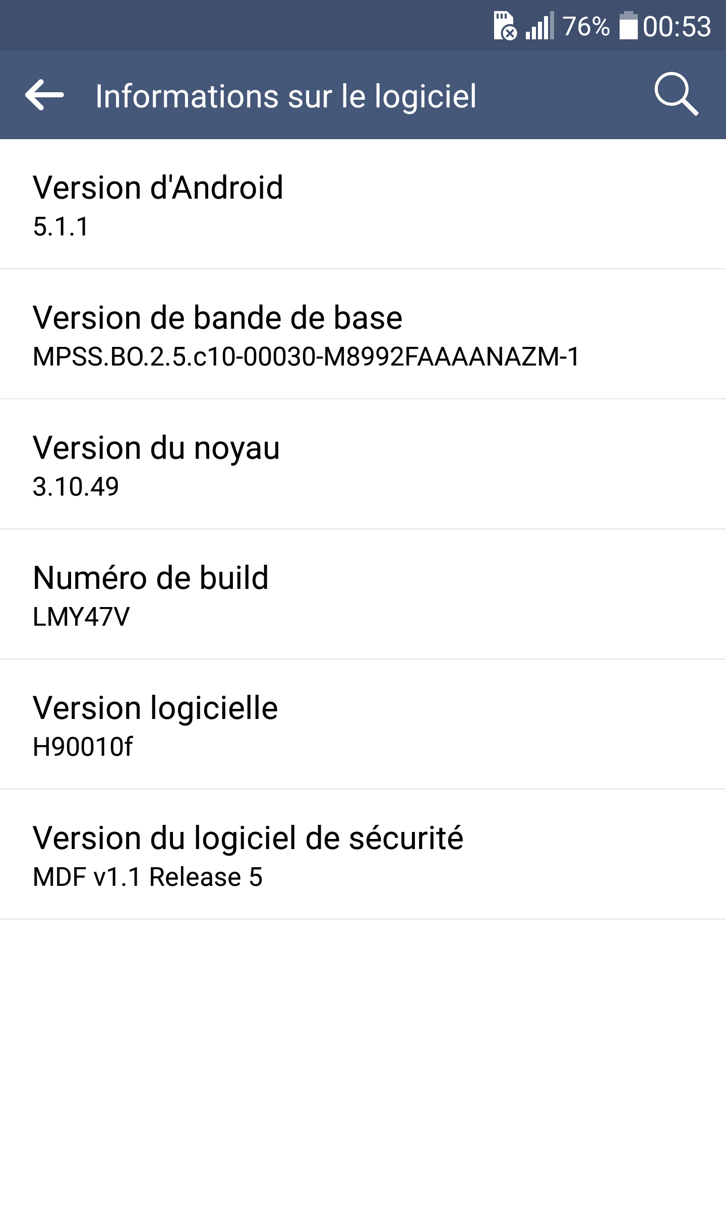

You should consider flashing the stock ROM.
Did you take note of the phone's build no?
Also attach the screenshot of your phone in recovery mode.

(28-02-2019, 08:59 AM)innagee
(28-02-2019, 12:00 AM)Mcoul15 I had once reset to normal mode (reset parameter).
how to flash T&T ?
I didn't take note phone's build

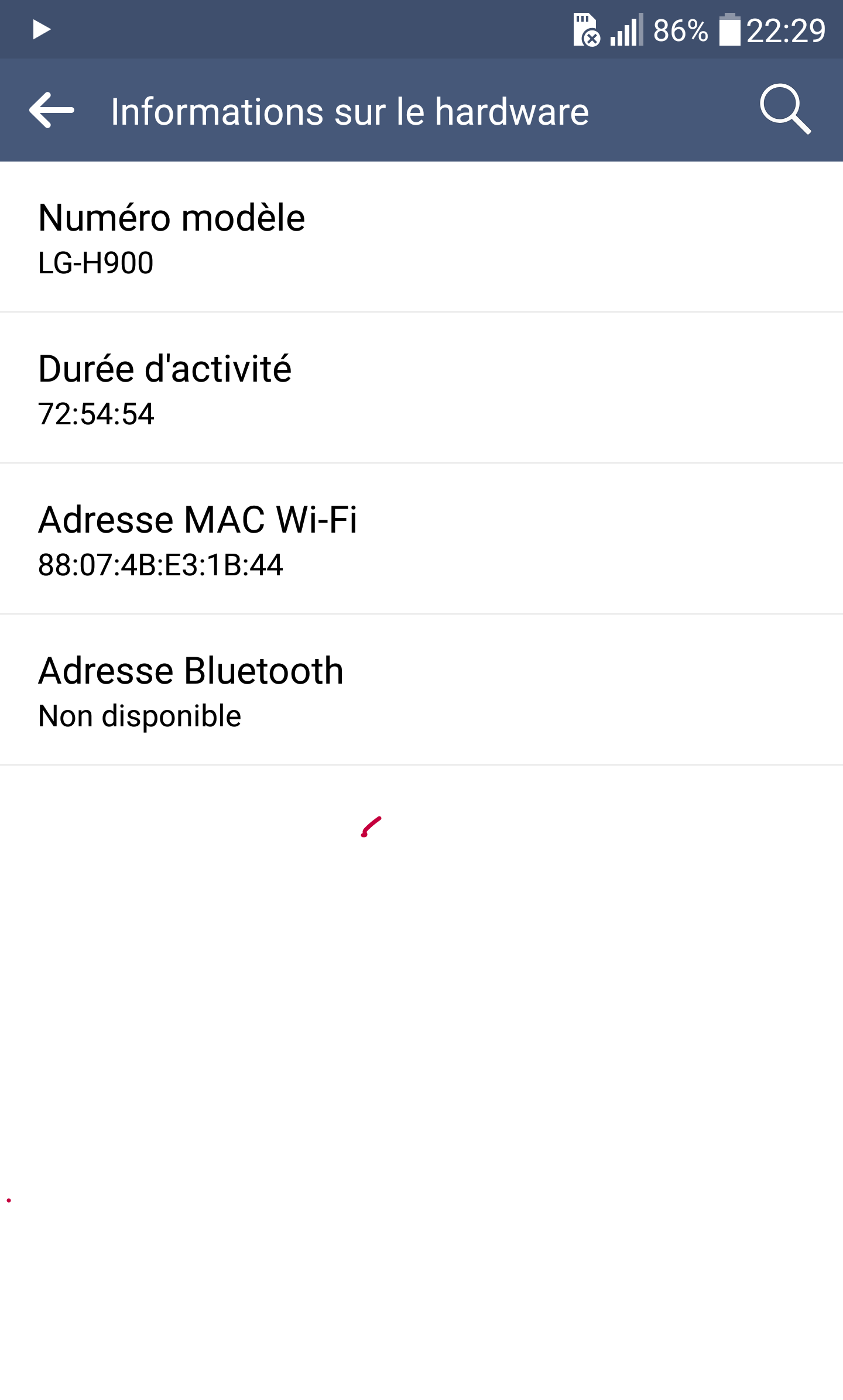

whats the full model of your phone? LG V10 H900? or something else
check what model isĀ indicated on the motherboard or the stick just beneath the battery

(28-02-2019, 05:42 PM)freshtyt
(28-02-2019, 03:03 PM)Mcoul15 how to flash T&T ?
It's LG-H901

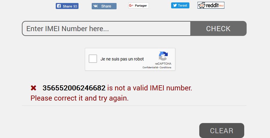

I'm not able to cheik my IMEI

(06-03-2019, 03:37 AM)Mcoul15 I'm not able to cheik my IMEI
now i noticed you have ATT, ATT hosts their firmwares on their server. you can try contacting their support team or check the ATT forum if they'll send the firmware link
also ensure to properly verify the model of your phone, i cant find amy such ATT H901, there's only ATT H900 or TMO H901
