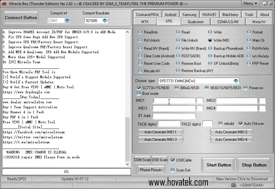

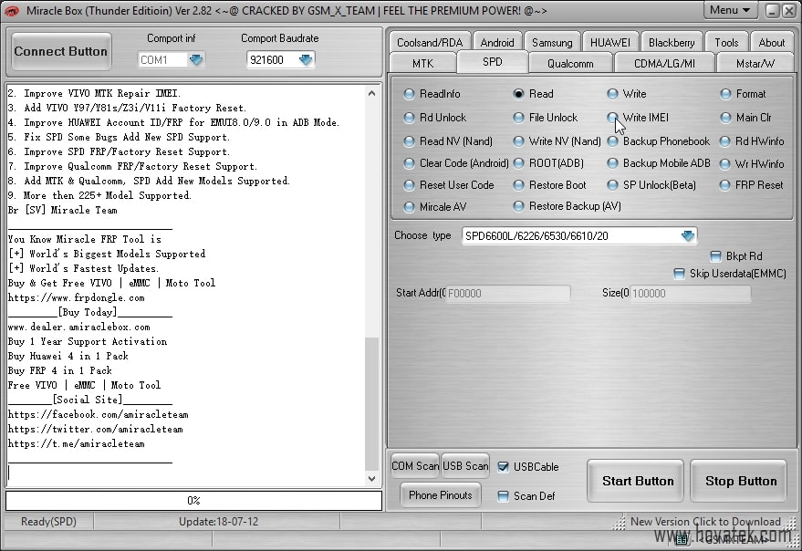

  3. Click the SPD tab
    [Image: How-to-use-Miracle-box-to-write-IMEI-to-...roid-3.jpg]
  4. Tick the check box beside write IMEI
    [Image: How-to-use-Miracle-box-to-write-IMEI-to-...roid-4.jpg]

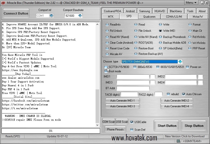

  5. Select the phone's chipset type from the drop down bar
    [Image: How-to-use-Miracle-box-to-write-IMEI-to-...roid-5.jpg]
  6. Tick the check box beside your phone's chipset type

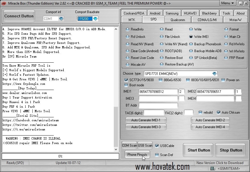

  7. Input the original IMEI into IMEI 1 & 2 boxes
    [Image: How-to-use-Miracle-box-to-write-IMEI-to-...tton-2.jpg]

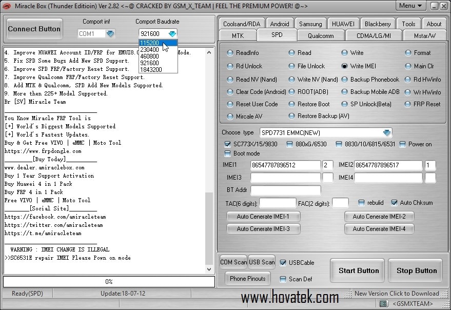

  8. This step is optional, If you get an error about changing baudrate when you click the Start button then return back to this step to try other baudrates
    [Image: How-to-use-Miracle-box-to-write-IMEI-to-...tton-3.jpg]

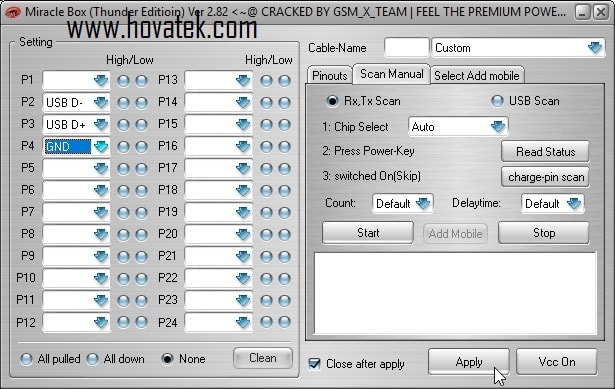

  9. Click Phone Pinouts
    [Image: How-to-use-Miracle-box-to-write-IMEI-to-...tton-4.jpg]
  10. In the new window, set the values as follows then click 'Apply'
    P1: leave_blank P2: USB D- P3: USB D+ P4: GND
    [Image: How-to-use-Miracle-box-to-write-IMEI-to-...tton-5.jpg]

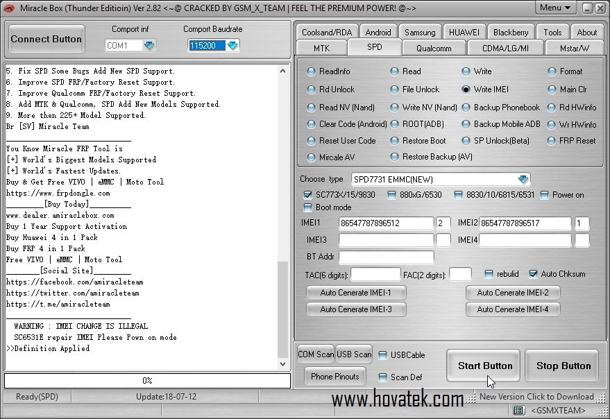

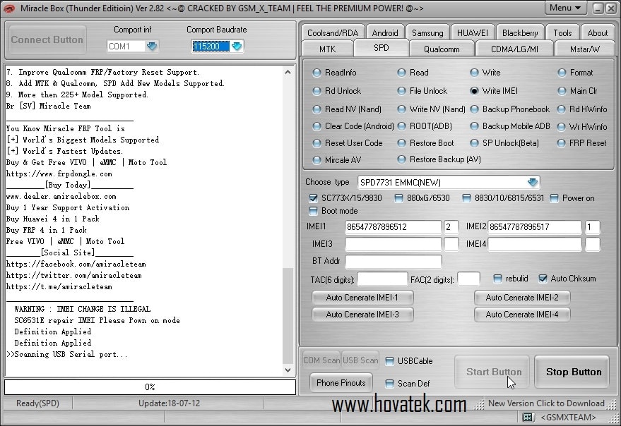

  11. Click Start
    [Image: How-to-use-Miracle-box-to-write-IMEI-to-...tton-6.jpg]
  12. You should now see >>> Scanning USB Serial port... . At this point, switch off the phone still with battery inserted then connect it to the PC via USB cord without holding any button

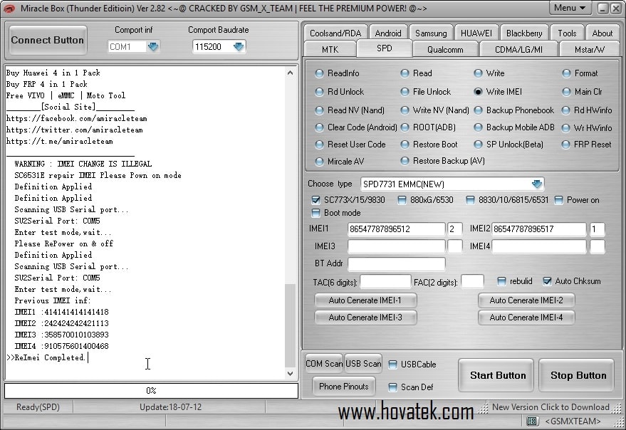

  13. The phone should get detected and you should now see >>> Enter test mode,wait...
  14. Once the process is complete, you should see 'ReImei Completed'

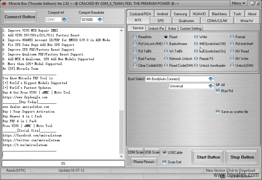

  1. Launch Miracle box
    [Image: How-to-use-Miracle-box-to-write-IMEI-to-...roid-1.jpg]
  2. On Miracle box interface, press Control + M to enable IMEI
    [Image: How-to-use-Miracle-box-to-write-IMEI-to-...roid-2.jpg]

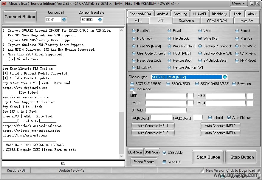

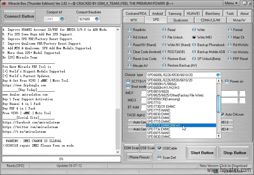

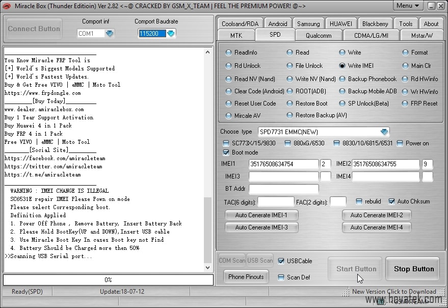

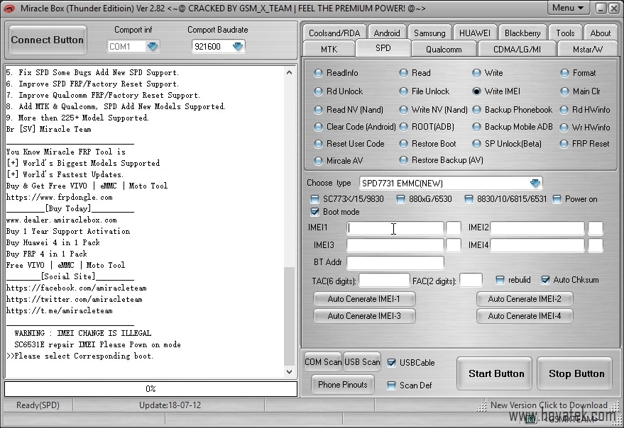

  6. Tick the check box beside 'Boot mode'
    [Image: How-to-use-Miracle-box-to-write-IMEI-to-...roid-6.jpg]

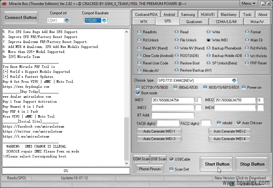

    [Image: How-to-use-Miracle-box-to-write-IMEI-to-...roid-7.jpg]
    [Image: How-to-use-Miracle-box-to-write-IMEI-to-...roid-8.jpg]
  9. Click Start
    [Image: How-to-use-Miracle-box-to-write-IMEI-to-...roid-9.jpg]

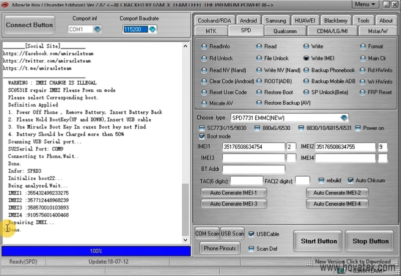

  10. You should now see >>> Scanning USB Serial Port... . At this point, switch off the phone then connect it to the PC via USB cord while holding volume down button
    [Image: How-to-use-Miracle-box-to-write-IMEI-to-...oid-10.jpg]
  11. The phone should get detected and IMEI writing should begin
  12. Once the process is complete, you should see 'Done'
