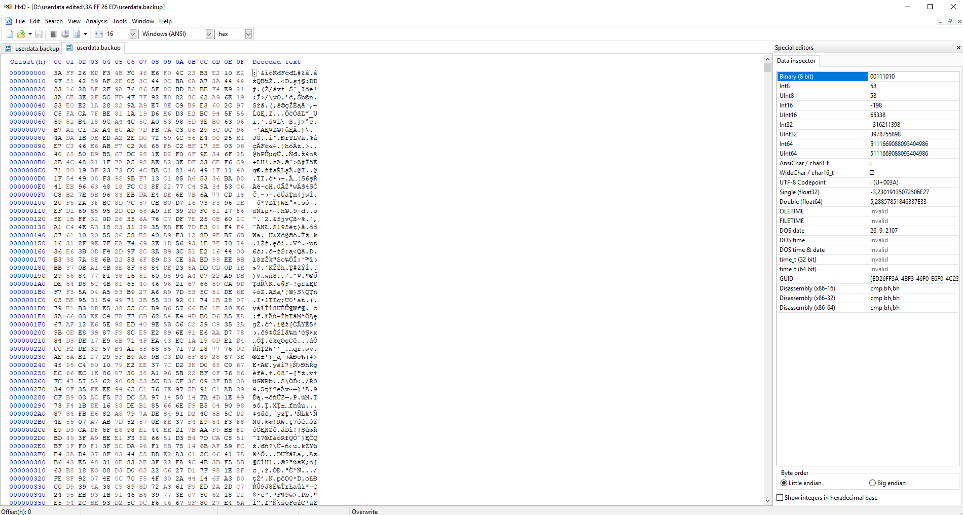

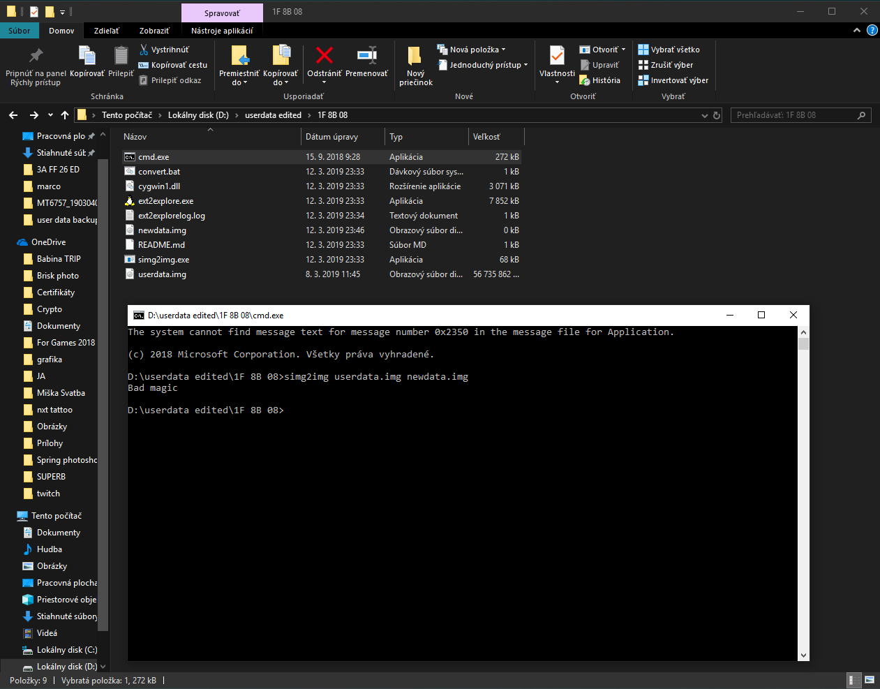

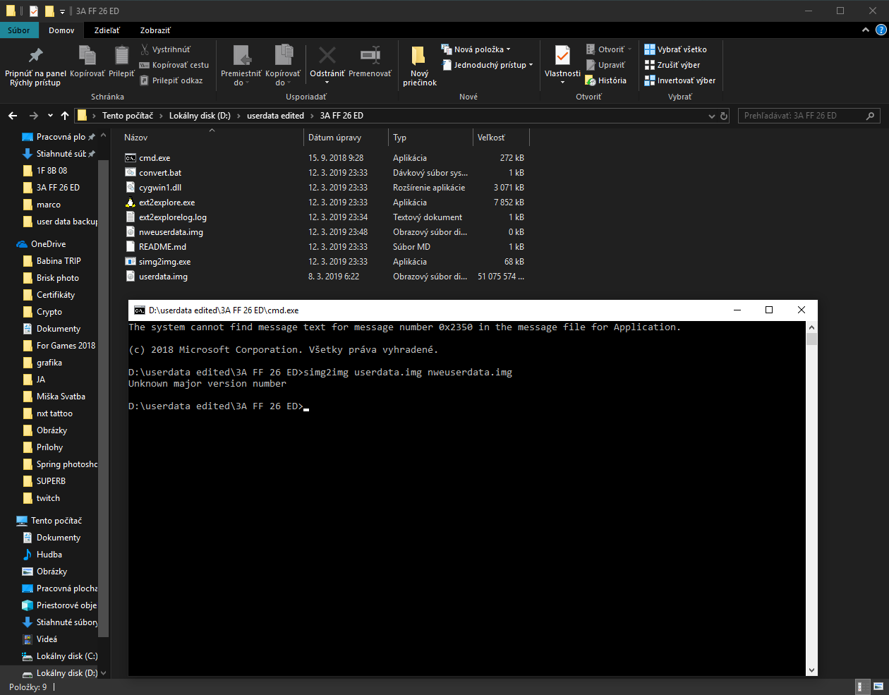

ok attaching photos.
1.simg2img preview after trying convert edited backup file with deleted all before 3A FF 26 ED
2.simg2img preview after trying convert edited backup file with deleted all before 1F 8B 08
3.Photo how edited file1 look in hxd
4.photo how edited file2 look in hxd

(12-03-2019, 11:56 PM)alfaomega ok attaching photos.
seems something's wrong with these files. try flashing back your entire miracle box dump back to your phone
let me know if the phone boots to the locked screen
