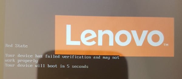

Unfortunately, I got the same result using the 'Ctrl + Alt + V'  -> “Write memory” Method
[Image: attachment.php?aid=6014]
I noticed one interesting thing. When reverting back to the original boot image I also used the 'Ctrl + Alt + V'  -> “Write memory” Method. In this case I ended up in a boot loop without the above message only the Lenovo logo was on the screen. Flashing the original boot image via “Download” had recovered the device.

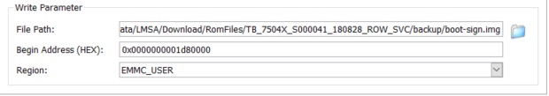

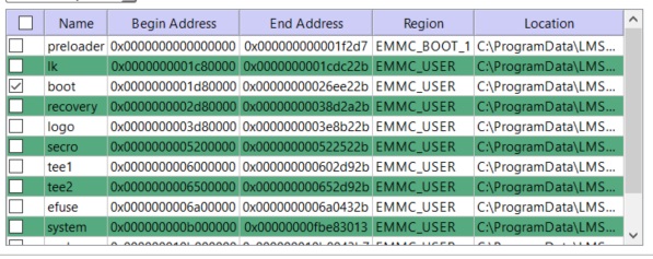

12-01-2019, 09:03 PM
(12-01-2019, 07:46 PM)hovatek After flashing the stock boot using sp flash tool (and unbricking), try flash the stock boot-sign.img using Advanced mode and let me know what happens
The tablet was starting normal than I flashed the stock boot-sign.img using advanced mode: Same bootloop without the message just the logo.
I used this settings:
[Image: attachment.php?aid=6016]
[Image: attachment.php?aid=6015]
