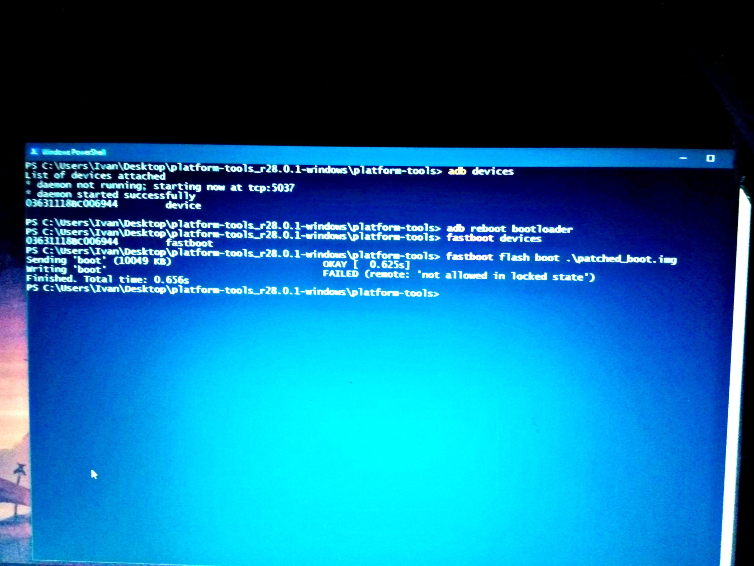

for SP flash tool, what's the error message? [attach a screenshot]

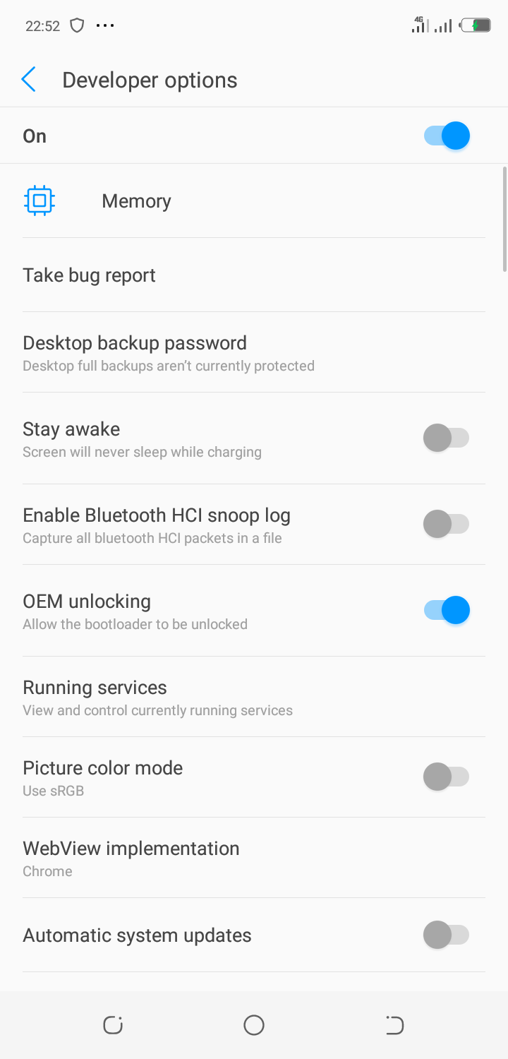

I tried and got the Google packages listed. They worked for fastboot but I got the error. I don't know why. I did enable unlock oem.

(24-12-2018, 08:56 PM)lizoan I tried and got the Google packages listed. They worked for fastboot but I got the error. I don't know why. I did enable unlock oem.
That error means your bootloader is still locked.
Refer to https://www.hovatek.com/forum/thread-19578.html
