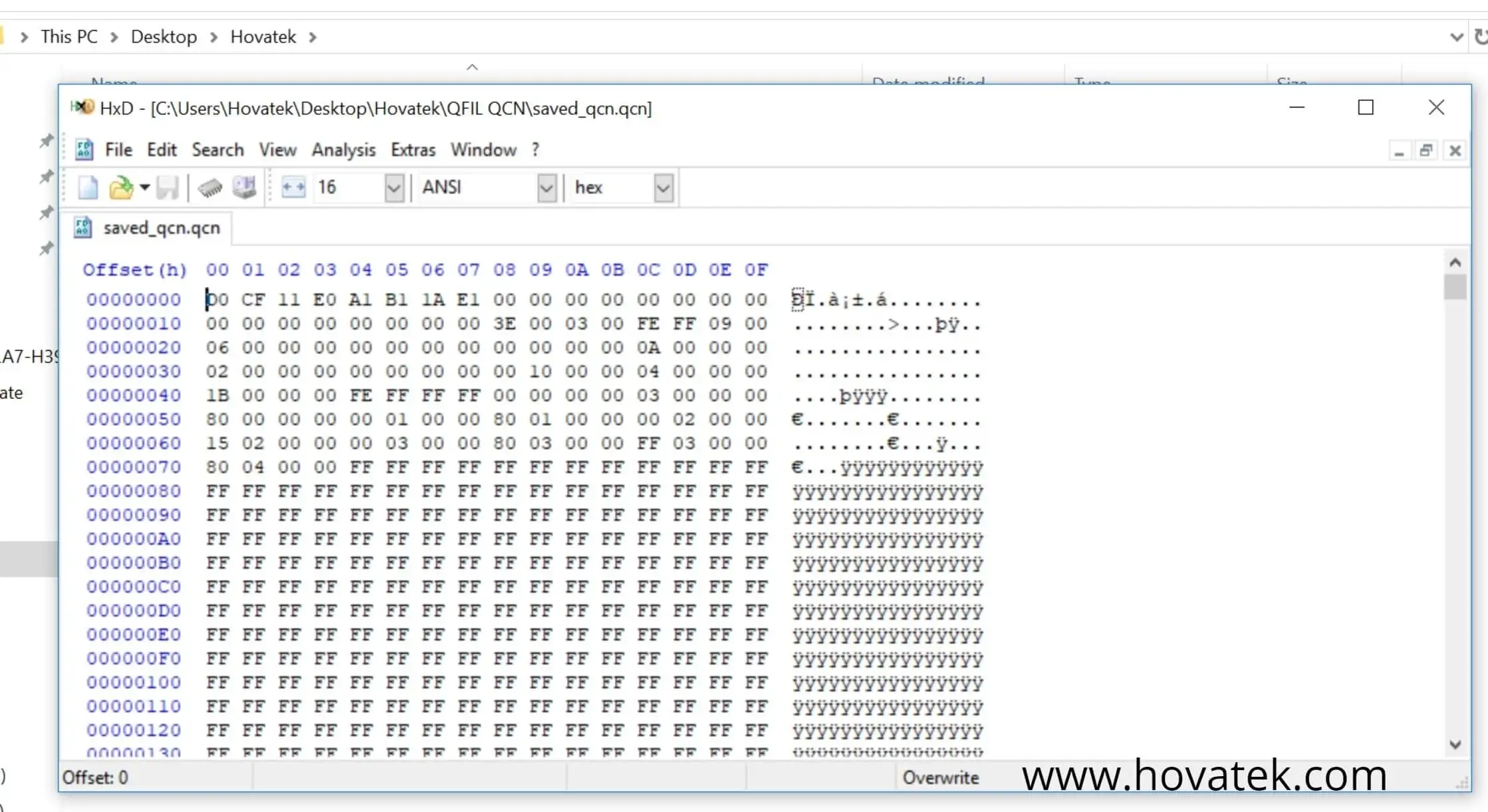

  4. HXD should load the file and display its contents
    [Image: write-IMEI-to-Qualcomm-using-QFIL-QCN-4.webp]

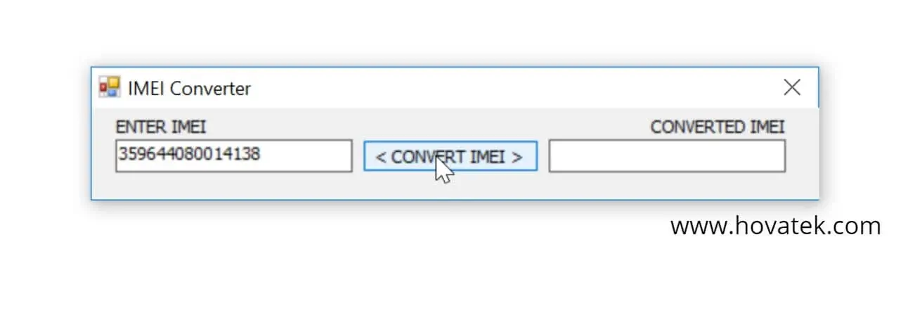

  5. Launch IMEI converter
    [Image: write-IMEI-to-Qualcomm-using-QFIL-QCN-5.webp]
  6. Enter the IMEI of the phone the QCN backup was made from then click Convert IMEI.
    [Image: write-IMEI-to-Qualcomm-using-QFIL-QCN-6.webp]

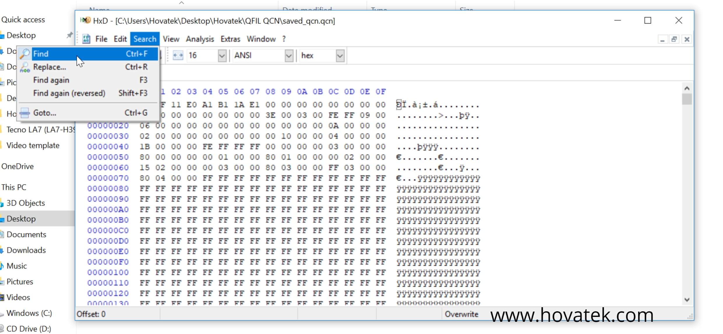

  8. Go back to Hex Editor. Click Search > Find
    [Image: write-IMEI-to-Qualcomm-using-QFIL-QCN-8.webp]

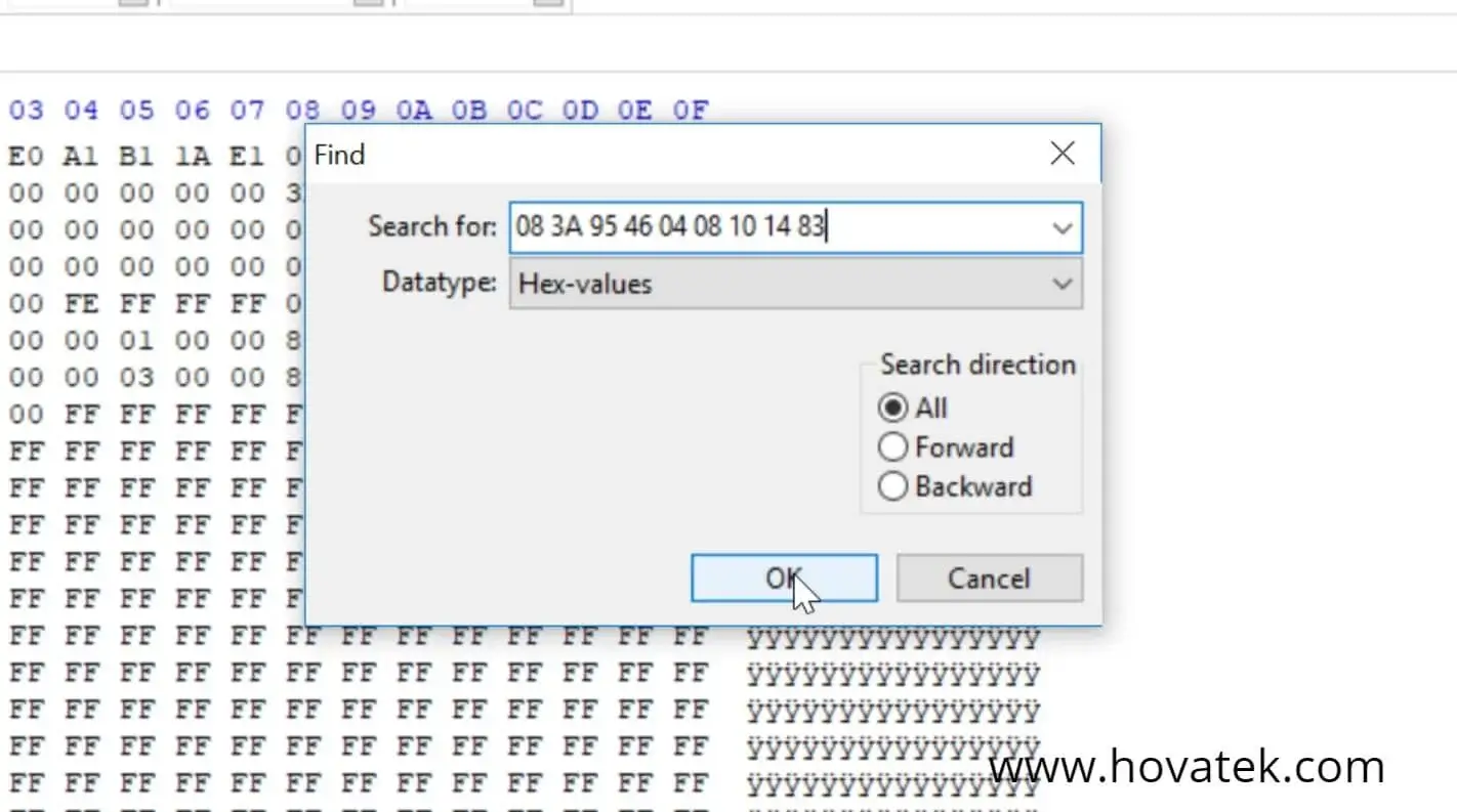

  9. Enter the HEX under Search for, set Data-type to Hex-values then click OK
    [Image: write-IMEI-to-Qualcomm-using-QFIL-QCN-9.webp]

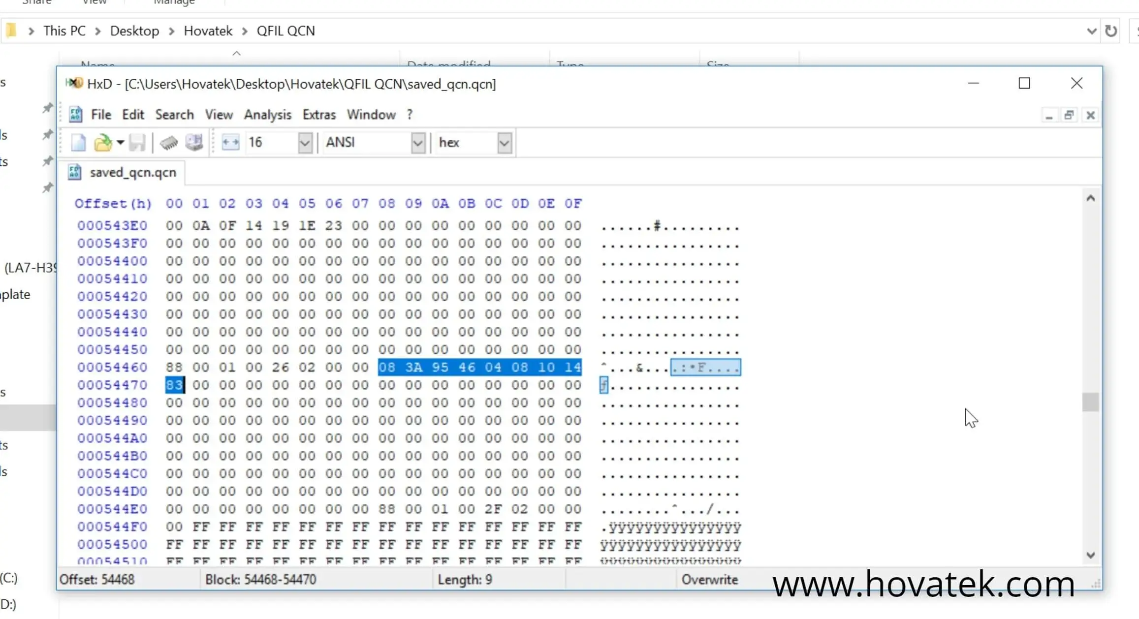

  10. You should now see what you're to edit to change the IMEI
    [Image: write-IMEI-to-Qualcomm-using-QFIL-QCN-10.webp]

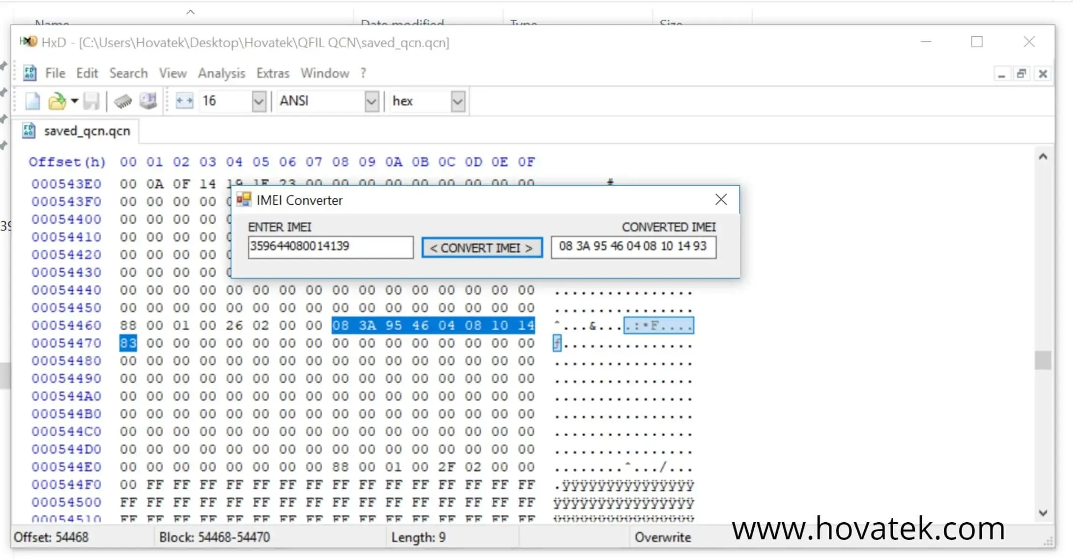

  11. Go back to IMEI converter, enter the IMEI you wish to write (your own IMEI) then copy the converted IMEI (in HEX format)
    [Image: write-IMEI-to-Qualcomm-using-QFIL-QCN-11.webp]

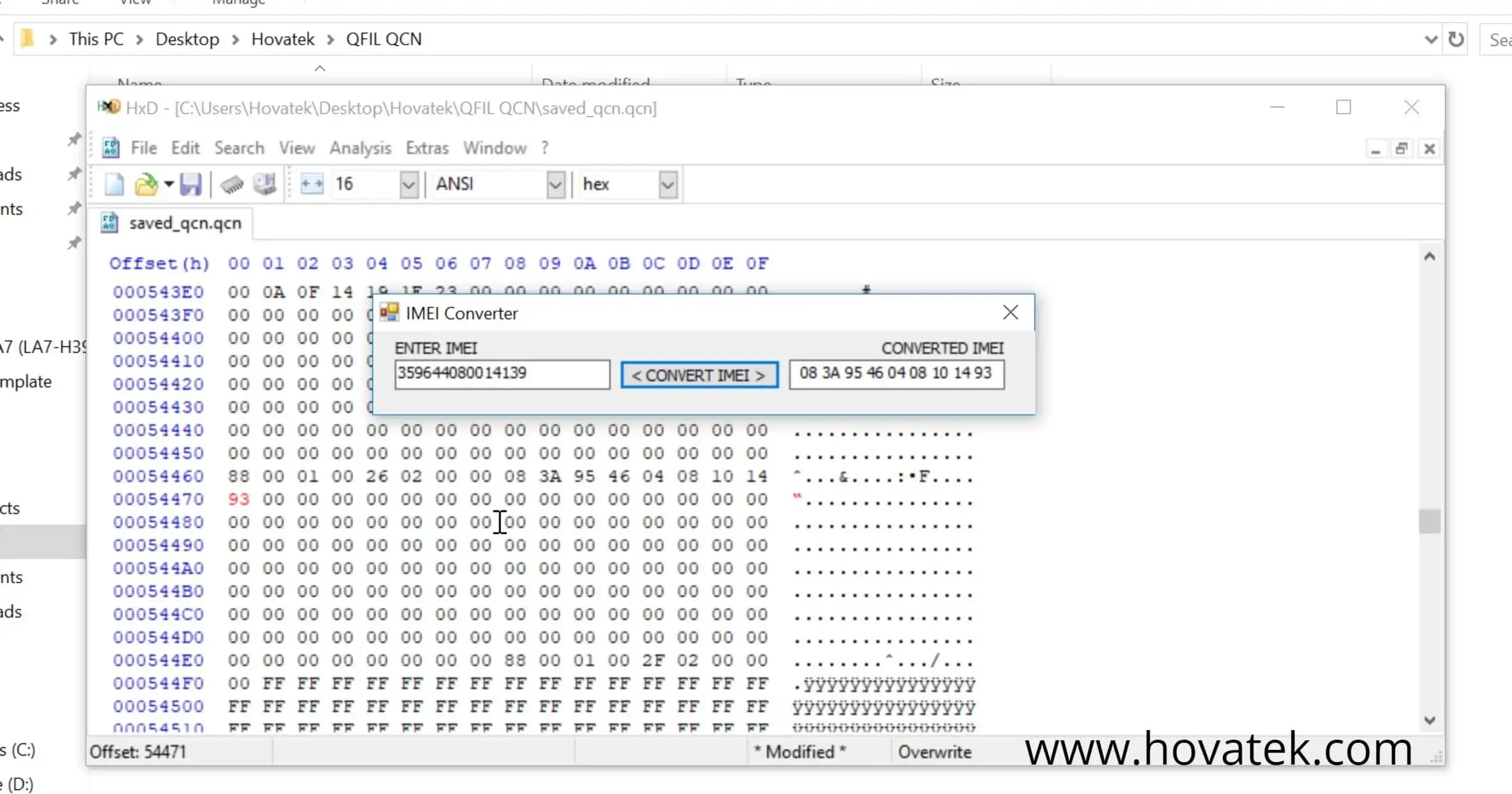

  12. Back in HXD, replace the HEX (you'd searched for) with the HEX of your IMEI then save
    [Image: write-IMEI-to-Qualcomm-using-QFIL-QCN-12.webp]

sir when i find converted imei number in hex its showing cant find plzz help sir

(27-09-2019, 05:31 PM)Jaspritsingh parmar sir when i find converted imei number in hex its showing cant find plzz help sir
already replied to @ https://www.hovatek.com/forum/thread-30254.html
