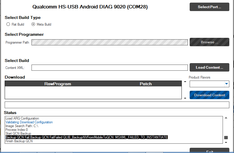

i followed the detailed step, but am unable to back up qcn of my inifinx x6233
the error message is in the screenshot

This is the error message from the Qfil while trying to back up my phone qcn

Pls someone help
29-04-2019, 12:01 PM
(27-04-2019, 05:33 PM)Noblex i followed the detailed step, but am unable to back up qcn of my inifinx x6233
create a new thread for your device issue

(27-04-2019, 05:38 PM)Noblex This is the error message from the Qfil while trying to back up my phone qcn
hello, please were you able to solve this error? and how did you...cos I'm having the same problem.
21-07-2021, 02:00 PM
(20-07-2021, 05:54 PM)temmiecool
create a new thread for this by clicking "ask question" at the top
in the new thread, state the device model and how you enabled diag mode
