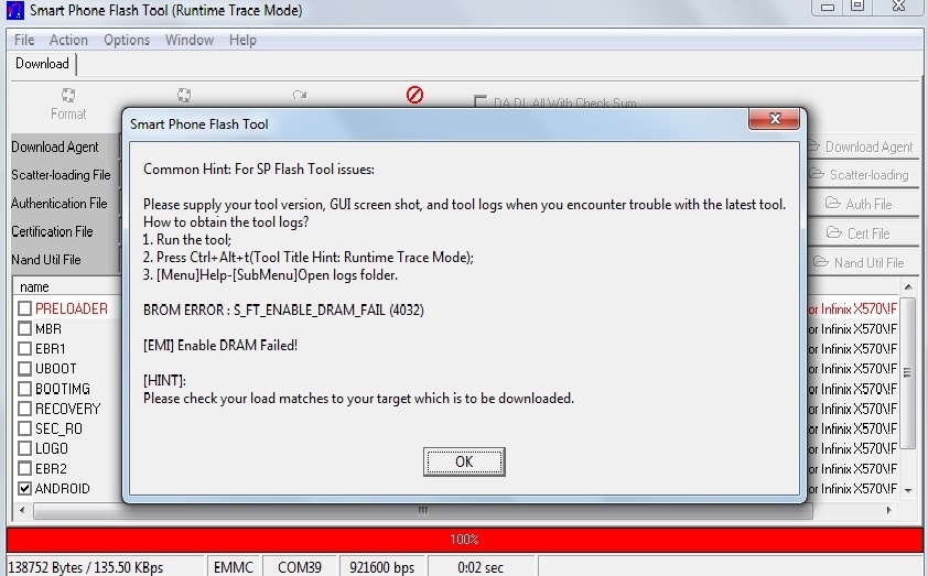

(19-04-2015, 11:51 PM)ehijiele1 @Hovatek thanks for responding. No I couldnt I got this error message. "BROM ERROR:S_FT_ENABLE_DRAM_FAIL (4032)".
please, cross-check the stock backup you have to be sure its for x570 and not x507
..waiting

@Hovatek Yes I did, It gave me this error message
"BROM ERROR S_DL_GET_DRAM_SETTINGS_FAIL"

(20-04-2015, 04:46 PM)ehijiele1 @Hovatek Yes I did, It gave me this error message
whats the error code and the hint at the bottom

(20-04-2015, 06:53 PM)hovatek
Kindly find attached the correct error message i received please>
50,949
26-04-2015, 02:37 AM
#15
(26-04-2015, 12:02 AM)ehijiele1 Kindly find attached the correct error message i received please>
thats a mismatch error. check the stock rom you downloaded from us, whats the file name?

(26-04-2015, 02:37 AM)hovatek
I hope that's not too serious?
It was in a compressed rar file named "!Files_to_FlashTool" inside it was "[Hovatek] Stock backup (MTK) for Infinix X570"
I use an Infinix X570, it should be the same model.
50,949
27-04-2015, 08:52 AM
#17
(26-04-2015, 10:42 PM)ehijiele1 I hope that's not too serious?
uninstall & reinstall drivers using https://www.hovatek.com/forum/thread-567.html then try using sp flash tool version 5.
