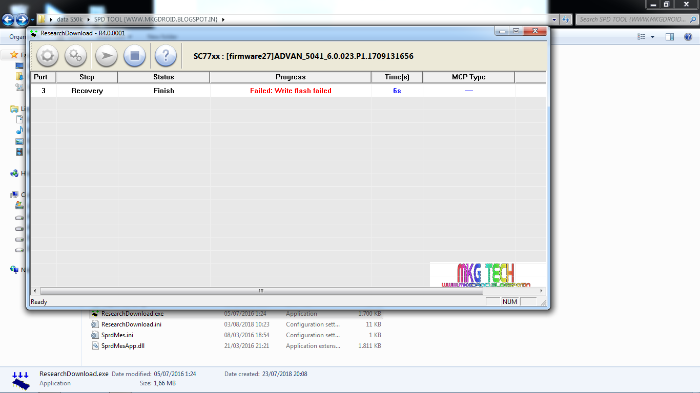

07-08-2018, 04:19 AM
#12
nothing shown
it jast empty, not "0" neither "1"
still stuck like before
here my screenshot
https://drive.google.com/file/d/1i1pQgaX...p=drivesdk
I can flash unchanged original .pac file normally, succesfully, without error
anyway, thanks so much for your advice
Dikirim dari 5041 menggunakan Hovatek Mobile
51,003
07-08-2018, 02:18 PM
#13
(07-08-2018, 04:19 AM)allfiant nothing shown
here my screenshot
Your SPD must have some kind of verified boot + restricted bootloader commands.
Use the .PAC's Uboot.bin / Fdl2.bin to search for any hidden commands as explained @ https://www.hovatek.com/forum/thread-21403.html
