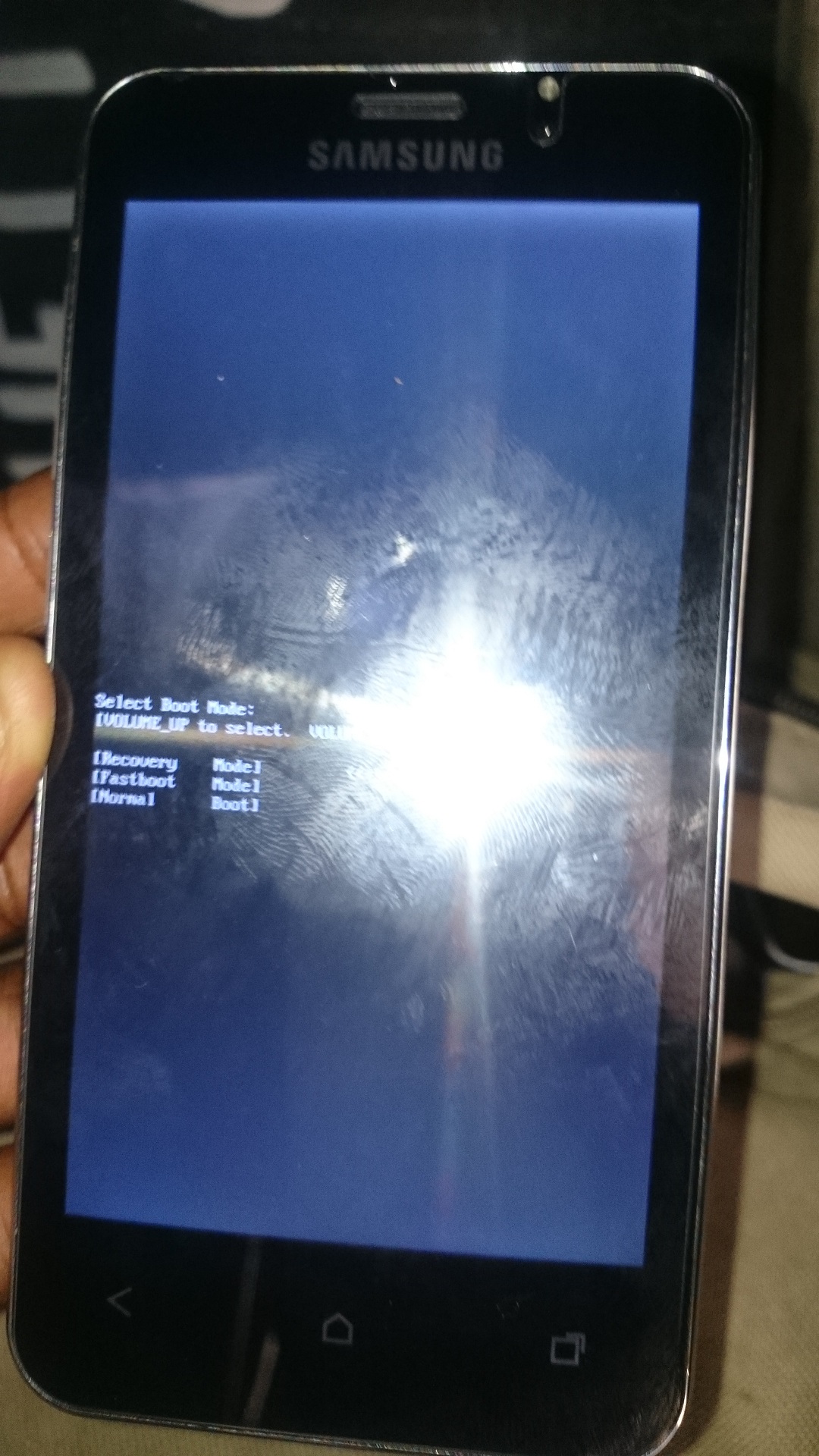

Thanks X3non , but let me show you what happen when i try recovery, fastboot... please see the picture. i can't acces any of them, phone stay at this point and still vibrating by himselt.

21-04-2018, 04:03 PM
(20-04-2018, 07:16 PM)Raphi07
(20-04-2018, 06:21 PM)X3non
(20-04-2018, 04:52 PM)Raphi07 it's not booting to recovery mode , after volum - and power, just asking my choice but when i choice nothing happen, phone still vibrating and when i remove and put the battery phone on with black screen and after few sec reboot like a bootloop
the MT6571 rom at needrom is the same as the one you tried
after flashing the rom, you are to perform a factory reset and seeing as you can't boot into recovery mode, try booting into factory mode instead [factory mode is vol down + power button]
if it doesn't work then try booting into fastboot mode and lets know if you are able to
Reboot the phone and retry the process, scroll down using the vol keys and select recovery mode using power button.
