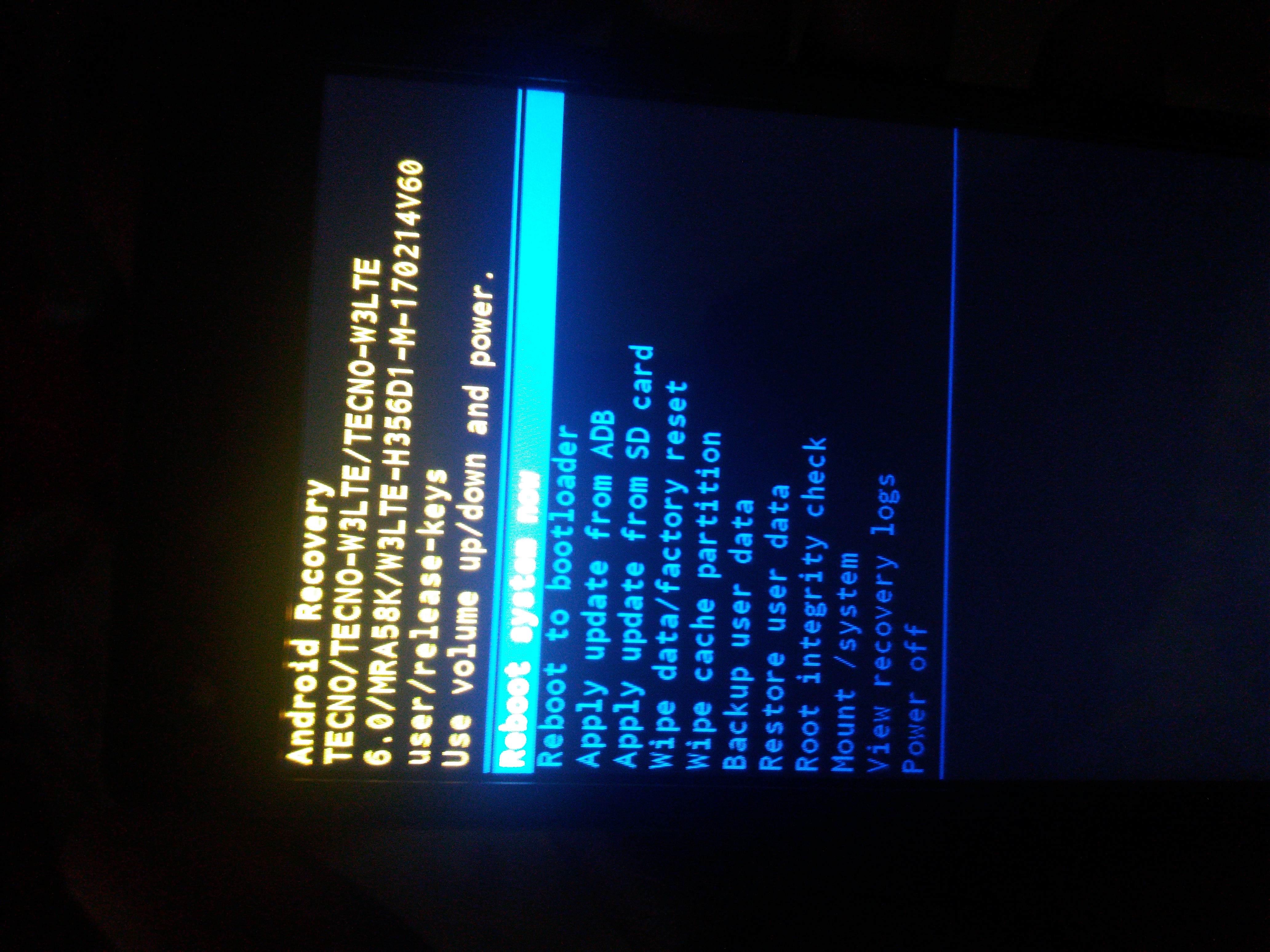

I have tecno W3 lte with frp most known bypass dont work
could you please assist me how and what i can do?
see the picture below
18-04-2018, 01:00 PM
(18-04-2018, 12:05 PM)lymo I have tecno W3 lte with frp most known bypass dont work
Download the scatter file for your exact build @ https://www.hovatek.com/forum/thread-19344.html
then follow the guide @ https://www.hovatek.com/forum/thread-21638.html to format frp partition.
