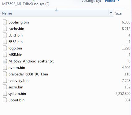

That worked... Now I need the Correct Rom... I've attached the ROM I have aright now...

(20-04-2018, 01:54 PM)Allison.ag That worked... Now I need the Correct Rom... I've attached the ROM I have aright now...
i presume the screenshot you uploaded is the old rom you flashed, look for and try another rom for a different source OR backup the firmware of a working A500s device

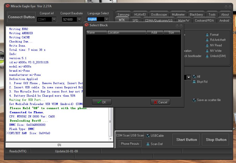

I have identified the main problem... The ROM is not geeting falshed into the phone.
Here's why, I've flashed the phone and it completed successifully, but once I tried reading back the files, it had none, totally none.
What could be the problem and how can it be solved? Sad Sad

(23-04-2018, 10:31 AM)Allison.ag I have identified the main problem... The ROM is not geeting falshed into the phone.
retry the backup process one more time and also try dumping using wwr_tool @ https://www.hovatek.com/forum/thread-21970.html
lets know the outcome of both

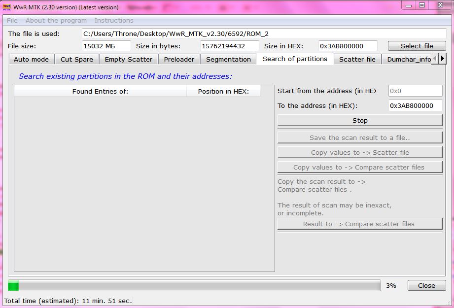

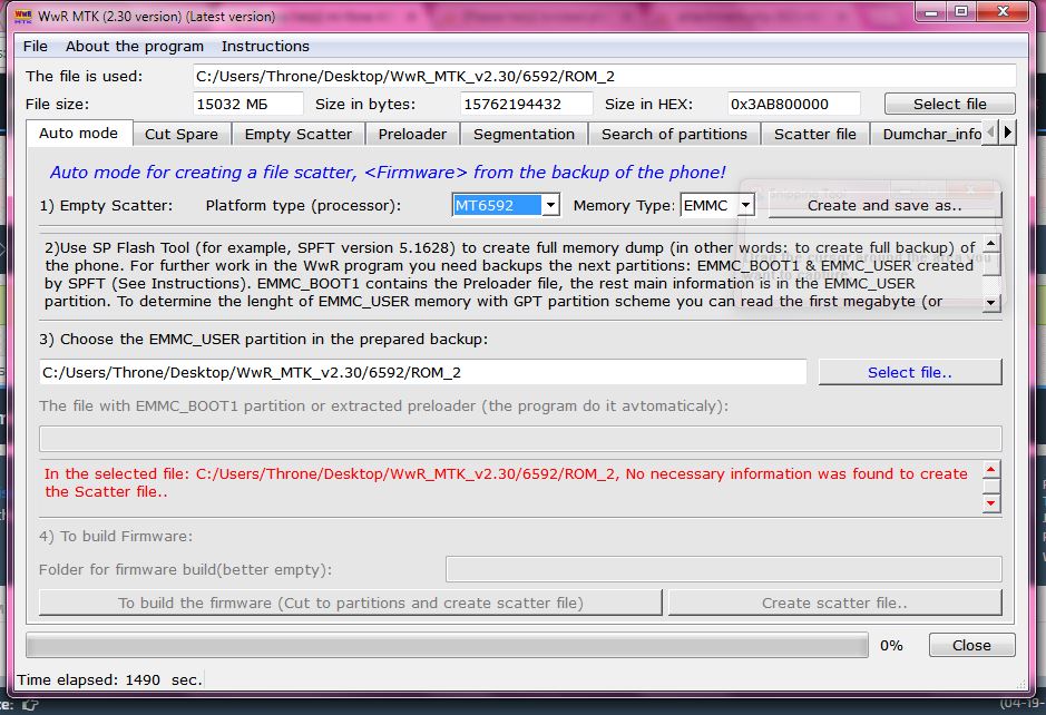

the firt method didnt work...
The second worked on the SP Tool but didnt find any partitions using wwr_tool (took me half a day doing this)

(24-04-2018, 02:07 PM)Allison.ag the firt method didnt work...
attach a screenshot showing wwr_mtk tool not finding any partitions

(24-04-2018, 04:54 PM)Allison.ag
(24-04-2018, 04:07 PM)X3non
That's the screenshot
