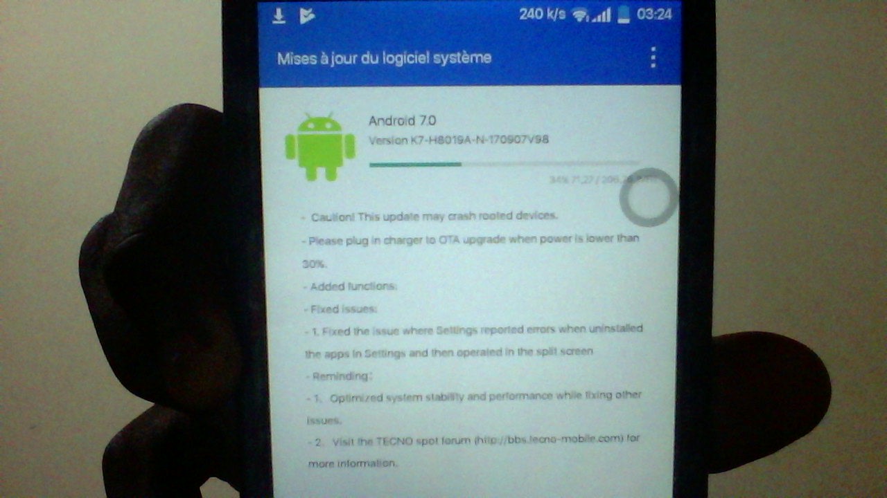

Hello!!!
I own an TECNO Spark K7+. Today I've got an OTA update from V98 to V180. I've tried multiple times to install it but I always end up with an eMMC error stating that eMMC has some unexpected files. In fact, I was rooted with TWRP installed but I've removed both of them before doing that update. I've downgraded the phone to V73 with SP Flash tool. But still getting the same error. I don't know if it means that I would have to repartition my phone cause that's not normal. I've flashed it multiples times but am still getting the same error. Please, tell me what to do.

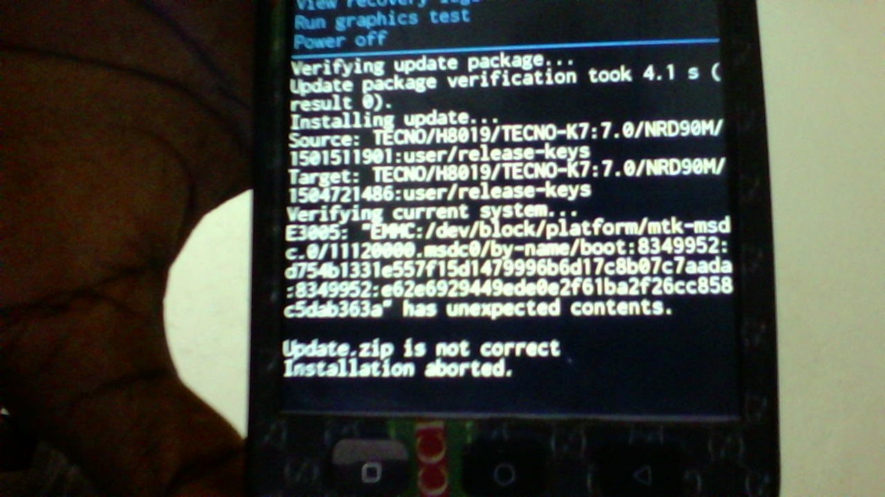

Attach a full screenshot / picture of this error message

Here you have. I have tried everything, even full formating ¨+ Download with SP Flash tool with no luck.

(10-04-2018, 03:16 AM)Espera Awo Here you have. I have tried everything, even full formating ¨+ Download with SP Flash tool with no luck.
It seems like you're trying to install an update.zip file that is incompatible with your device.
Where did you get the update.zip file and how did you know that it is for your exact build?
50,949
10-04-2018, 11:33 AM
(10-04-2018, 03:16 AM)Espera Awo [quote='hovatek' pid='133771' dateline='1523273827']
There's a problem with boot.img.
How did you unroot?
Also answer @innagee's question
This post was last modified: 10-04-2018, 11:34 AM by hovatek.

12-04-2018, 03:26 AM
(10-04-2018, 11:29 AM)innagee
Hello, it's an OTA update. Everytime I connect to WiFi and check for new update, it's pops up in the update menu and it download the update by itself from TECNO. An not trying to flash it, it's an OTA update.

12-04-2018, 03:29 AM
(10-04-2018, 11:33 AM)hovatek
(09-04-2018, 12:37 PM)hovatek Here you have. I have tried everything, even full formating ¨+ Download with SP Flash tool with no luck.
How did you unroot?
That's what I thought first too, reflashed multiple times boot with SP Flash Tool with no success. Even formatted whole device but still getting the error. I don't know how to explain this. I unrooted it by uninstalling Magisk and it's removed root. After formatting, there is no more root, right?

12-04-2018, 11:02 AM
(12-04-2018, 03:29 AM)Espera Awo That's what I thought first too, reflashed multiple times boot with SP Flash Tool with no success. Even formatted whole device but still getting the error. I don't know how to explain this. I unrooted it by uninstalling Magisk and it's removed root. After formatting, there is no more root, right?
Something isn't right...
1. How exactly did you format
2. Did you flash the full firmware and what's the build number of the full firmware you flashed (if you did)
3. Try flashing v158 @ https://www.hovatek.com/forum/thread-20510.html
Another issue could be that source (update.zip) is older than target
