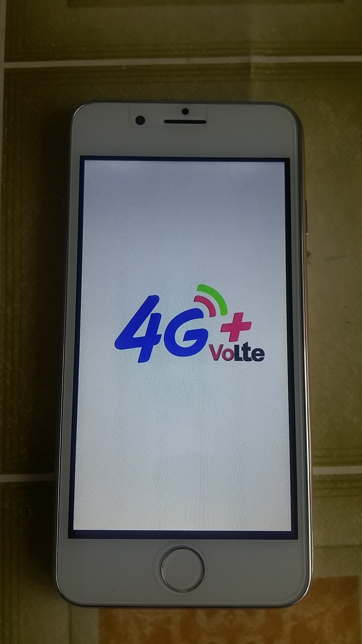

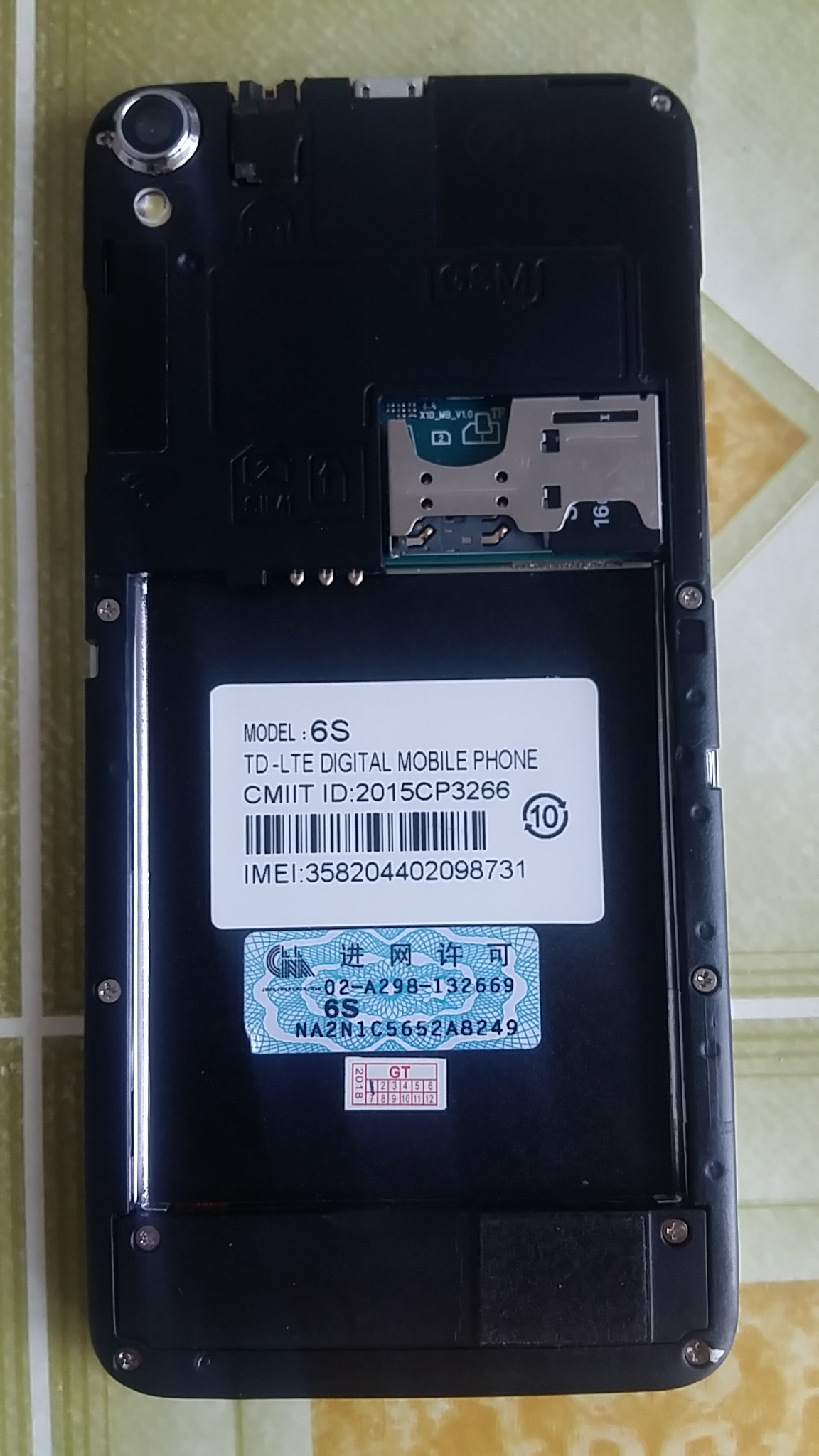

Hello!
I have a problem my device is stock at bootloop,cant find a way to fix it,Pc does not show it in device manager nor offering any drivers to install,when i connect it to pc in off state it just charges,tried also vol +/- home,power buttons etc..nothing,any solutions will be apreaciated Huh

(31-03-2018, 03:21 PM)Aidzis Hello!
how did the device get stuck at bootloop in the first place?
and have you tried doing a factory reset in recovery mode?

(31-03-2018, 07:15 PM)X3non
Seems i messed up the vold.fstab file,cant get in to recovery tried all possible button combinations

(01-04-2018, 10:54 AM)Aidzis Seems i messed up the vold.fstab file,cant get in to recovery tried all possible button combinations
1. You've not told us how the phone got stuck in a bootloop in the first place.
Also, do you have the stock rom?
2. Launch device manager then connect the phone to the PC while off. Does Device Manager refresh?

(02-04-2018, 11:14 AM)hovatek
I tried to swap memories by editing the vold.fstab file,after that i got bootloop,and device manager didnt refreshed when i connected the phone,so i havent searched any roms,because no use of them if phone could not be detected

(02-04-2018, 02:27 PM)Aidzis I tried to swap memories by editing the vold.fstab file,after that i got bootloop,and device manager didnt refreshed when i connected the phone,so i havent searched any roms,because no use of them if phone could not be detected
hold vol down button before connecting to the PC then check device manager

(02-04-2018, 05:29 PM)X3non
Already tried that,still nothing

(02-04-2018, 07:22 PM)Aidzis Already tried that,still nothing
try a different usb cord or PC
what button combo did you use to attempt booting into recovery mode?
and did you make any backup before modifying the vold file?

(02-04-2018, 09:24 PM)X3non
Ill try another Pc when i get the chance,for recovery tried vol +/- +power button then vol +/- + home + power  then all together,still no luck,havent maded any backup

1st problem : USB data connection not working
2nd problem : Hang on Logo
solution 1: Check USB connector, PC port, at last replace USB connector.
solution 2: If connection is OK, then backup or read phone's firmware. Extract and find build.prop form system.img from backup firmware and see ro.build.version and search at GOOGLE or tell us here.
solution 3: For searching for firmware, you can search by BoardID on circuit.
NOTE : If connection is OK but you cannot read/backup firmware, check hardware error, may be eMMC damaged.
