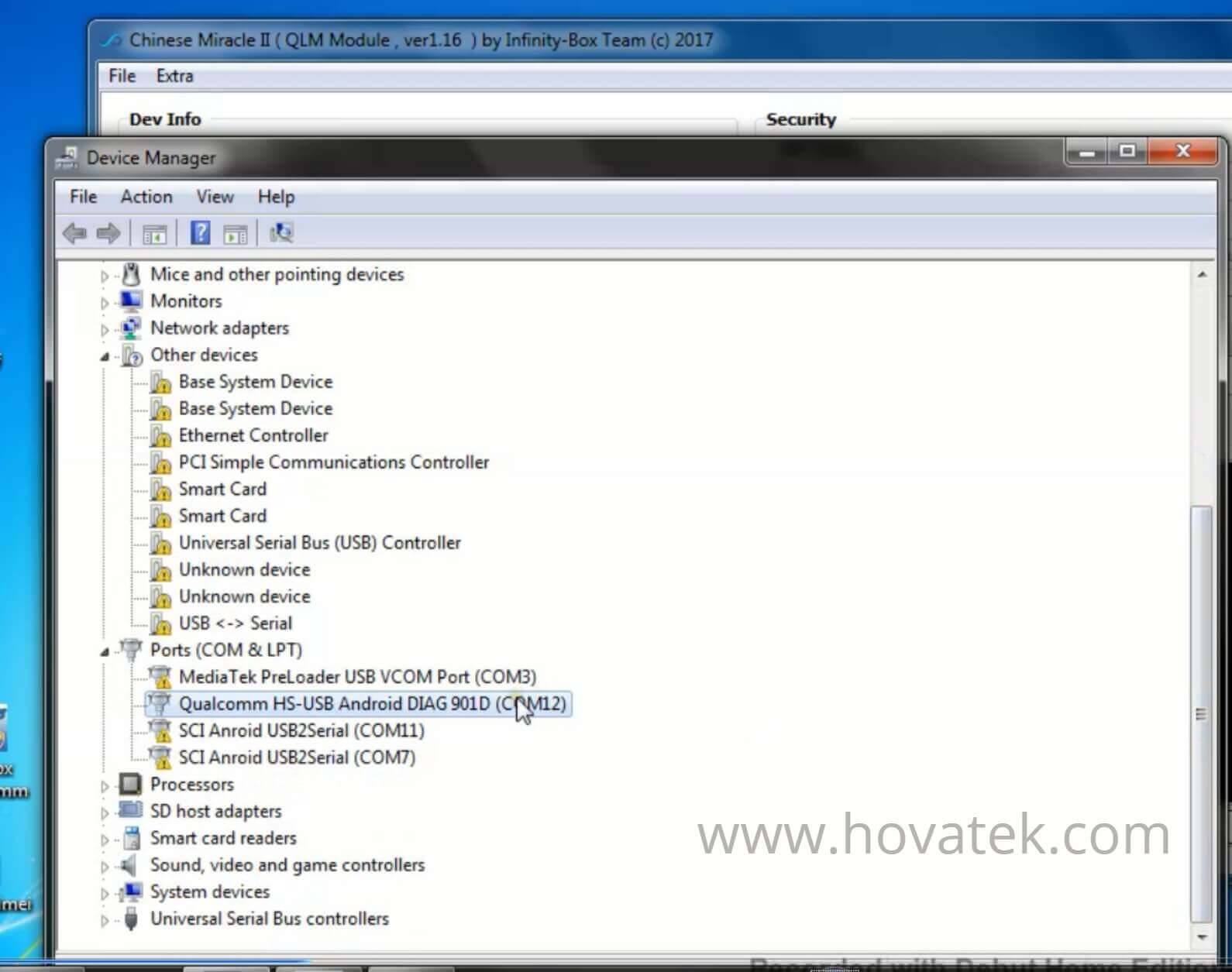

  • Connect the phone to the PC (via a USB cord) while powered on with Diag Mode enabled. You should have an entry like Qualcomm HS-USB Android DIAG 901D in device manager
    [Image: How-to-backup-write-QCN-to-a-Qualcomm-An...-QLM-1.jpg]

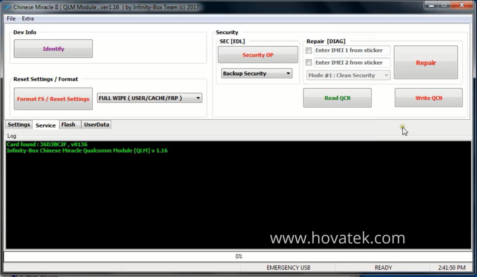

  • Launch Infinity Box CM2 QLM
    [Image: How-to-backup-write-QCN-to-a-Qualcomm-An...-QLM-2.jpg]

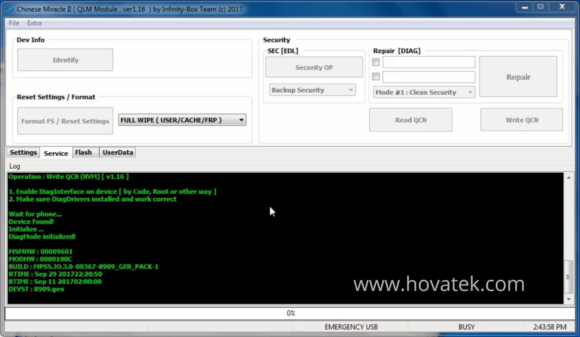

  5. QCN write should begin, Do Not interrupt
    [Image: How-to-backup-write-QCN-to-a-Qualcomm-An...QLM-11.jpg]
