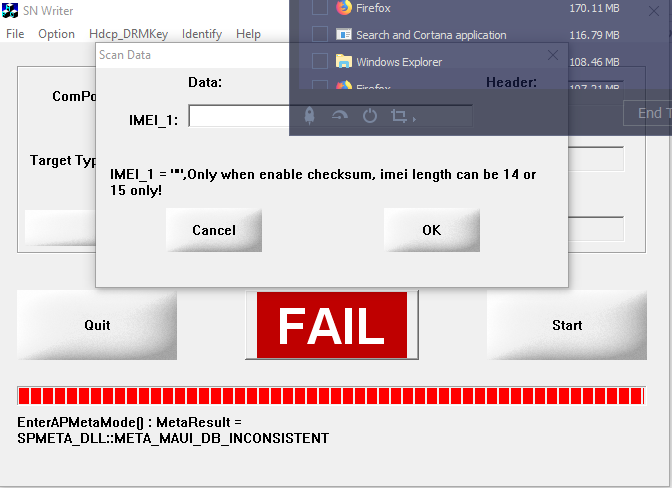

My MAC adress changes at every reboot, so i always have the nvram error when i turn wifi onUndecided
How do I prevent my MAC address from changing, or how can i assign a permanent one?

Huh I made a succesful sp flash using stock rom from this site, i recovered my imei, but now i have noticed this MAC address issue

depending on the android version of your P9
if its 4.2, download nvram and secro for 4.2 @ https://www.hovatek.com/forum/thread-19434.html ; flash using SP flash tool
if its 4.4, download DB files for 4.4 @ https://www.hovatek.com/forum/thread-19434.html ; then see https://www.hovatek.com/forum/thread-12311.html

(14-03-2018, 04:41 PM)X3non
(14-03-2018, 10:46 AM)Youmz My MAC adress changes at every reboot, so i always have the nvram error when i turn wifi onUndecided
Thank you for your response
This is what i obtained (screenshot attached to post)
Any thing else I could try?

(18-03-2018, 02:58 AM)Youmz Thank you for your response
Ensure that the firmware you got the db file from is the same one running on your phone

(19-03-2018, 11:31 AM)hovatek
I am on 4.2, i read your instructions once more and i found my mistake
I flashed nvram and secro by loading a scatter file with the '_NODL_' removed infront of nvram line
Sp flashed tools then displayed the nvram flash option
Thank you very much
