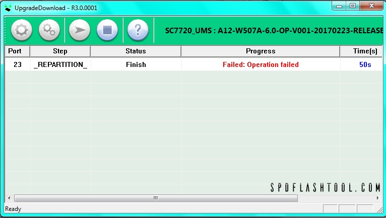

I am flashing Itel A12 with spreadtrum upgrade tool using project A12-W507A-6.0-OP-V001-20170223-RELEASE. When the stage:  "_REPARTTITION_" is reached the error: "Failed: Operation Failed" comes up. Can you help me troubleshoot this problem please. I cannot find answers on google, and searching on this forum does not show a related problem with a solution. Thanks in advance.

(14-03-2018, 08:38 AM)tmzota I am flashing Itel A12 with spreadtrum upgrade tool using project A12-W507A-6.0-OP-V001-20170223-RELEASE. When the stage:  "_REPARTTITION_" is reached the error: "Failed: Operation Failed" comes up. Can you help me troubleshoot this problem please. I cannot find answers on google, and searching on this forum does not show a related problem with a solution. Thanks in advance.
As far as I can tell, this seems to be an emmc chip issue. Its appears to be a common problem with the Itel A12. How many different firmware and flashing tools have you tried?
I have tried only the above firmware but I have tried two versions of spreadtrum upgrade download tool (3 and 4).
As for me i have tried 3 different version of the firmware and it still bring the same error. I tried more than for different flashing tools but still yet has thesame outcome

(14-03-2018, 10:24 AM)tmzota I have tried only the above firmware but I have tried two versions of spreadtrum upgrade download tool (3 and 4).
you can try the other A12 firmwares listed @ https://www.hovatek.com/forum/thread-20224.html if it still persist, then its likely to be an emmc chip issue as @hovatek initially indicated
