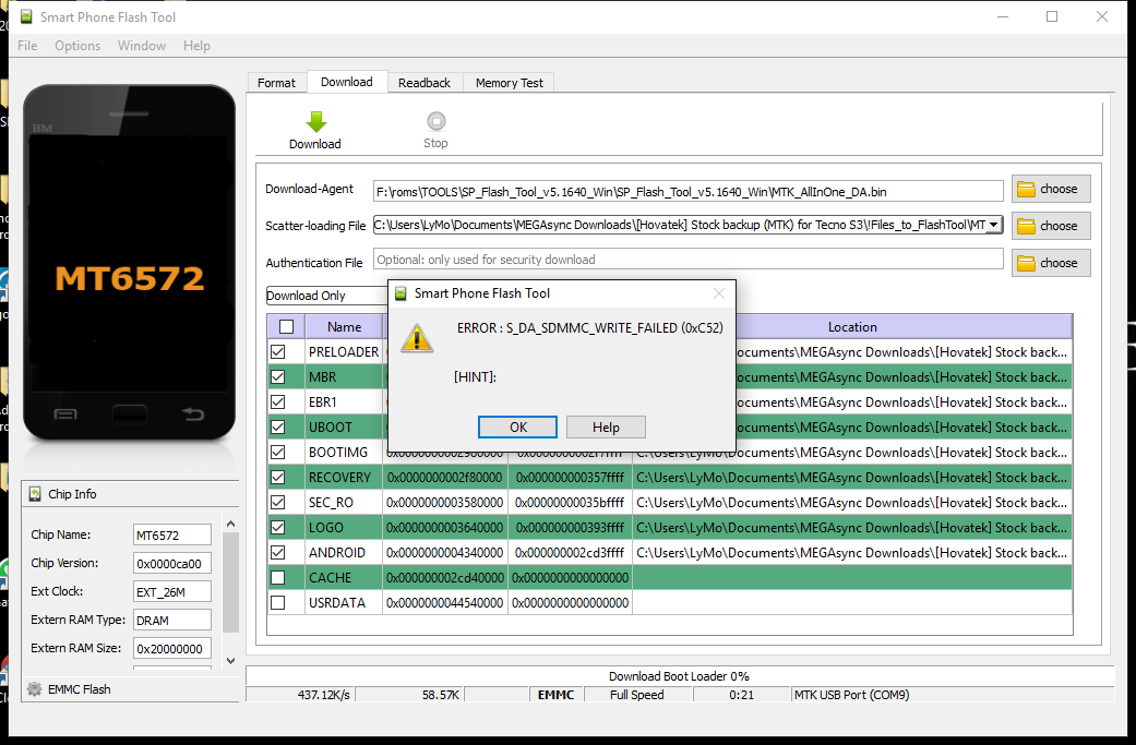

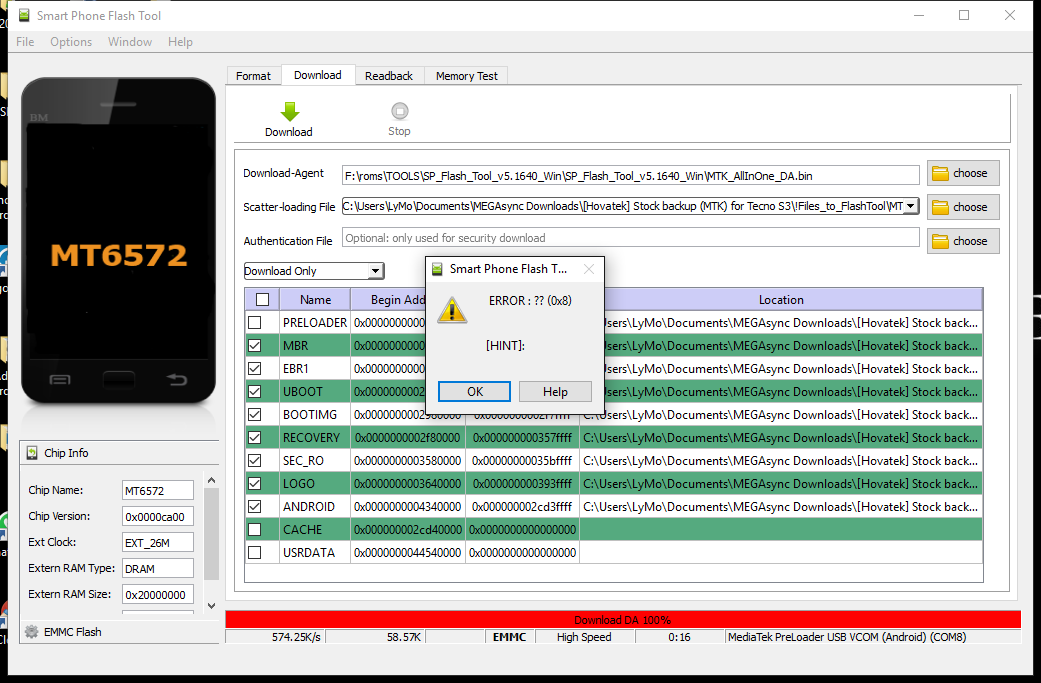

Anyway now i can no longer flash this Phone
I get error
S_DA_SDMMC_WRITE_FAILED (3153!)
I ALREADY TRIED ALL FIX LIST ON OTHER THREAD NO SOLUTION
23-02-2018, 05:10 PM
(23-02-2018, 10:52 AM)lymo ...
I get error
lets see a full screenshot of SPft along with the error message
BTW did you take note of the S3 build number that was previously running on the phone?
and which exact ROM are you trying to flash that gives this SPft error?

25-02-2018, 12:37 AM
(23-02-2018, 05:10 PM)X3non
I get error
The firmware was the same as firmware i downloaded here

25-02-2018, 12:49 AM
screenshots
