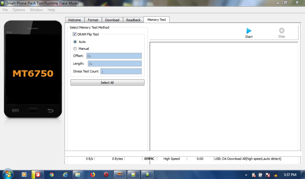

My SP FLASH TOOL v5.1744 is different from these pictures in this post
How do I select on the RAM Test?  Huh
I almost bricked my device using DRAM Test flip + Auto  Sad
[Image: 2018_03_10_15_37_41_Greenshot.jpg]
This post was last modified: 20-06-2018, 05:38 PM by ryfoz.
50,989
20-06-2018, 07:17 PM
(20-06-2018, 05:32 PM)ryfoz My SP FLASH TOOL v5.1744 is different from these pictures in this post
ram test has nothing to do with spft version, instead it depends on the scatter file you select [some chipset don't support it]

(20-06-2018, 07:17 PM)X3non ram test has nothing to do with spft version, instead it depends on the scatter file you select [some chipset don't support it]
i'm not sure how you got to this page but if you got here through the guide at https://www.hovatek.com/forum/thread-21970.html then step 17 indicated an alt method to try if you dont see "RAM TEST"
Thanks for pointing out my mistake...I overlooked the link in error.
But my Chipset is 6750T do I have to create (add) my chipset manually in the WWR or I can go with MT6750 which was what I used before
As for the RAM. test, I will try out the EMMC_USER instead of BOOT 1 as you have guided me to do (or is there any step I have omitted in the post?)

You can use MT6750
The goal of the RAM test is to get the length value of the full rom
For those that use DRAM flip test like yours, you get the length of the rom using https://www.hovatek.com/forum/thread-22701.html
