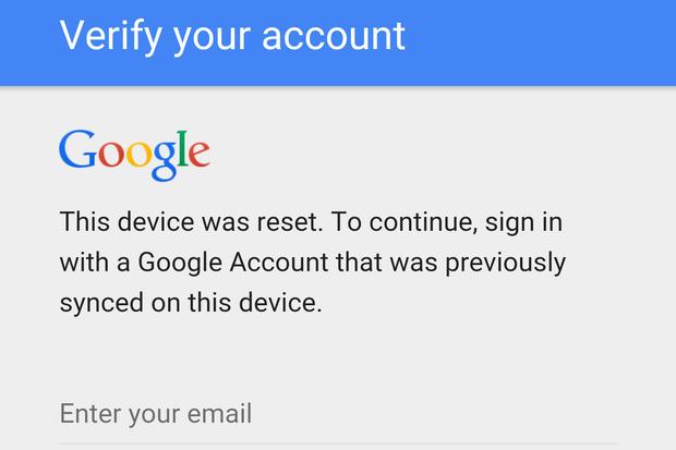

Factory Reset Protection (FRP) is a security feature. If you do a factory reset on a Spreadtrum Android phone which has already been associated with a Google account (Under Settings > Accounts) then you'll be greeted with a Verify Your Account screen (like below) when you boot:
[Image: howto-bypass-factory-reset-protection-on...-phone.jpg]
This is FRP and is controlled by the /persist partition in Spreadtrum (its /frp in Mediatek)

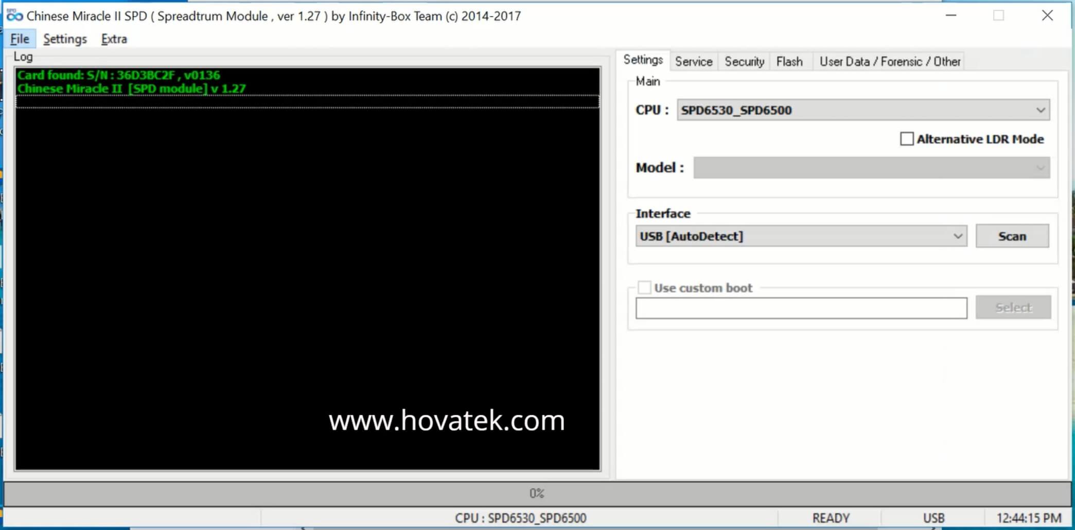

  2. Select your phone's chipset under Settings > CPU
    [Image: How-to-bypass-Factory-Reset-Protection-F...-CM2-2.jpg]

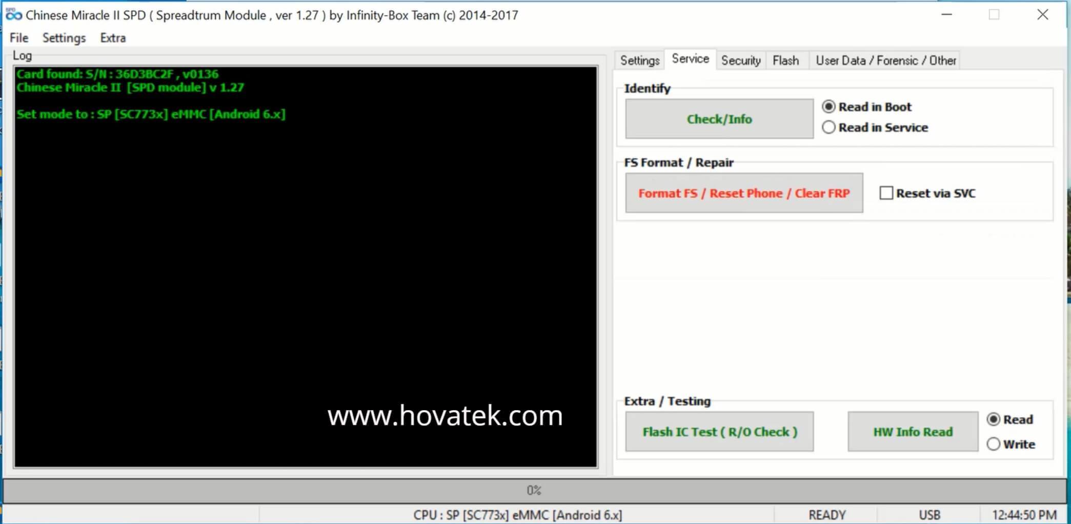

  4. Click Format FS / Reset phone / Clear FRP
    [Image: How-to-bypass-Factory-Reset-Protection-F...-CM2-4.jpg]

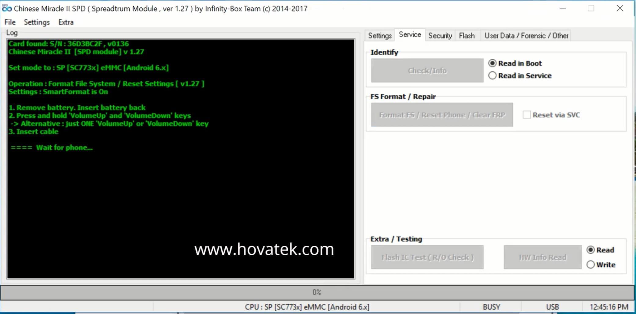

  5. Once you see ==== wait for phone.... , power off the phone (still with battery in), hold the Volume down button then connect to PC via a USB cord
    [Image: How-to-bypass-Factory-Reset-Protection-F...-CM2-5.jpg]

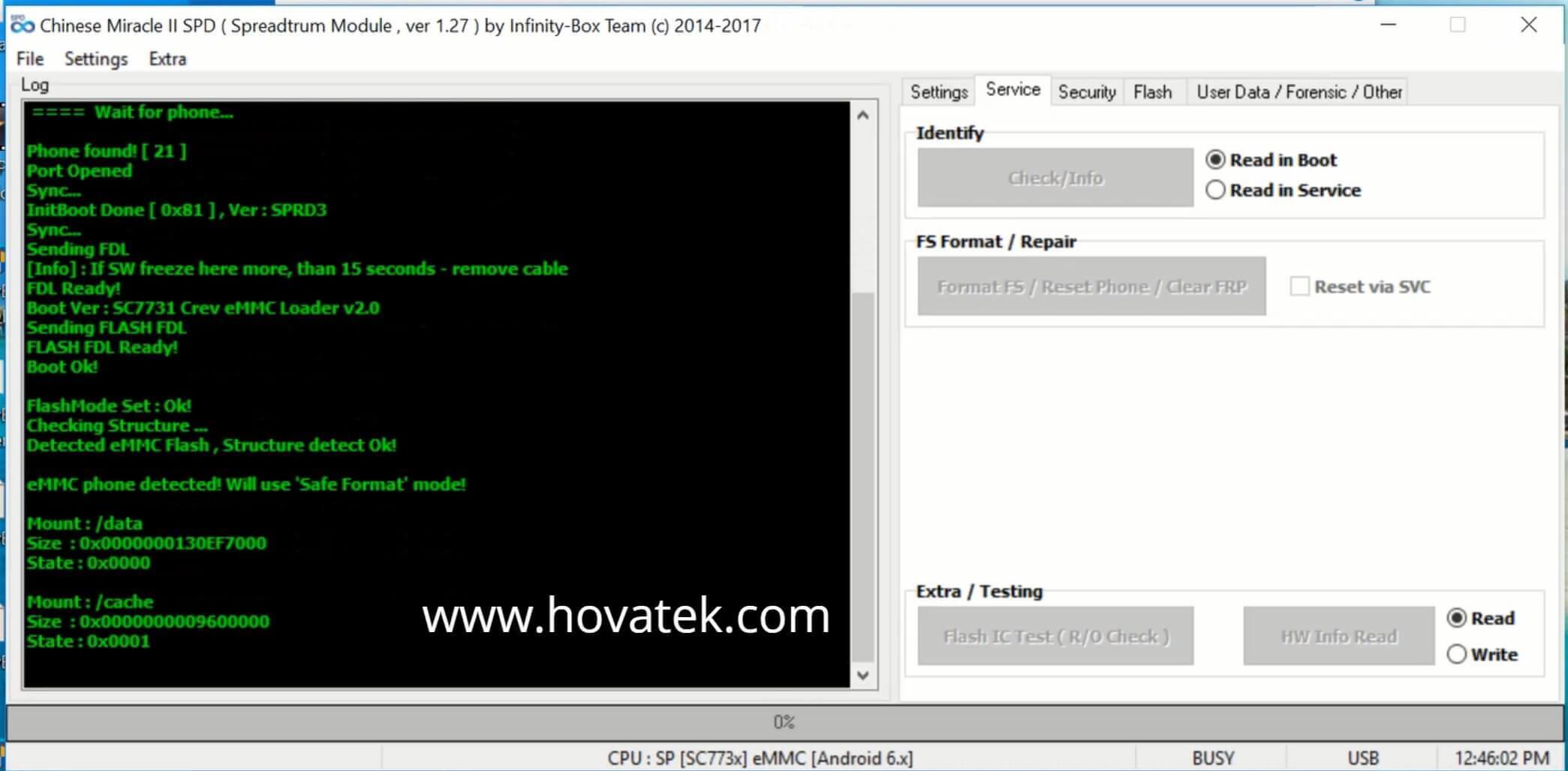

  6. The phone should get detected
    [Image: How-to-bypass-Factory-Reset-Protection-F...-CM2-6.jpg]
  7. Wait while the FRP partition is wiped, you can now release the Volume down button
    [Image: How-to-bypass-Factory-Reset-Protection-F...-CM2-7.jpg]
    You should get a Done message once complete, disconnect then boot up the phone (first boot often takes a while)
