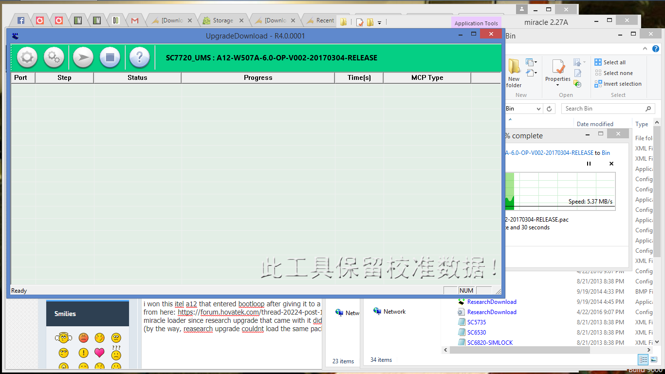

i own this itel a12 that entered bootloop after giving it to a 3year old. so, i have ben trying to flash it. i download flash spd from this forums itel a12 support flash file (the first on the list) and wanna use miracle loader since research upgrade

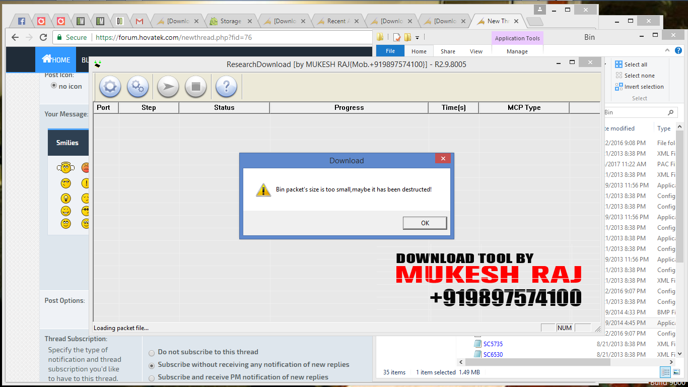

that packed with it didnt do nothing after upgrade tool automatically loaded the packet (by the way, reasearch download couldnt solve the issue look below)

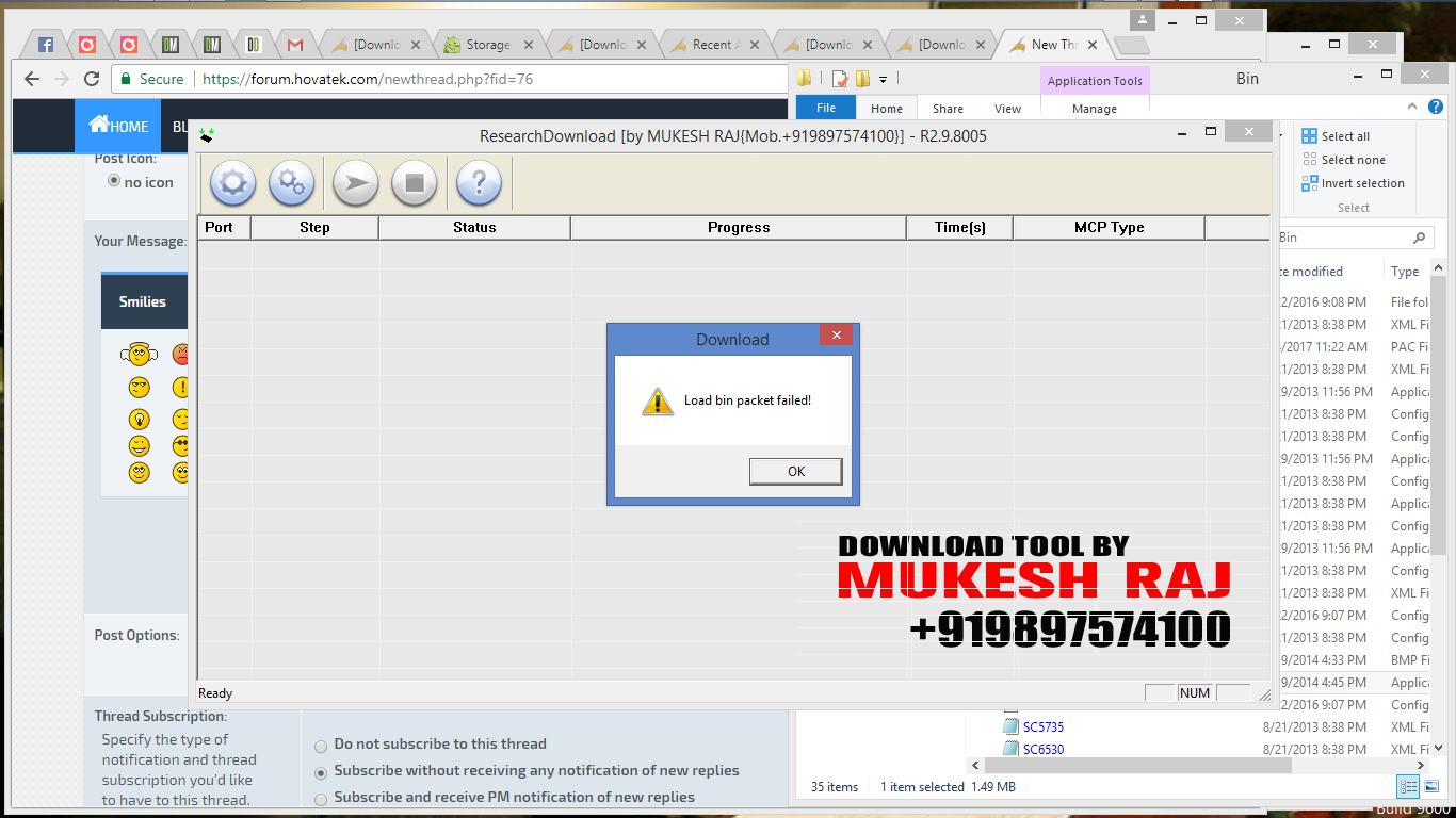

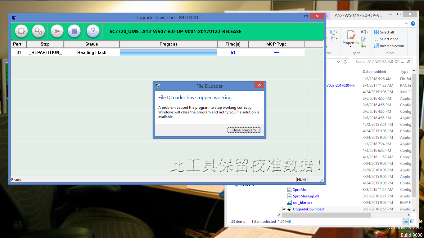

20-01-2018, 10:57 AM
yes i have
it says bootload error using miracle box and using upgrade tool, it says file dloader stopped working at some point not far from when it starts flashing.
Would be glaf if you help fix

20-01-2018, 05:52 PM
(20-01-2018, 10:57 AM)whizyrel yes i have
thanks
as @hovatek already indicated, that version of miracle box will not work on your device [leave that one aside for now]
lets see a full screenshot of this file dloader error message you get in upgrade download tool

21-01-2018, 03:46 AM
(20-01-2018, 05:52 PM)X3non
thanks
here:
22-01-2018, 08:11 AM
(21-01-2018, 03:46 AM)whizyrel here:
Try other Itel A12 builds at https://www.needrom.com/download/itel-a12/
