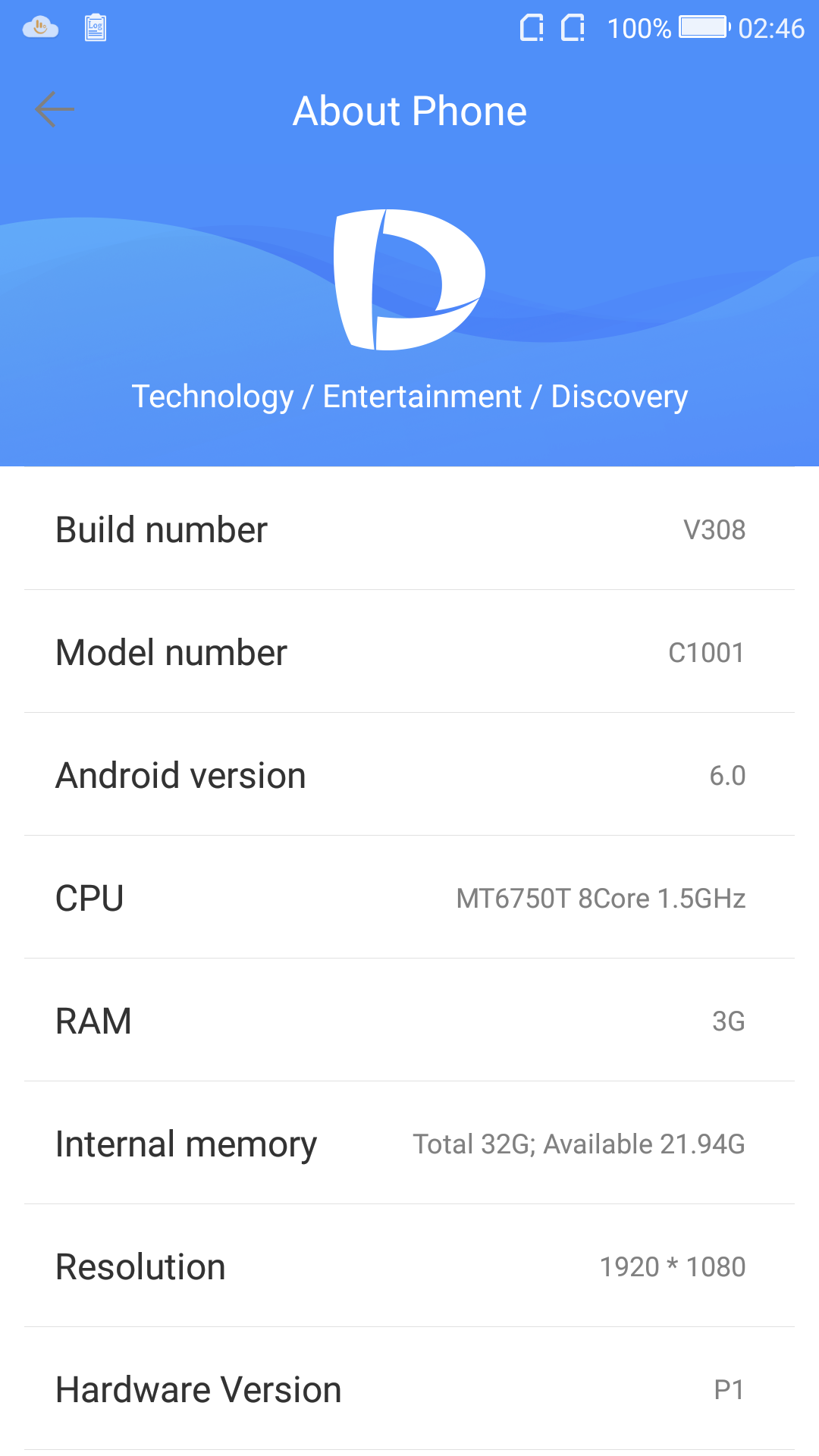

Specs below
SuperD D1
OS 6.0
MT6750T
Octacore 1.5 Ghz (64-bit)
3GB/32GB

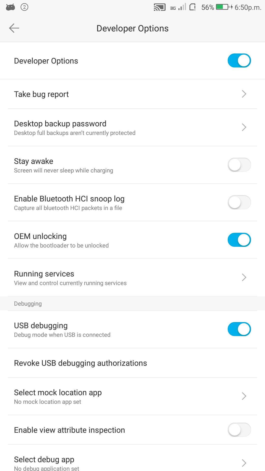

My device is not showing in fastboot mode, pls help. oem is unlocked in Developer options as well as USB Debugging
When I type adb devices, it displays my device but when in fastboot mode it doesn't show my deviceve after typing "fastboot devices" without quote "..."
